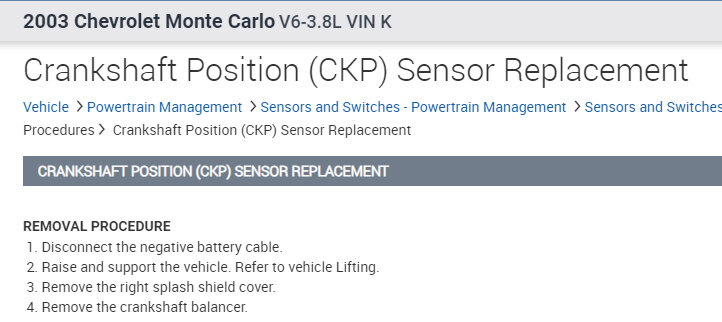

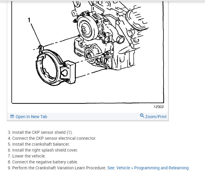

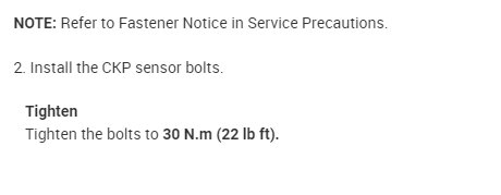

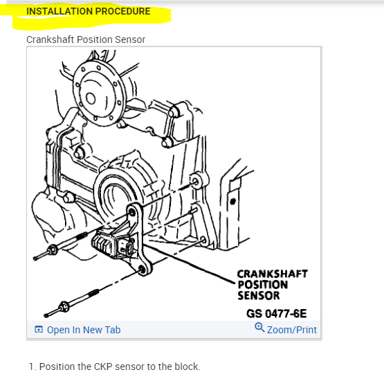

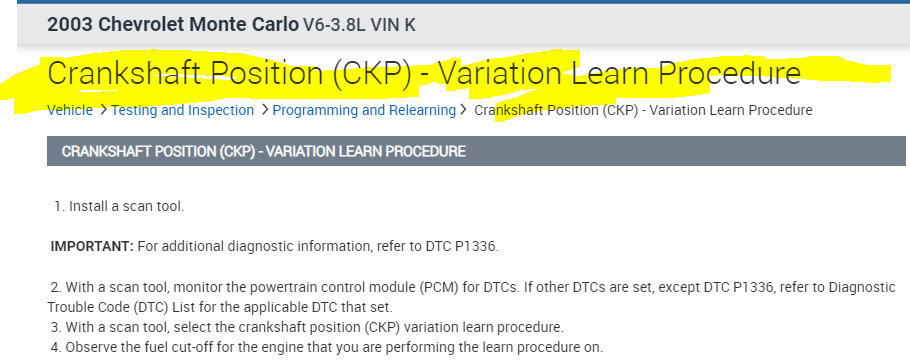

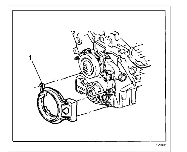

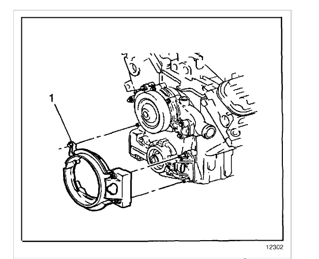

A faulty crankshaft position sensor will cause no spark. Have you replaced it yet? Also, has the vehicle run since the battery terminals were switched?

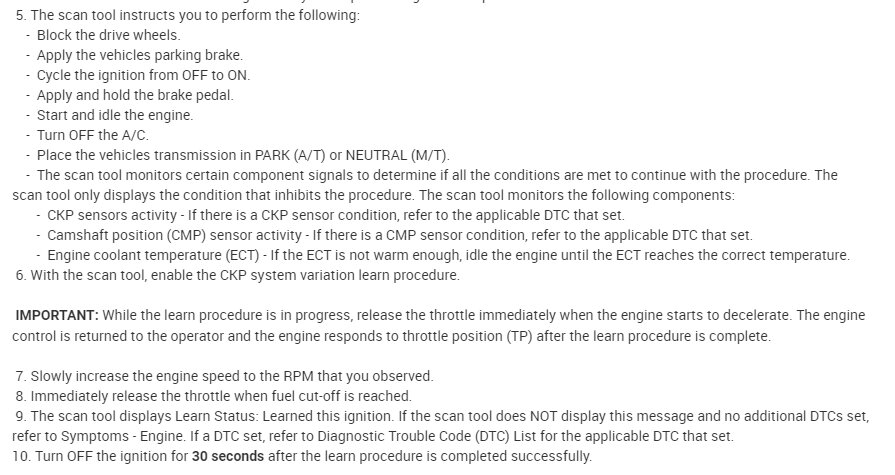

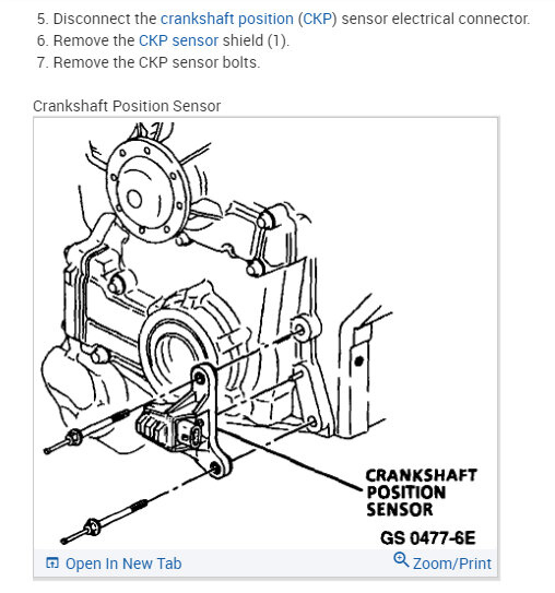

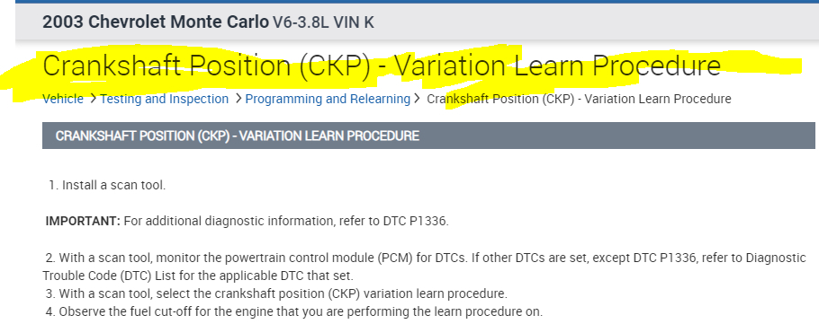

As far as the sensor, if you look below. I attached the directions specific to this vehicle for replacing it. Additionally, I attached the variation relearn related to the sensor.
joe
See pics below.
