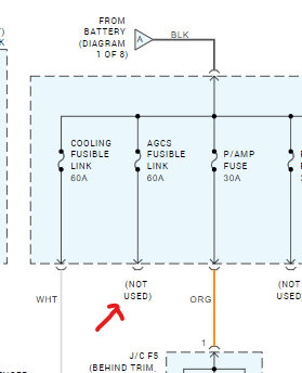

The ACG-S fuse is not used, see the image below. To confirm the engine has no spark lets go over this guide:

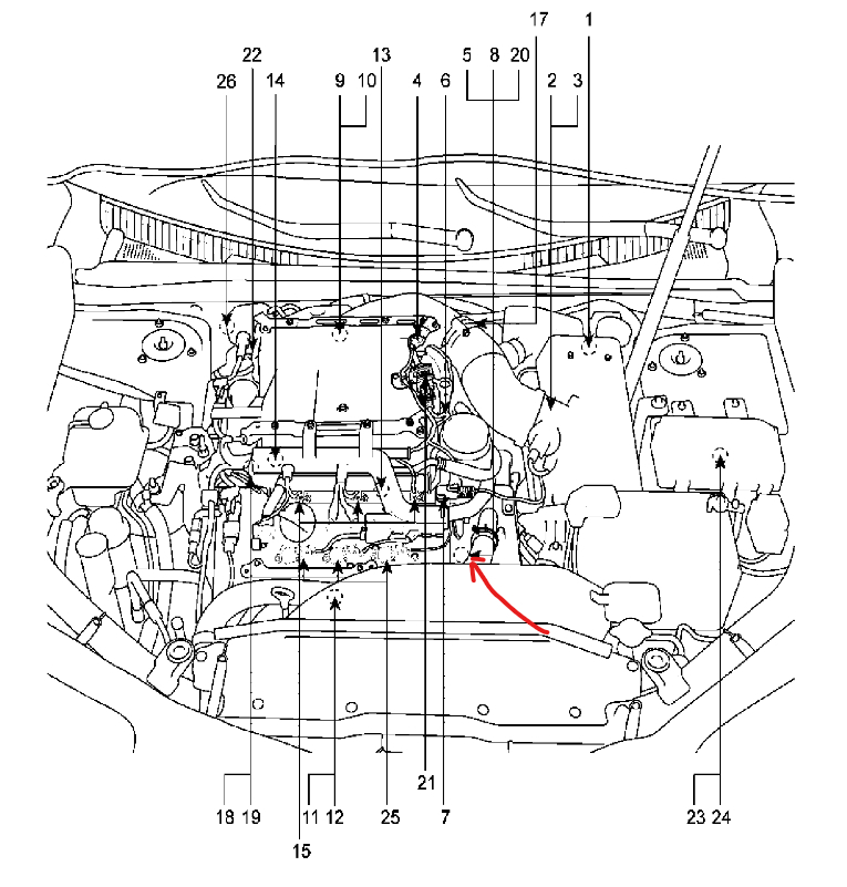

Also, if you can upload a short video of the engine cranking over, I can tell you if the timing chain is okay. Check out the images (below). Let us know how it goes.

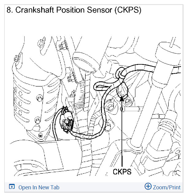

Okay please check the ignition spark because it sounds like the crankshaft angle sensor is not working. Here is the location of the sensor so you can check it out. Check out the images (below). Please let us know what happens.
