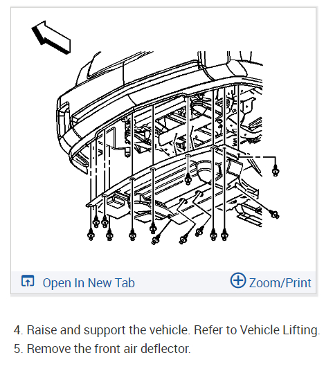

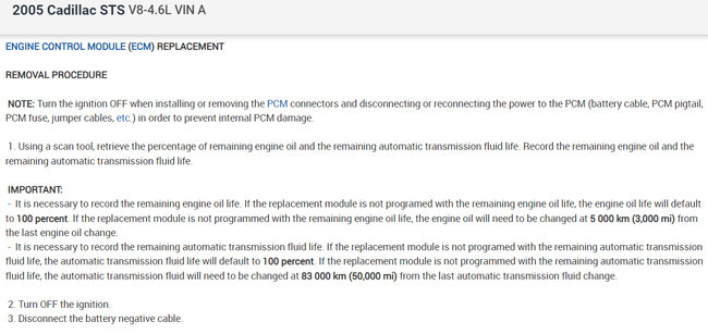

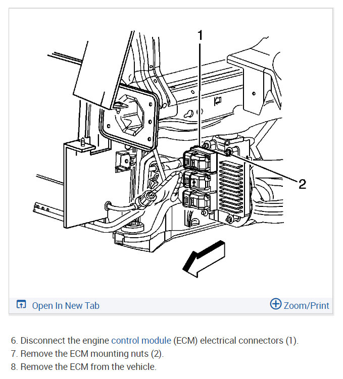

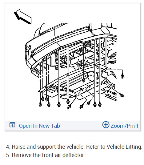

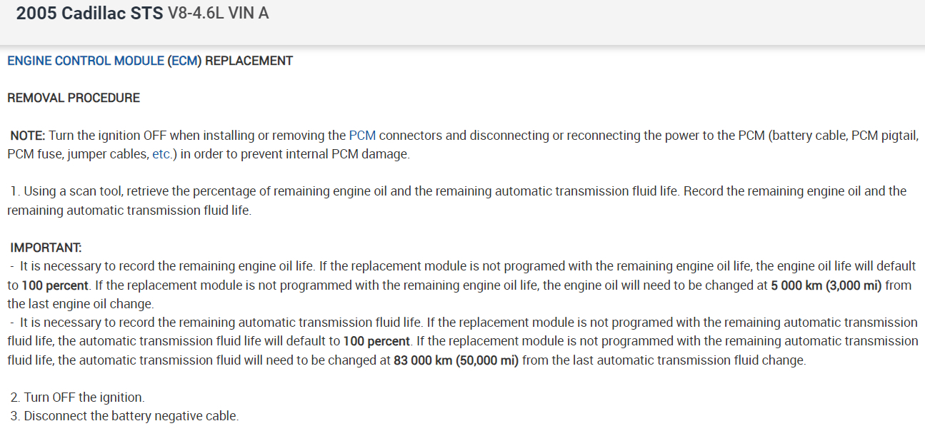

Has the wiring been tampered with? Also, you may have corrosion at the PCM electrical connectors so please check for that as well. If the fuses are okay (test with ignition on) I have left the location and instructions on how to change out the PCM, you can get a preprogrammed unit by searching Google or Ebay. Check out the images (below). Please upload pictures or videos in your response of any problems so we can see what to help you with.
