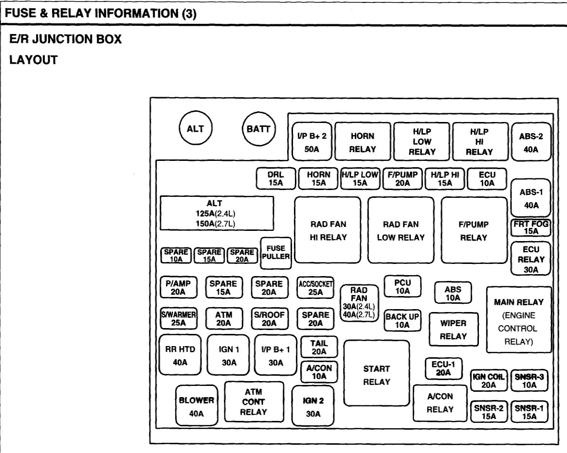

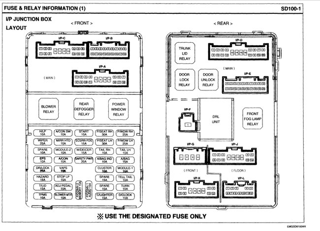

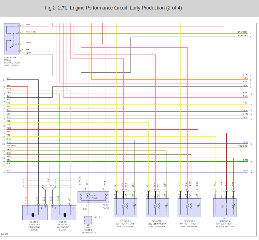

I went in the store came back out car would not start. Turns over but will not start. Radio and power windows will not work. No lights on dash come on and gauges do not move. I called out mechanic he said fuses are all good but it is not getting power to coil pack or spark plugs. Could not get any codes . What could be the problem?
Jul 25, 2017 at 2:57 PM

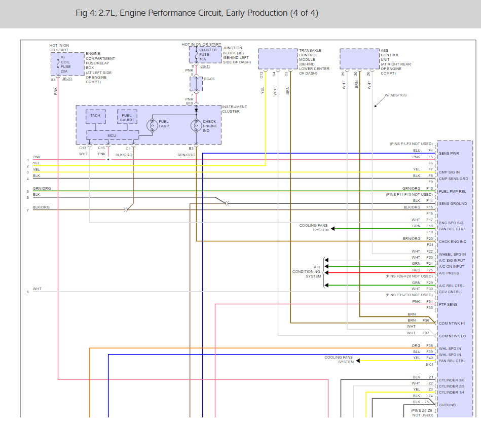

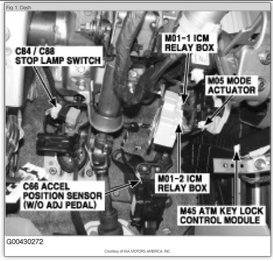

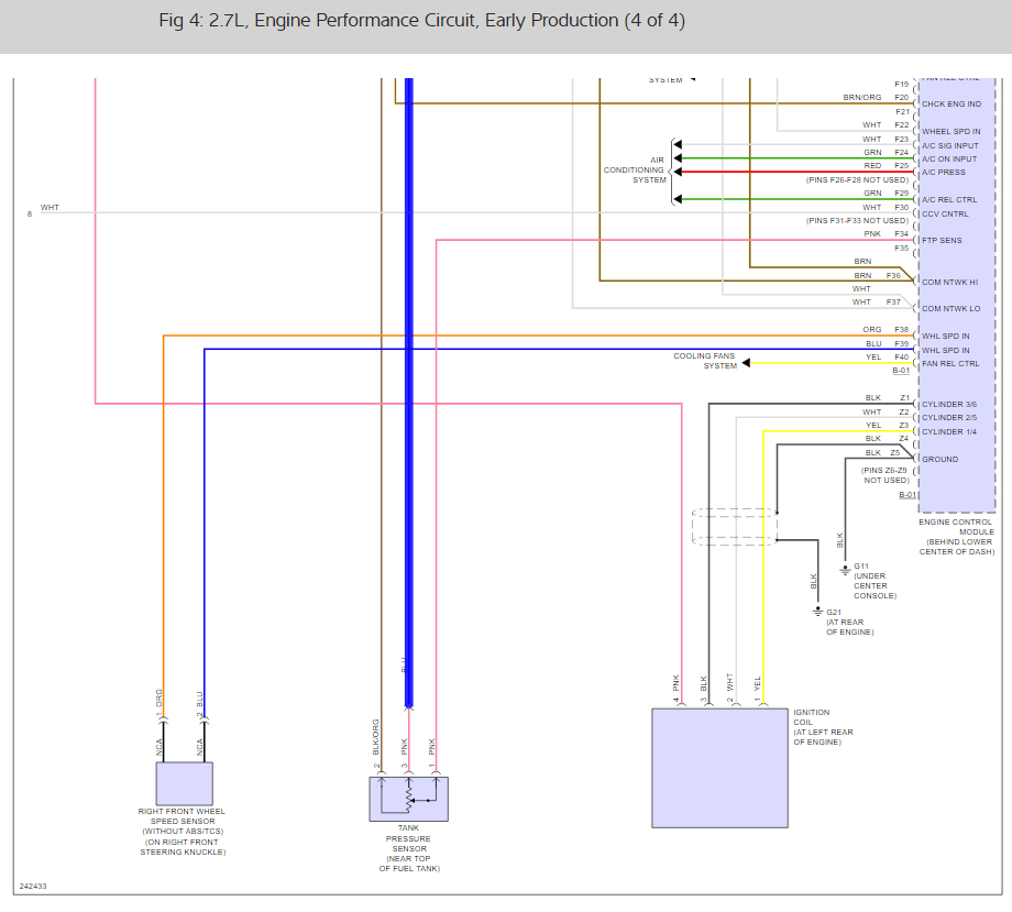

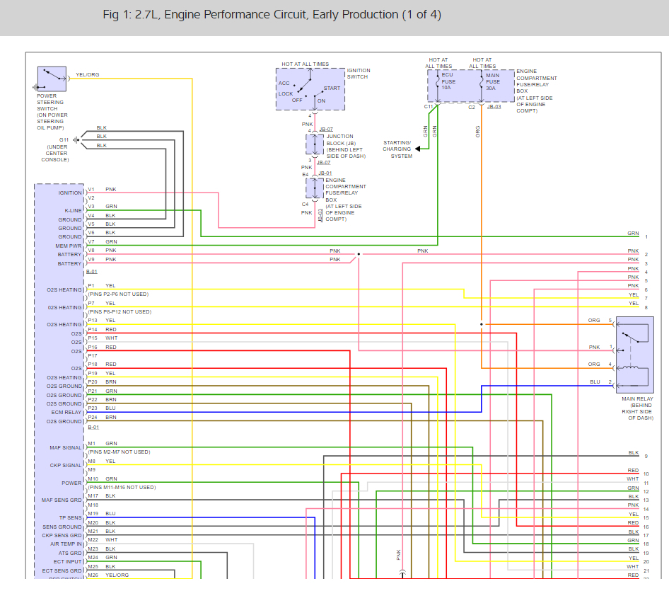

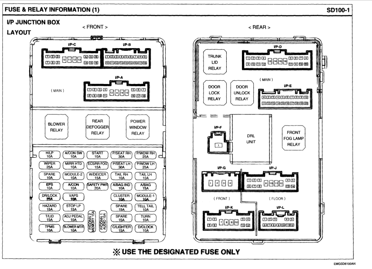

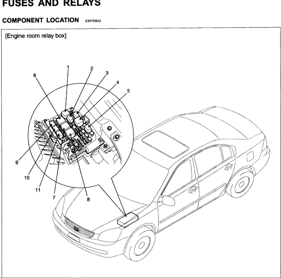

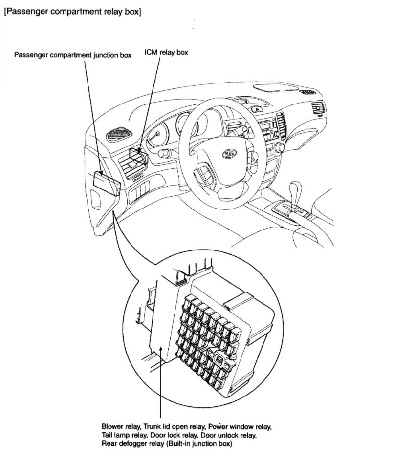

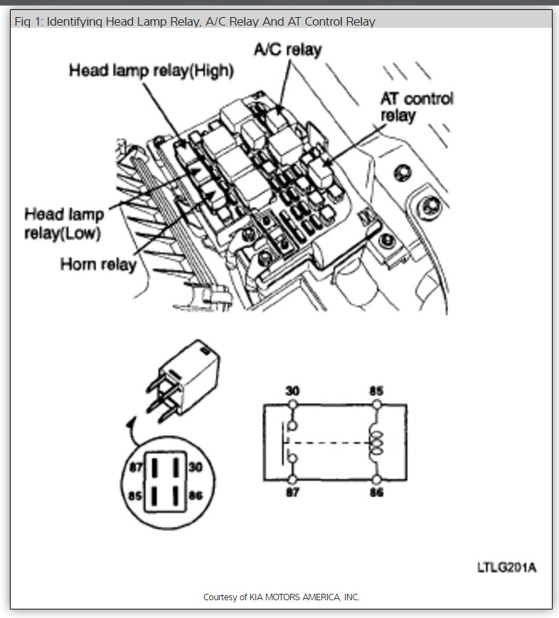

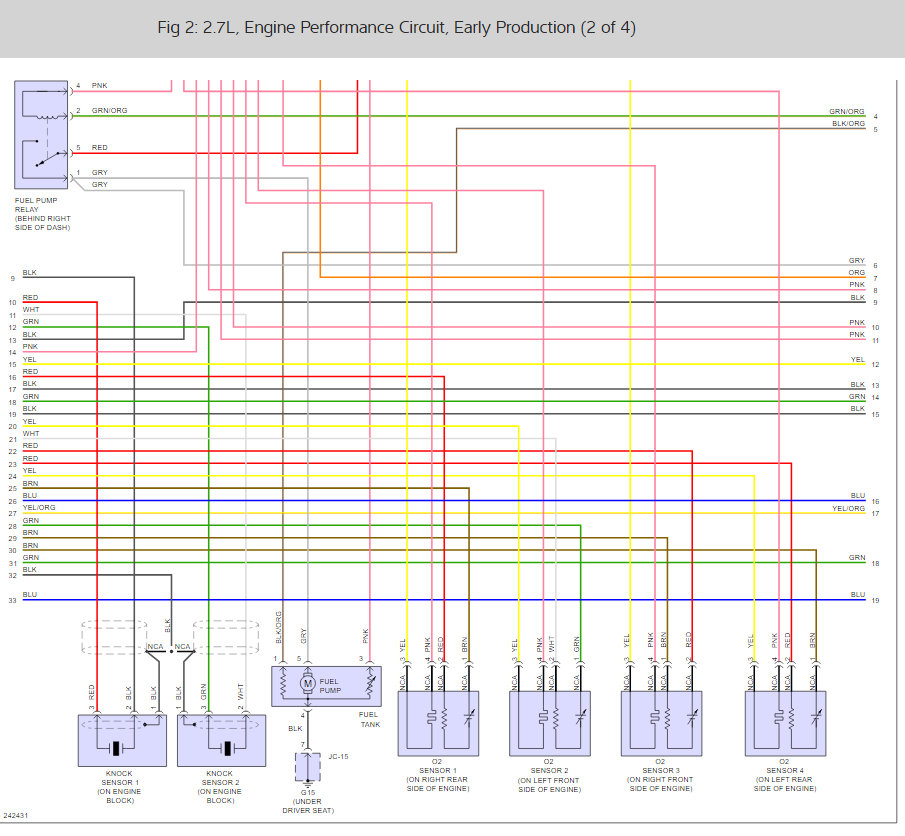

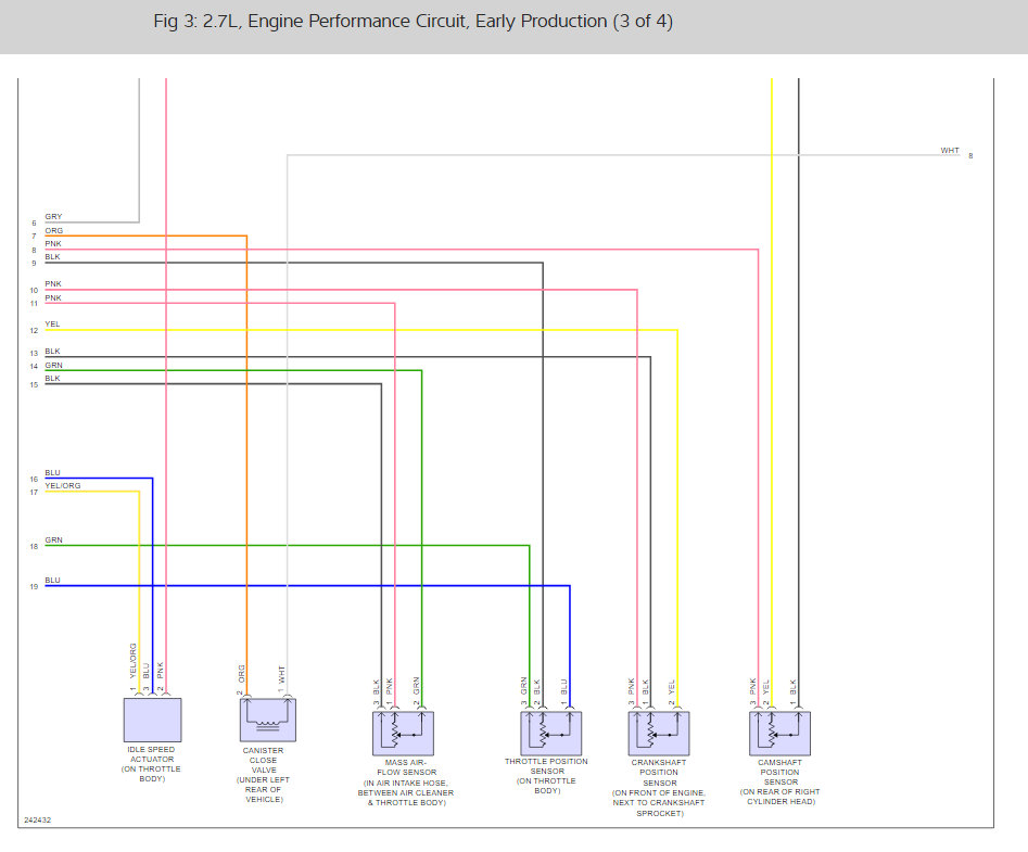

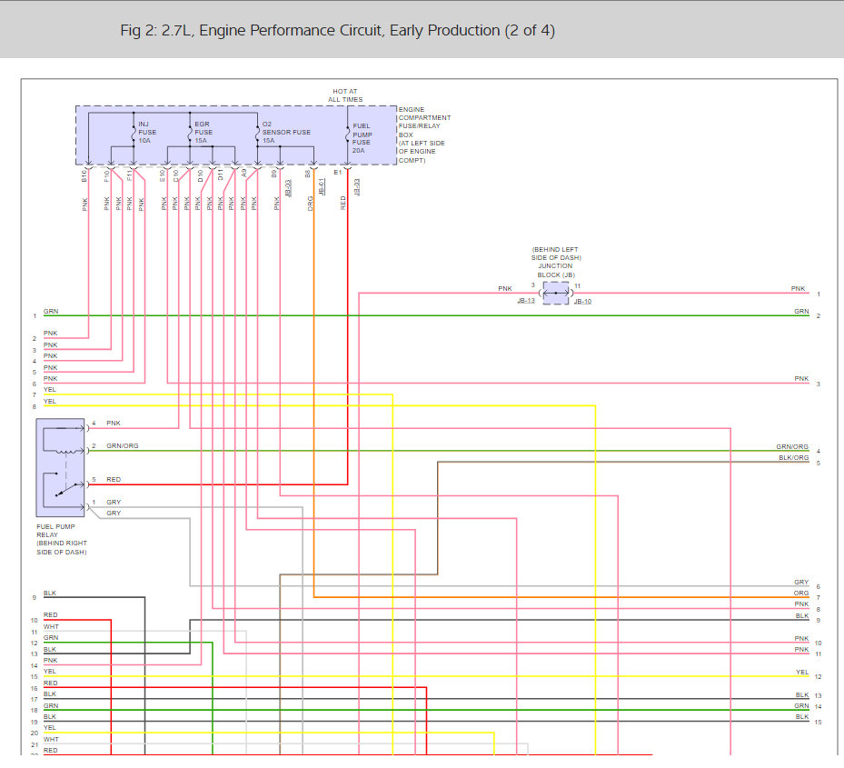

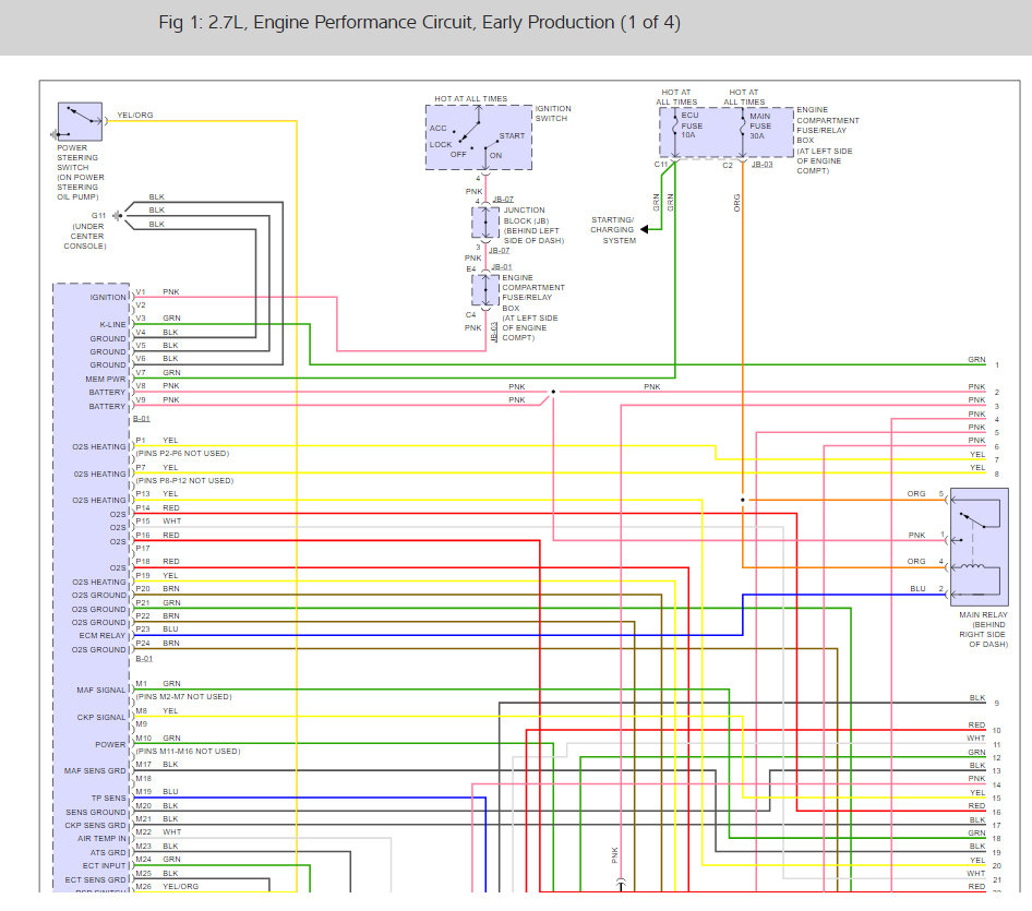

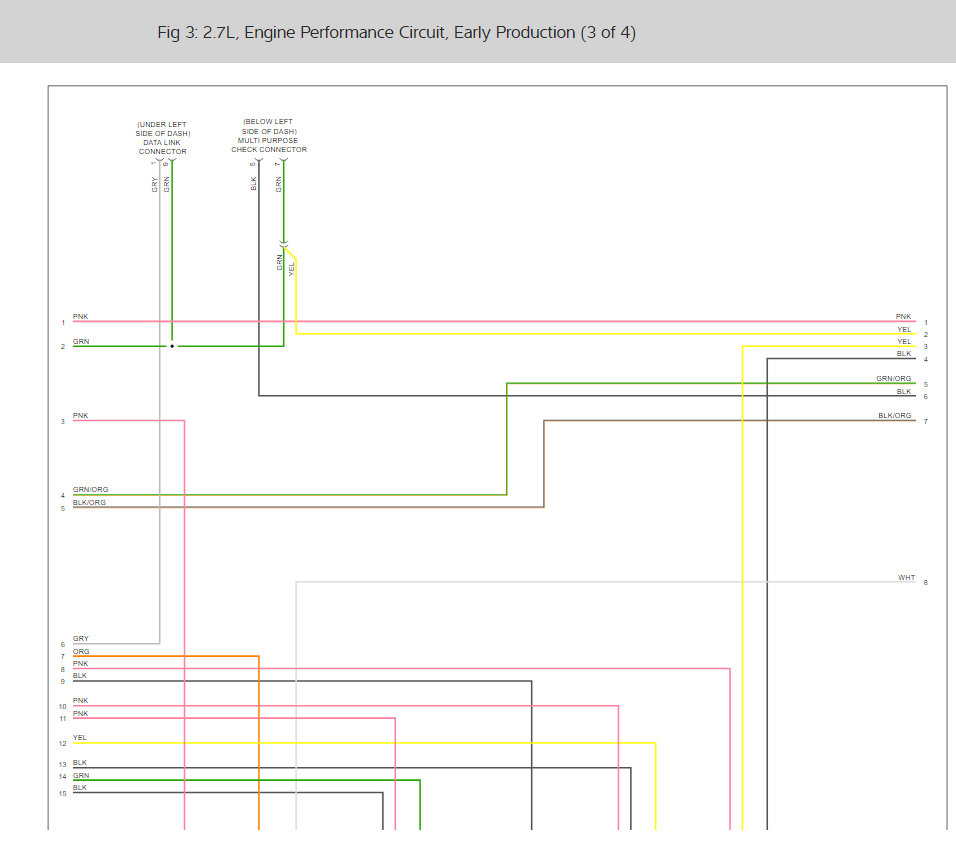

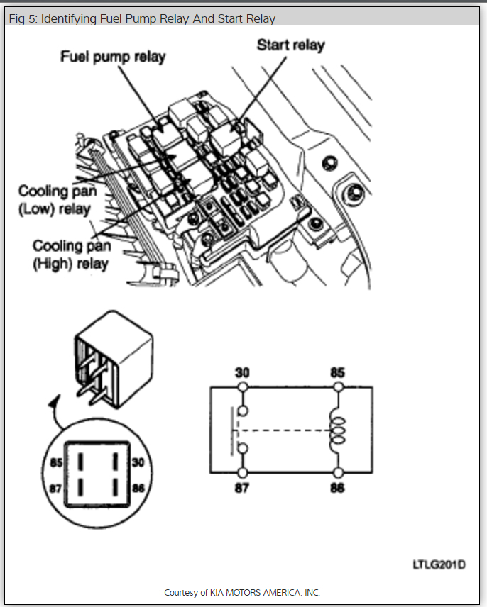

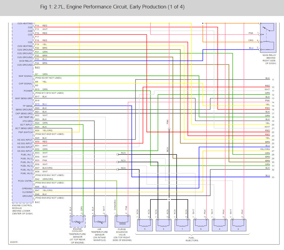

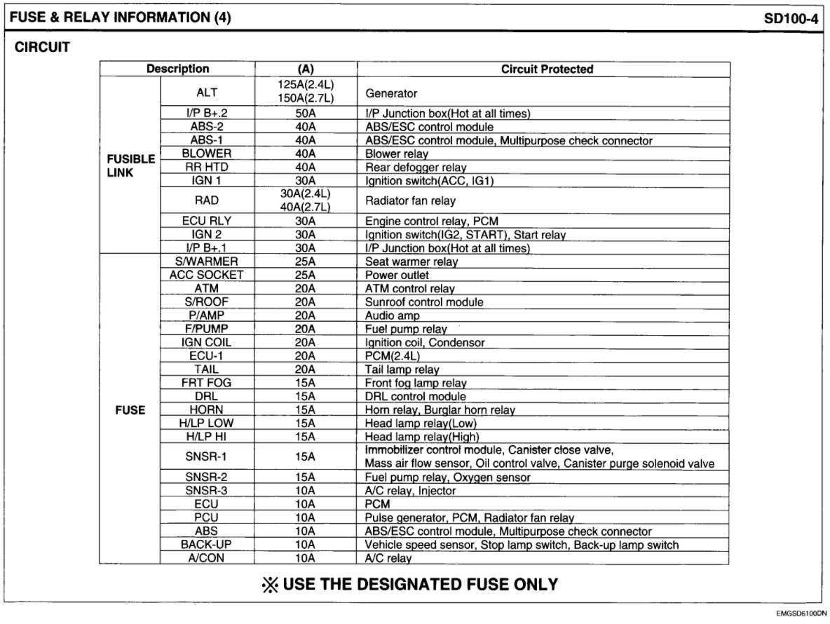

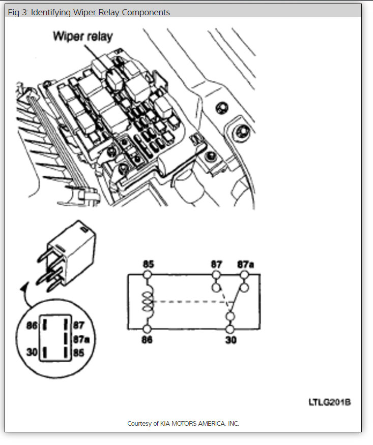

It sounds like you have a fuse or a relay that is not working. I see the MAIN relay that will power up the system so start there.
Here are some guides and diagrams (Below) that will help us get the problem fixed.
and
and
Please run some tests and get back to us we are interested to see what it is.
