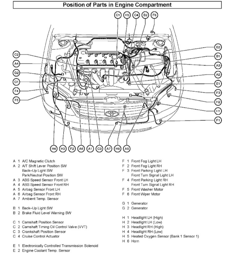

Most of the time it will be the crankshaft sensor which is common. to be sure here are are two guides to help us see what's going on:
and

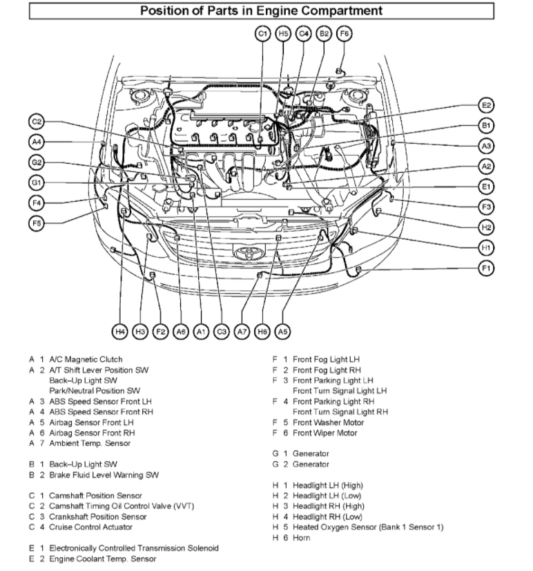

I have also included the crankshaft position sensor location so you can check it out. Check out the diagrams (below). Please let us know what you find. We are interested to see what it is.
Oct 15, 2020 at 10:27 AM

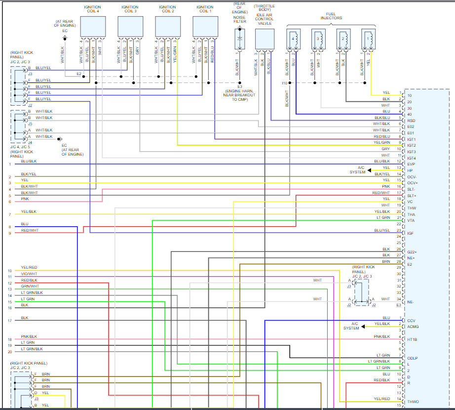

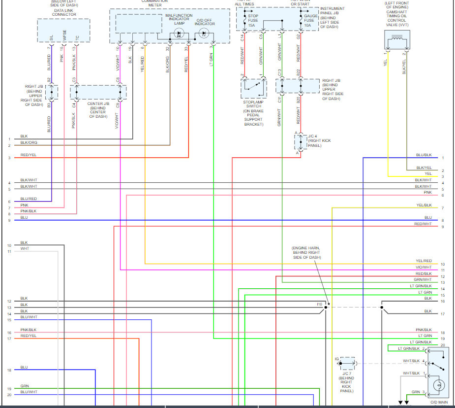

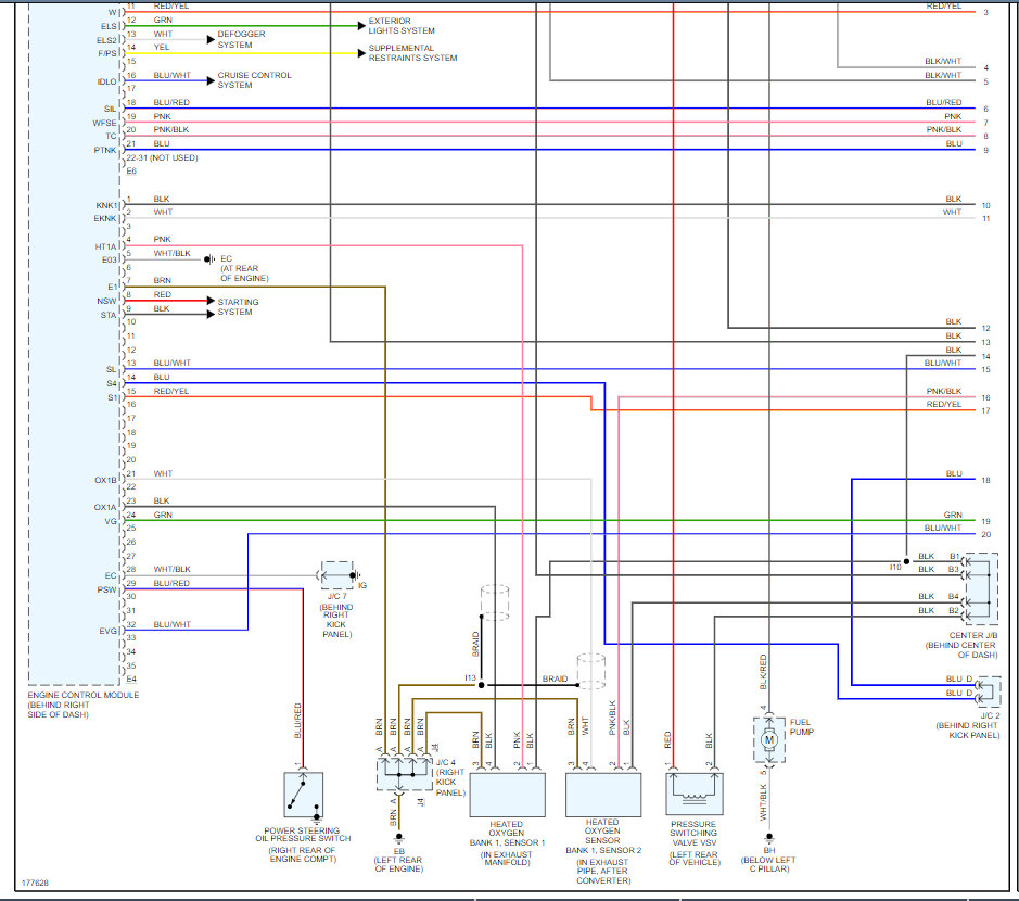

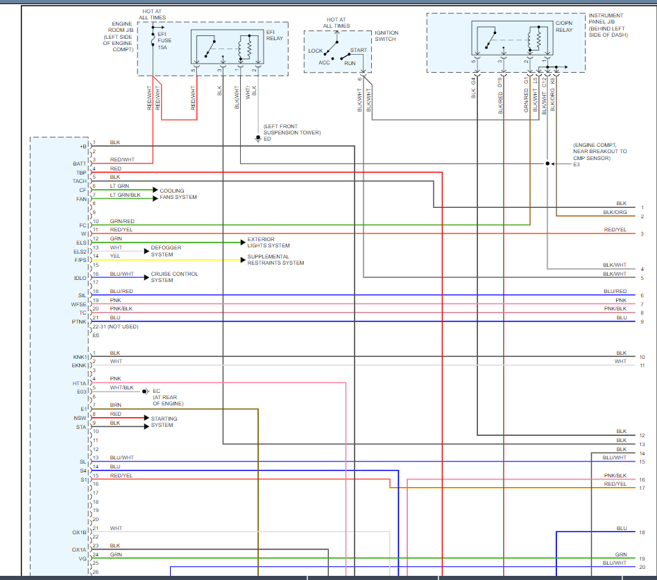

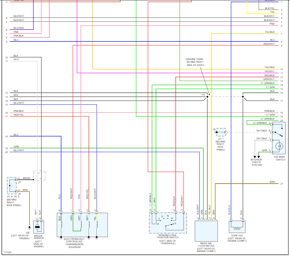

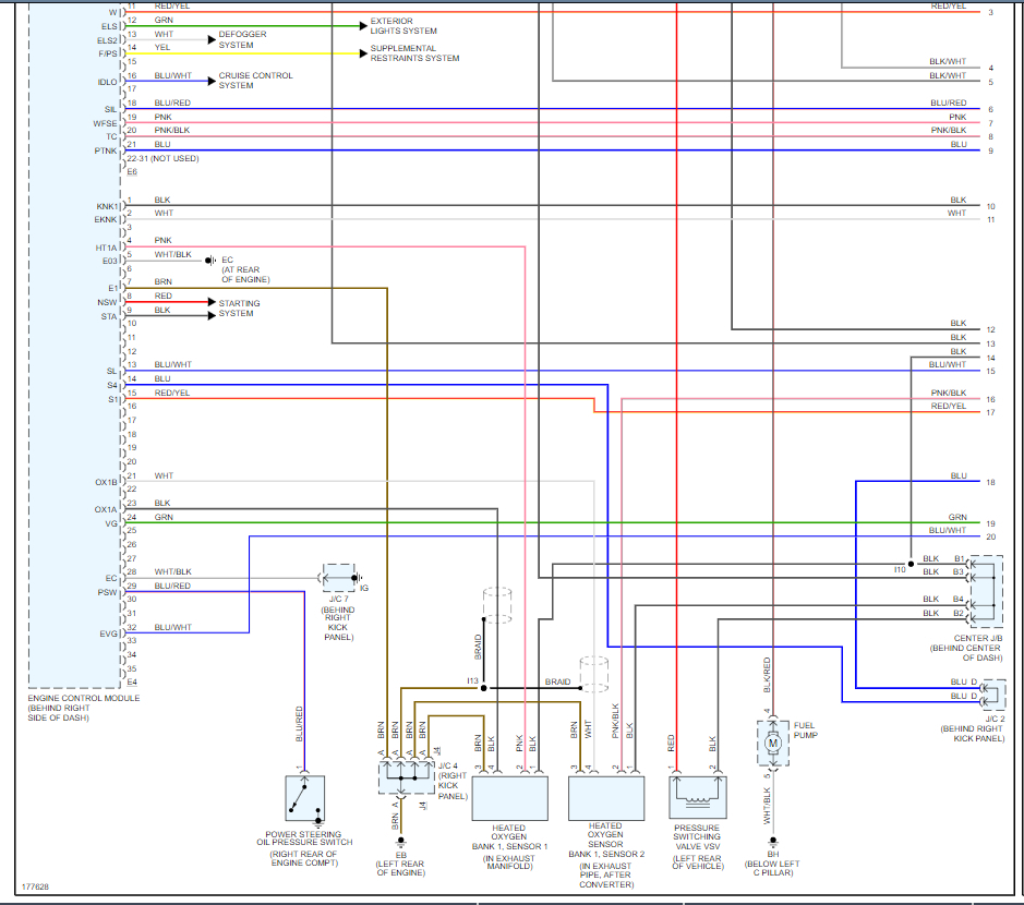

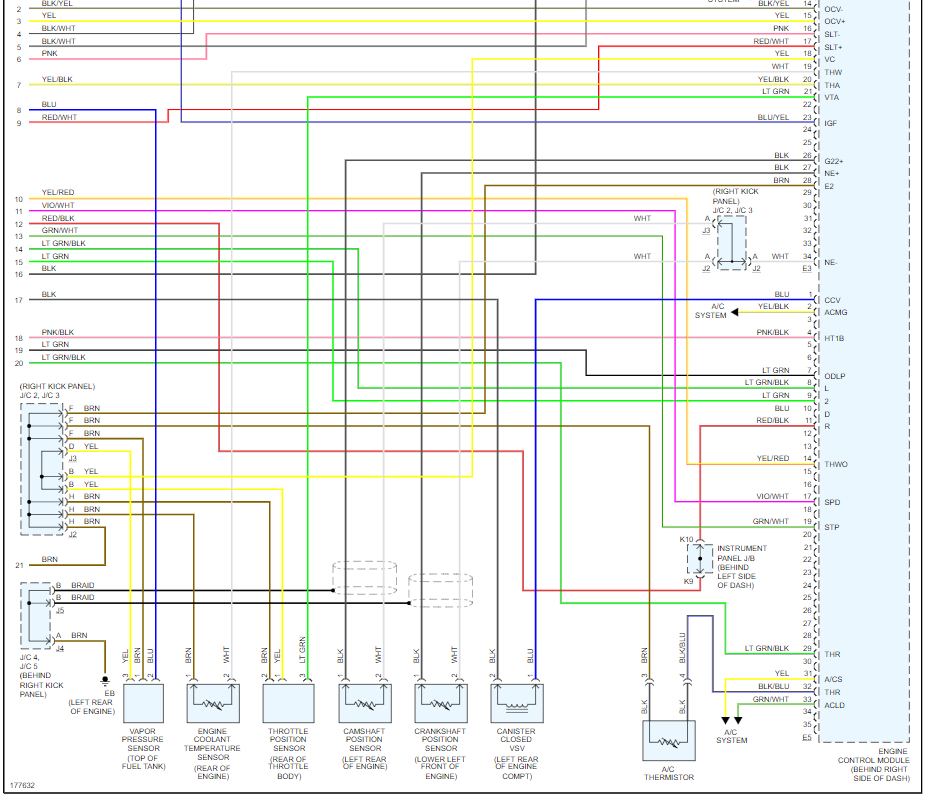

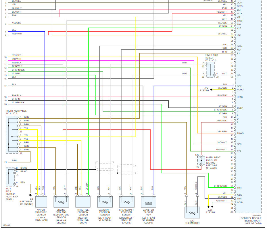

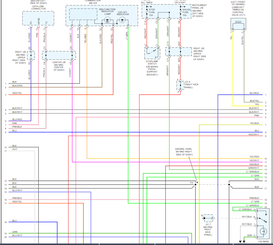

Here are the engine wiring diagrams with a guide to help check the connections.
Check out the diagrams (Below). Please let us know what happens.
Dec 6, 2020 at 5:18 AM
