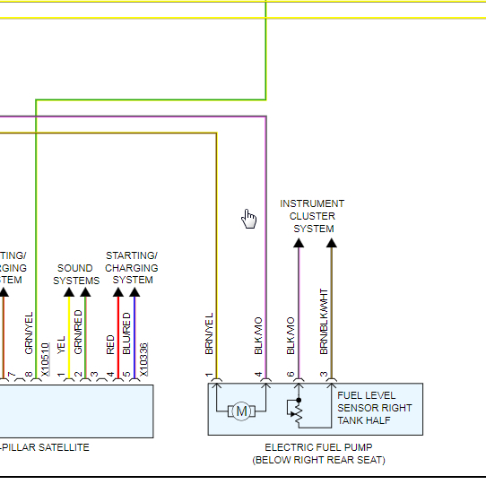

We need the check fuel pressure and then if there is no pressure then we need to check power at the pump. Here is a guide that will help with checking the pressure.
Then this is a guide that will help with checking the voltage at the pump.

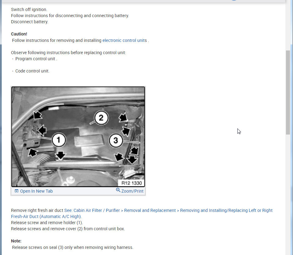

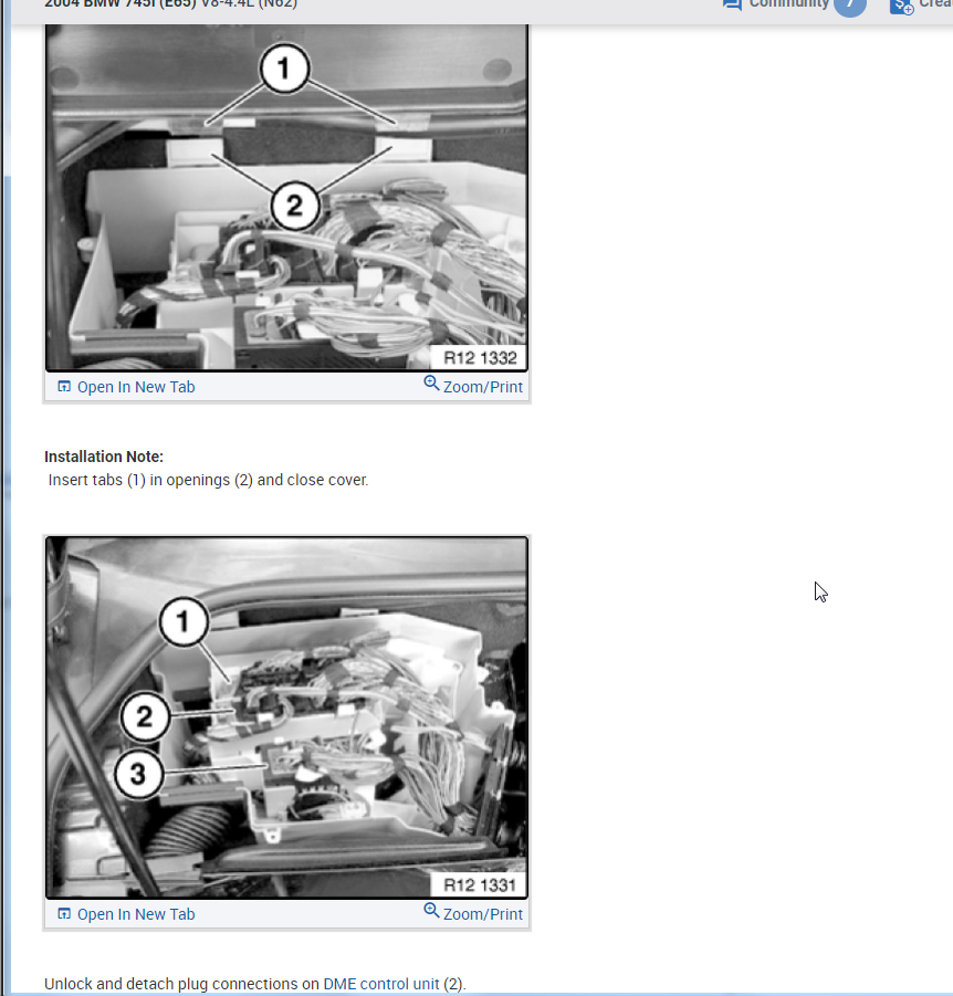

Lastly you will see the diagram below that will help with this test plus the process on how to replace the DME which is what I suspect the issues is. However, let's run through the testing first as we need a little more proof.
