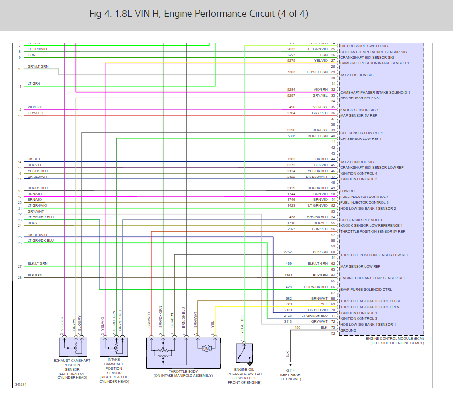

Checked fuel pressure and it is 72 lbs. checked for security light, nothing, no codes. i pulled the plug off the coil pack and no power from any of the wires with my test light. Could it be bad crank sensor/cam sensor?

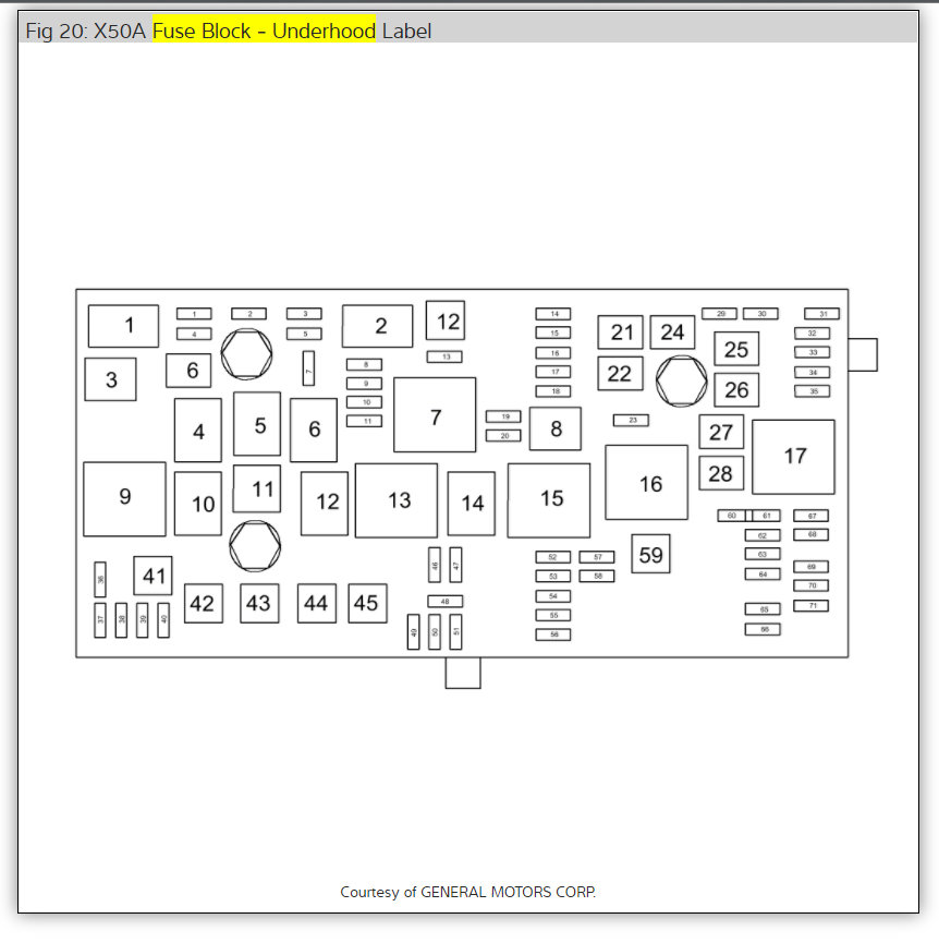

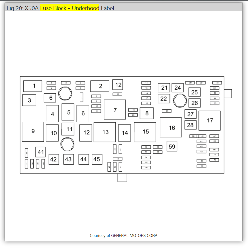

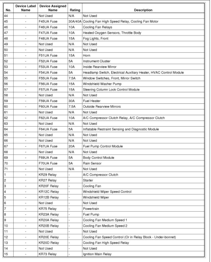

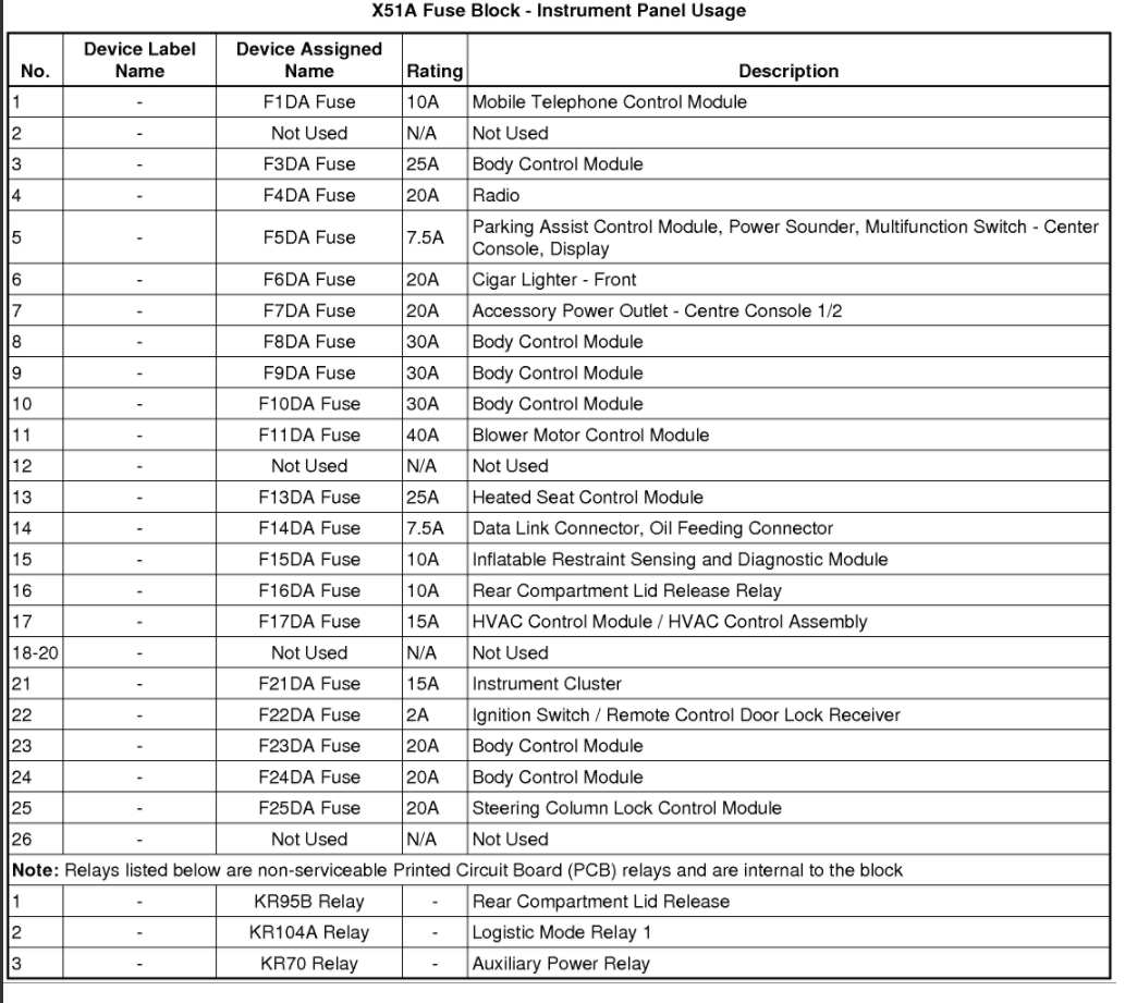

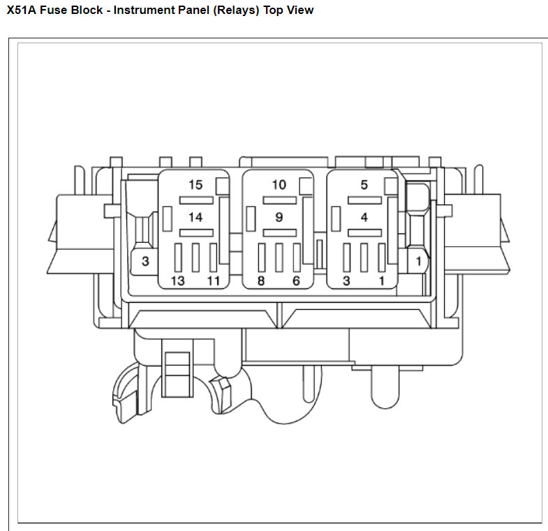

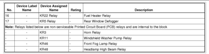

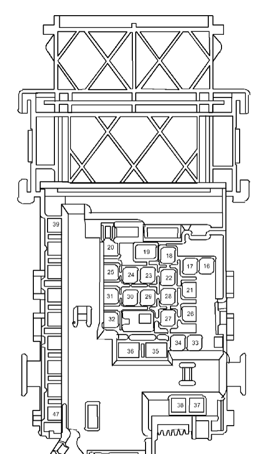

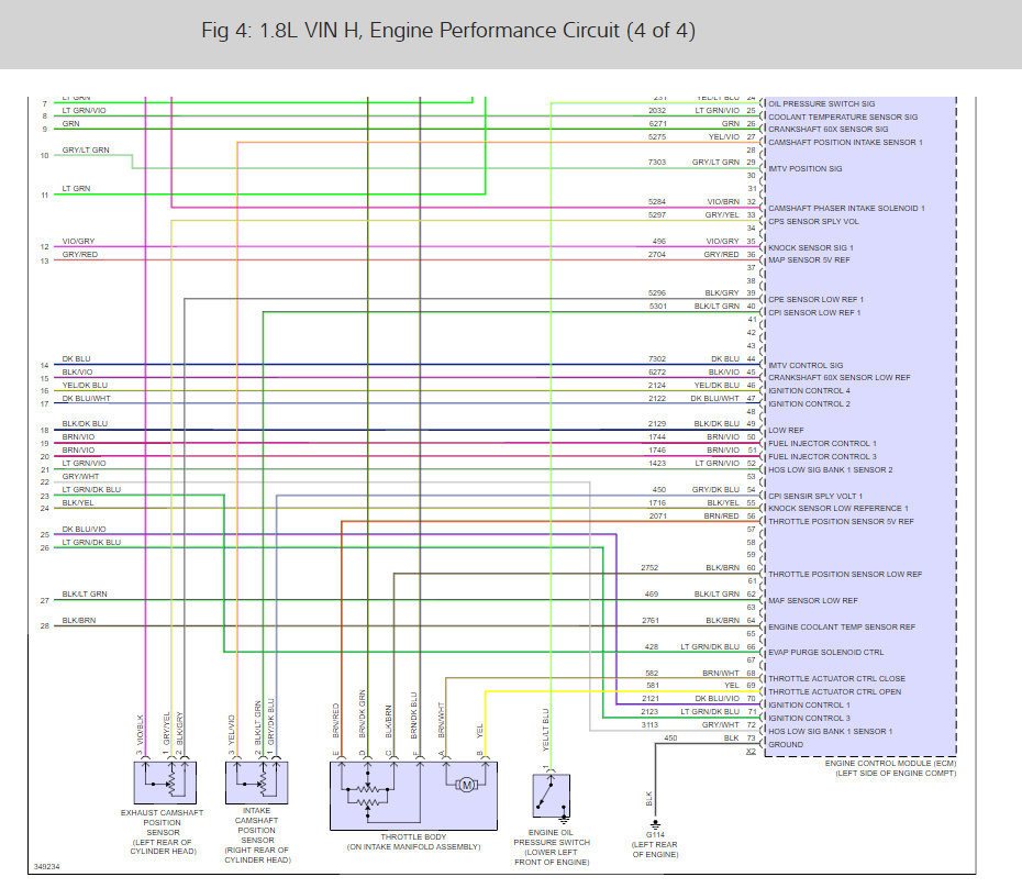

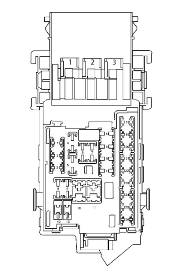

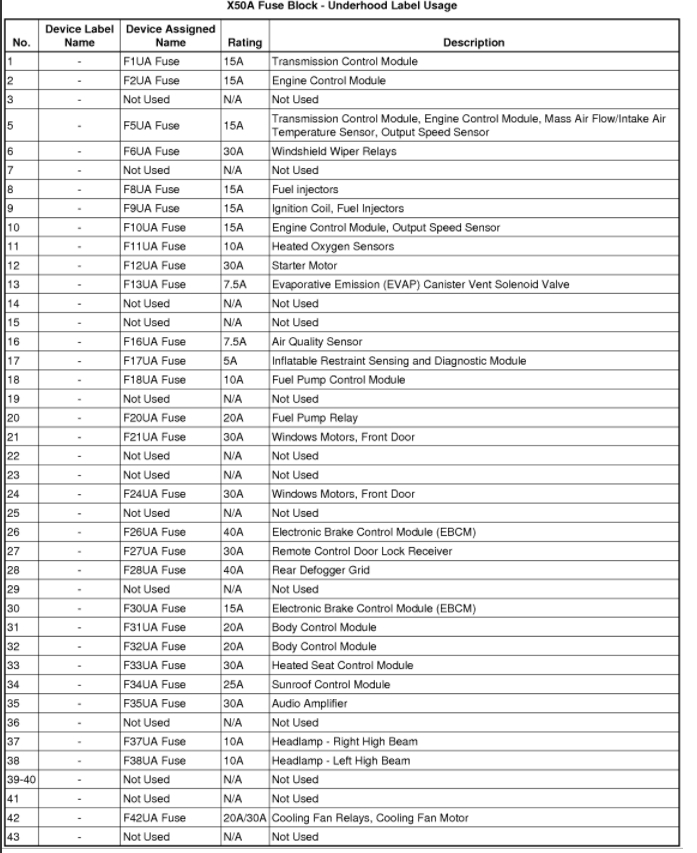

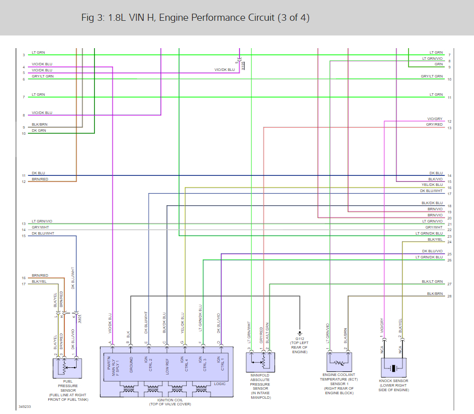

The fact that you have power to any of the coils (key on i hope) you have a power supply issue. Lets start by checking the fuses that run the system Here is a guide to help.

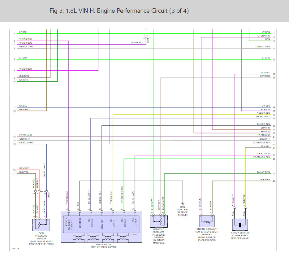

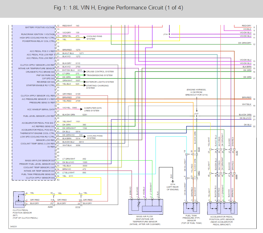

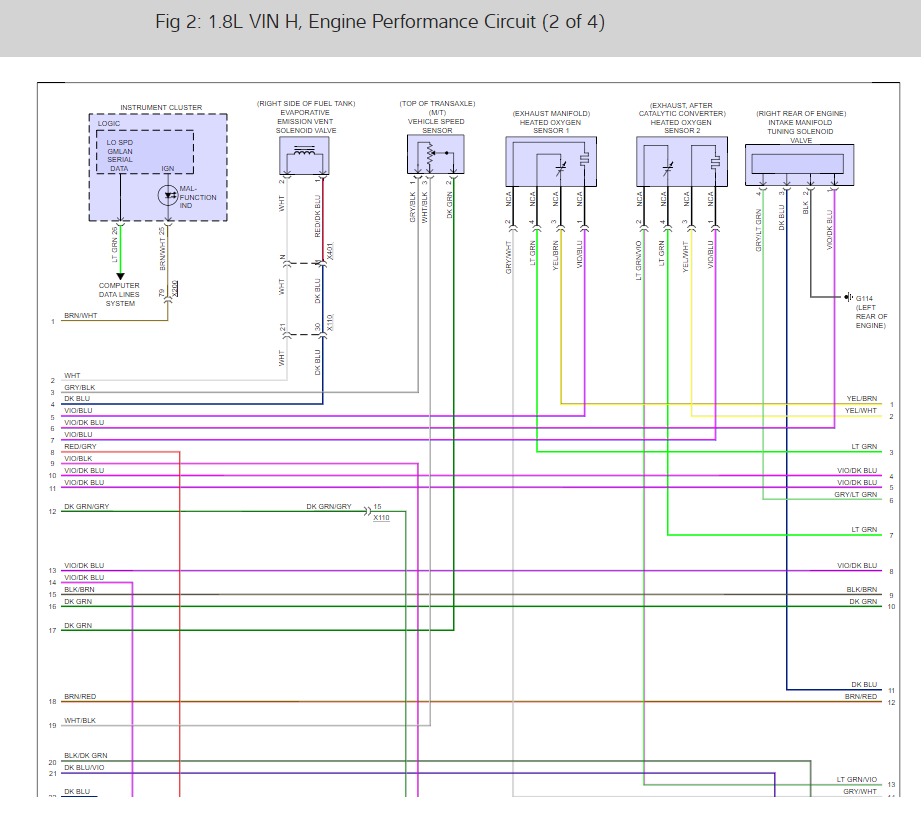

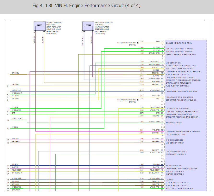

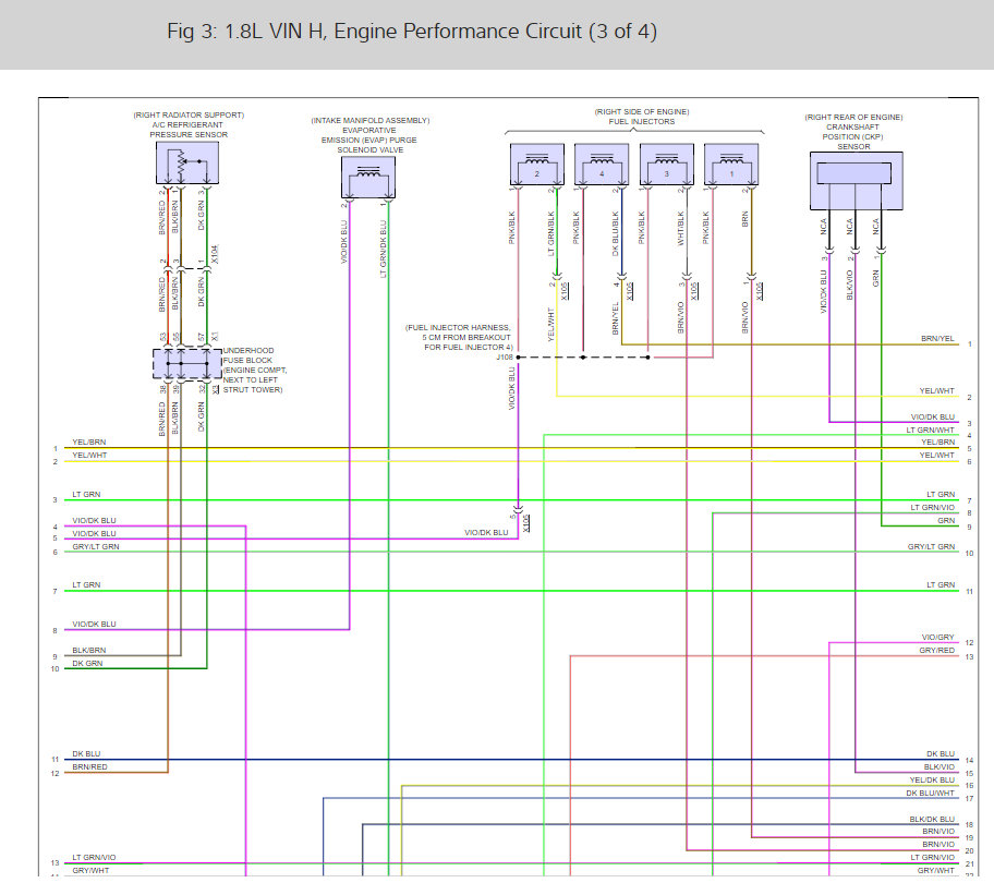

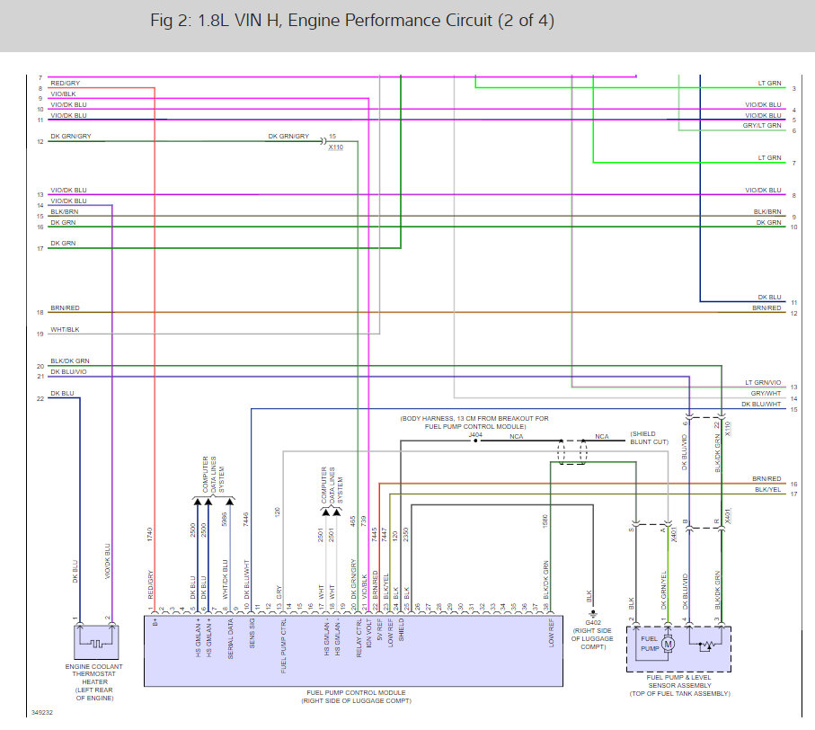

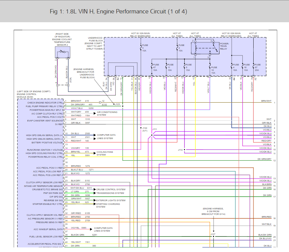

Here are the engine wiring diagrams and fuse panel locations so we can see what's up.

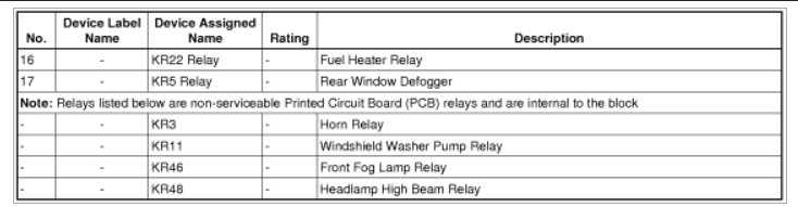

We should run the codes as well and check the powertrain relay.
Please run this test and get back to us.
