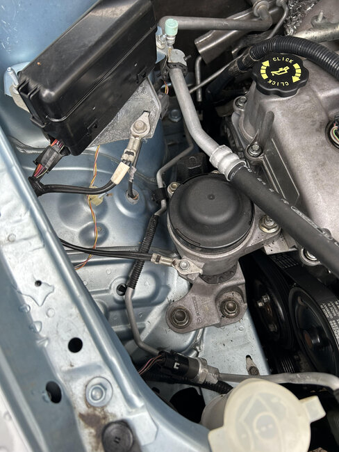

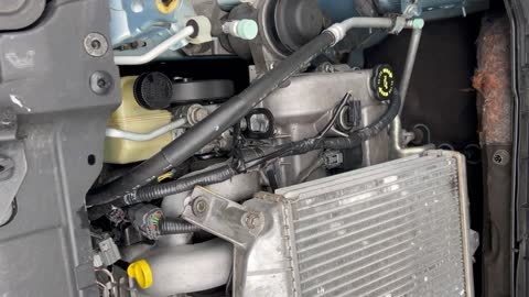

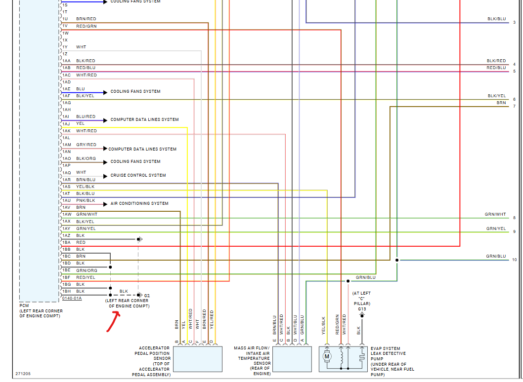

The ground is in the left rear of the engine compartment. Does the engine sound normal while cranking? If you upload a short video of the engine cranking from under the hood I can tell if the engine is hurt or not. Here is the ground location in the images below. Let us know how it goes.
Oct 28, 2024 at 1:54 PM
MARKB123
okay, cranks, seems to fire a little bit, and I think these 2 double black wires in the photo are ground(s) referred to?
Oct 30, 2024 at 11:01 AM
Yes, though are grounds, but the engine does not sounds good cranking, did anything fall down into the timing chain area when doing the repair? I would do a compression test because it sounds like the engine has jumped time. This guide can help confirm or not.
