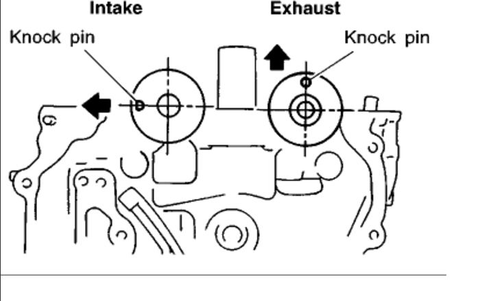

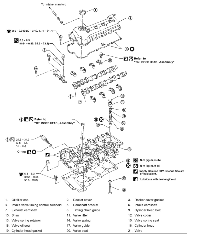

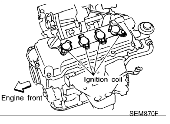

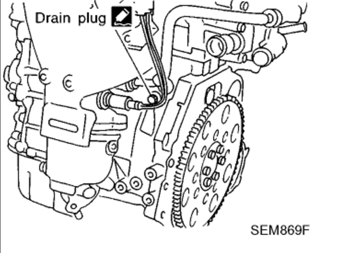

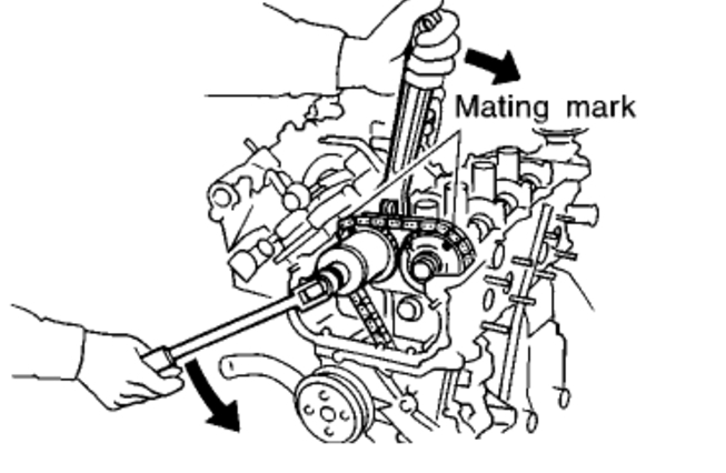

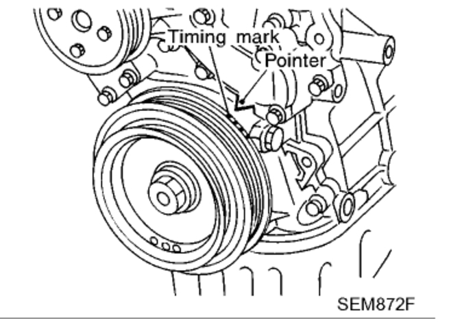

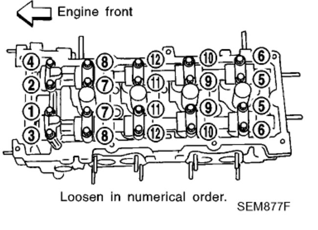

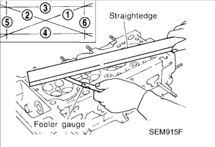

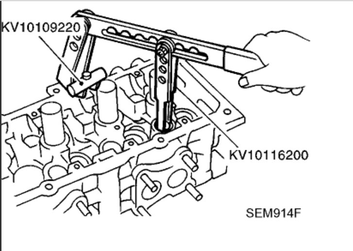

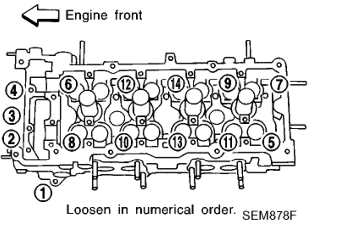

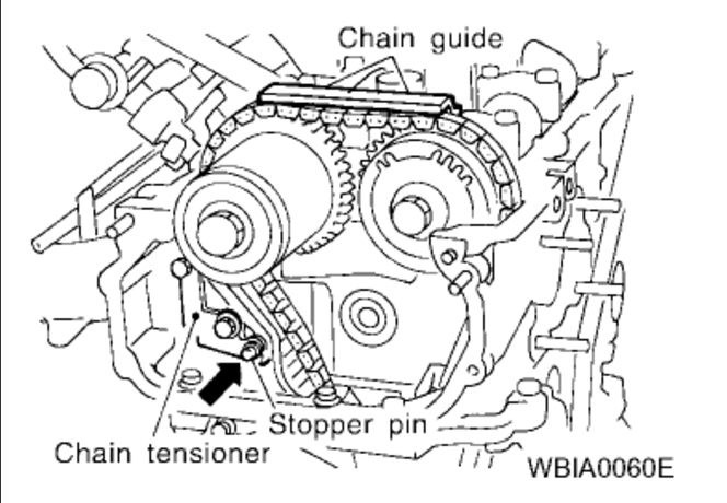

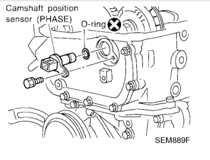

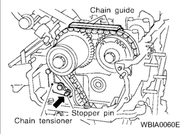

Yep the head needs to come off I would check the valves while the head is off. Here are some diagrams to help you get started.
Have the head resurfaced before reinstalling it.
Here is the instructions by the book.

Drain engine coolant. Be careful not to spill coolant on drive belts.
Release the fuel pressure. Refer to Powertrain Management; Fuel Delivery and Air Induction.

Remove the ignition coils.

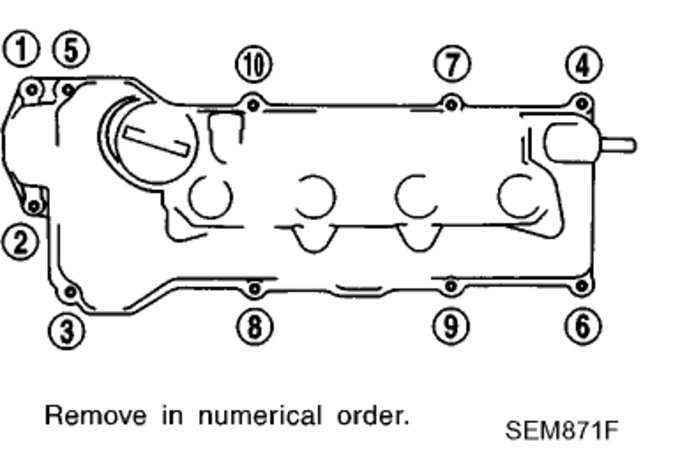

Remove the rocker cover bolts in numerical order as shown.

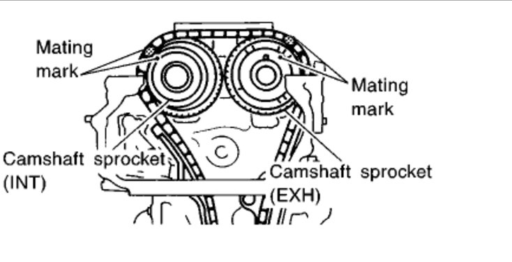

Set No. 1 piston at TDC on its compression stroke.
Rotate crankshaft until mating mark on camshaft sprocket is set at position indicated in figure.
Remove camshaft position sensor (PHASE).
Do not allow any magnetic materials to contact the camshaft position sensor (PHASE).
Be careful not to damage sensor.
Remove intake valve timing control solenoid.
Remove cylinder head front cover.
Remove timing chain guide from camshaft bracket.
Attach a suitable stopper pin to chain tensioner.
Remove chain tensioner.
Remove camshaft sprocket bolts.
Apply paint to timing chain and cam sprockets for alignment during installation.
Remove camshaft sprockets.
Remove camshaft brackets and camshafts.
Apply I.D. marks to brackets to ensure correct reassembly.
Bolts should be loosened in two or three steps.
Remove cylinder head bolts.
Remove cylinder head with intake manifold.
Head warping or cracking could result from removing in incorrect order.
Cylinder head bolts should be loosened in two or three steps.
