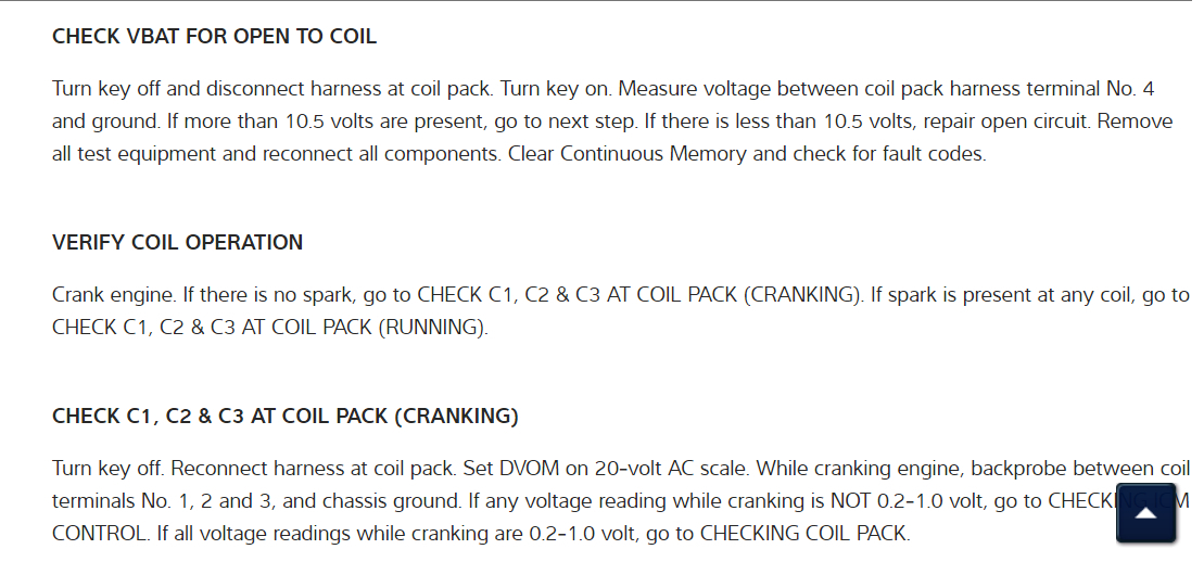

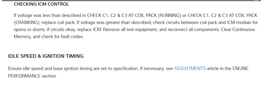

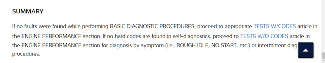

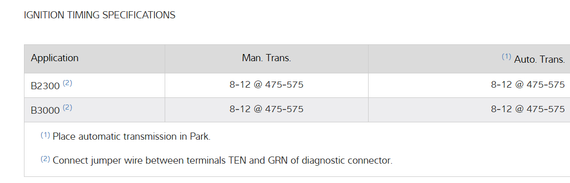

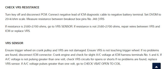

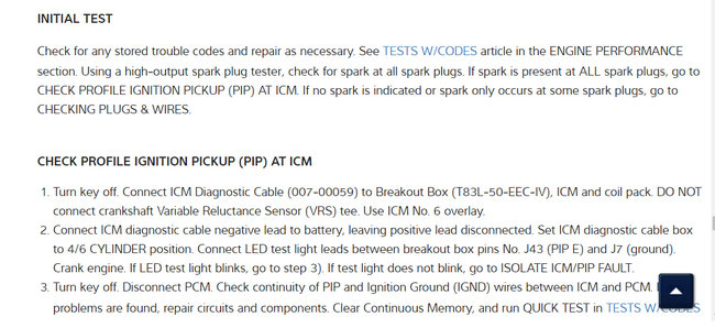

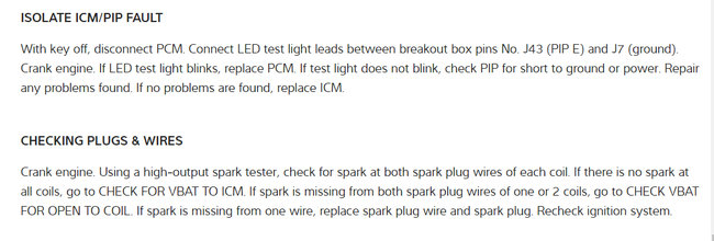

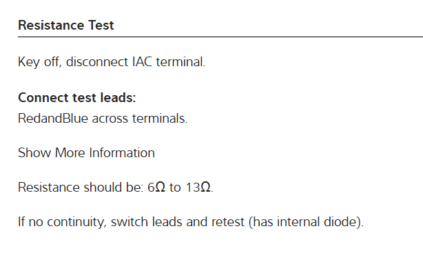

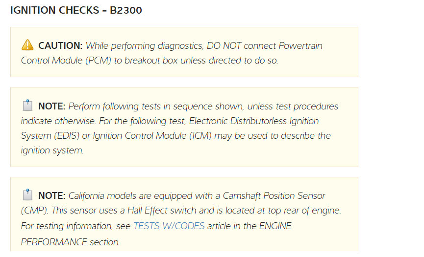

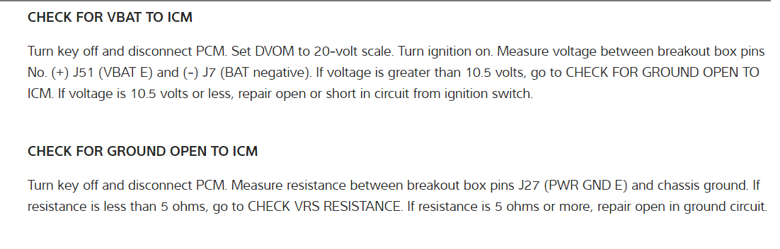

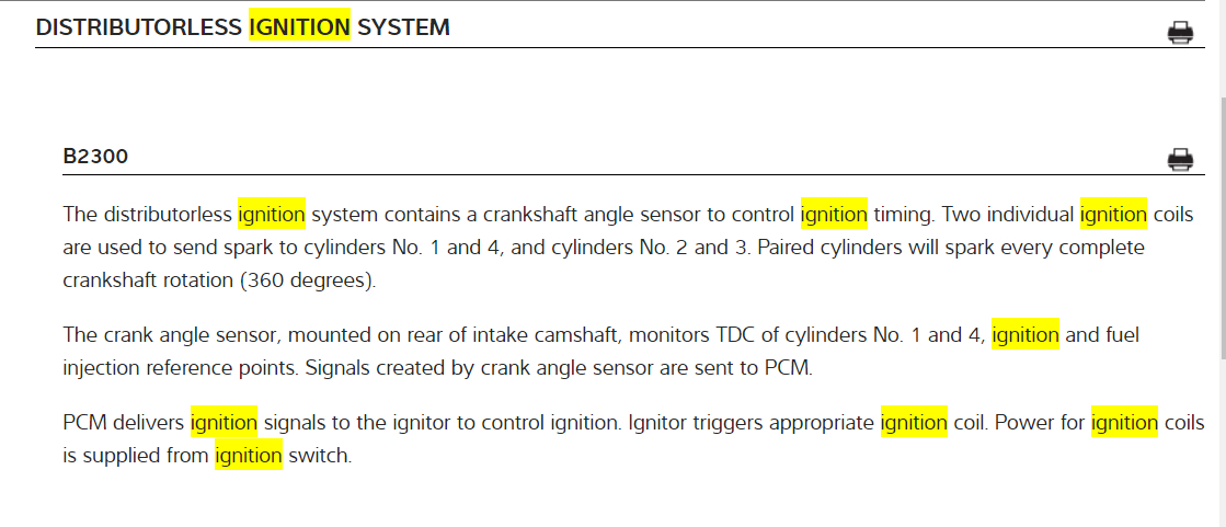

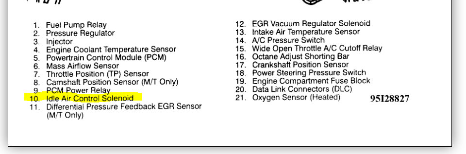

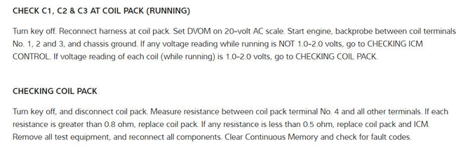

Truck will crank but not start. fuel pump works but not getting any spark. I have replaced crankshaft sensor, both coil packs, plugs and wires, ignition control module. It is not registering rpm when trying to start and the check engine light does not come on when I turn key to accessory.
