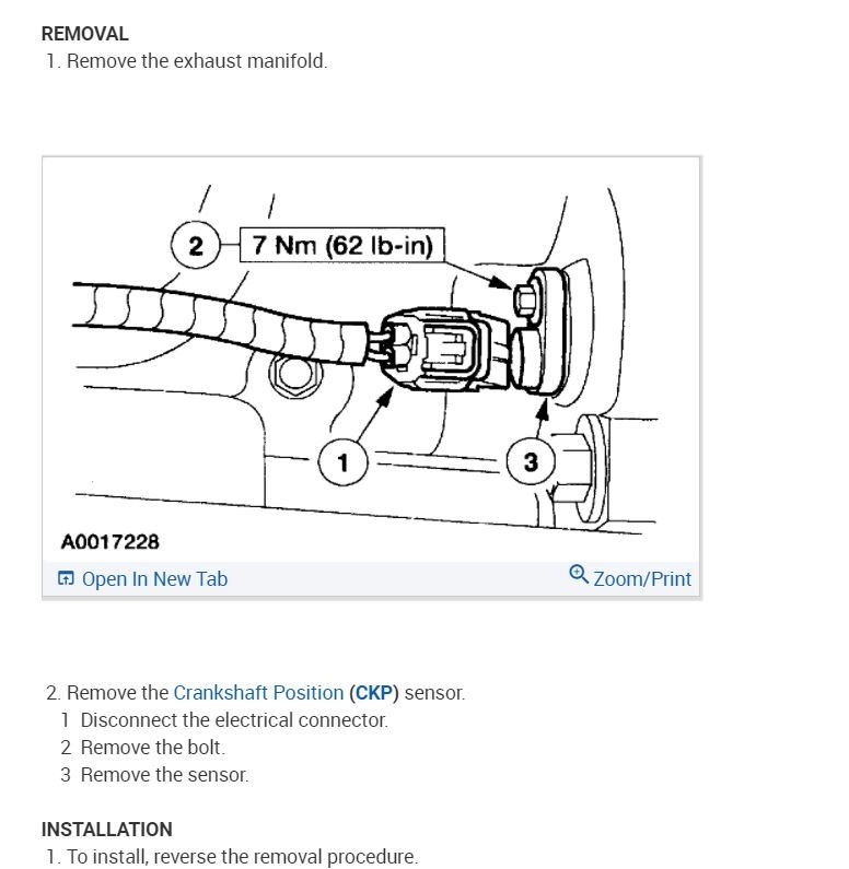

If you have no RPM signal, then your crank sensor is not sending a signal.
https://www.2carpros.com/articles/car-not-running-advanced
I would start with a crank sensor to be sure.
I attached the procedure below for you of the repair.
Let us know if you have any other questions.

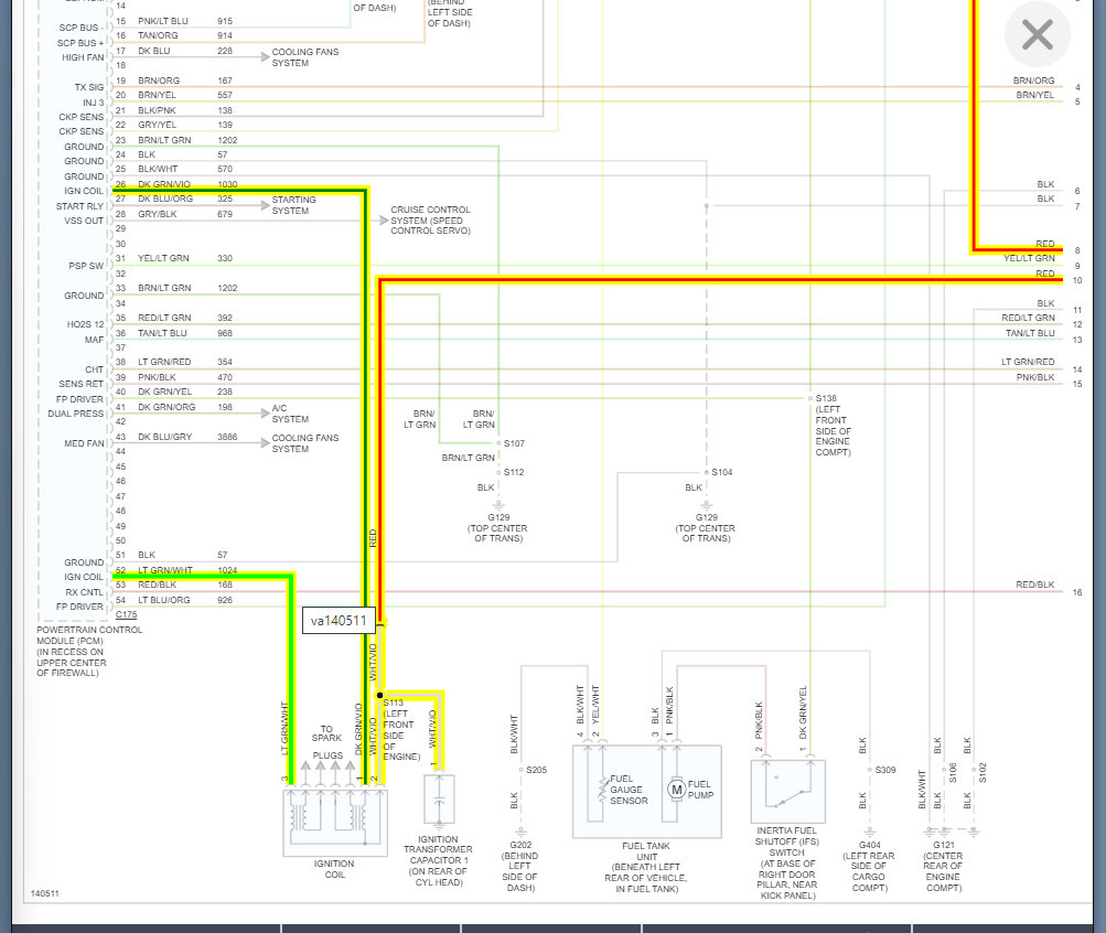

Just to jump in on this could be a harness issue.
However, I would suggest we start by finding out what the voltage readings are at the coil when you are cranking the engine.
Basically, if you have replaced the PCM and coil we can assume there is something preventing the coil from firing, but it may not be the PCM.
Here is a guide that will help with checking the voltage:
I am specifically interested in the red wire coming from the relays. Basically, this wire is fed by the fuel pump relay which feeds the PCM power relay.
If we don't have power on this wire, then one of these relays could be the issue or one of the fuses feeding these relays.
Let us know what you have on each of these wires, and we can go from there. Thanks

Okay. One more follow up just to be sure but I think you are confirming this.
You have 12 volts going to the coil on pin 2. What do you have on pin 3 the light green wire? The other wire is what interrupts the low voltage to create the high voltage spike. However, the PCM controls the coil on the light green wire. So, you can put your meter across pin 2 and 3 and it should be 12 volts.
If it does then I agree it sounds like a harness issue and I totally understand the issue of finding one.
I am sure the Mazda is going to be close, however, I can't guarantee it will be exact. However, this generation of vehicle they were pretty much the same vehicles.
