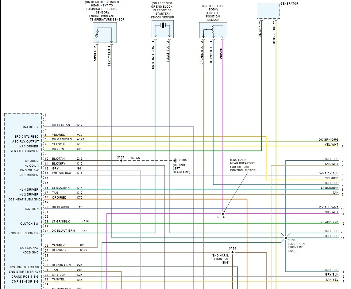

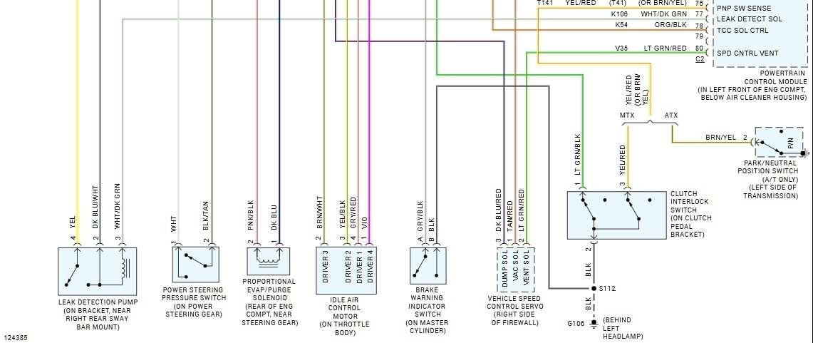

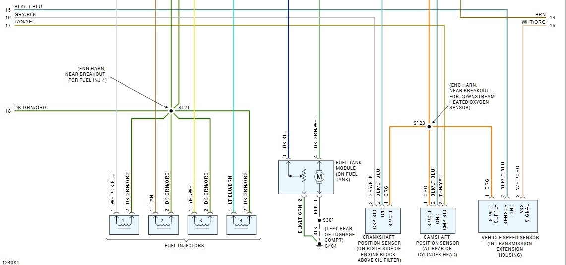

AL514
  • 5,462 POSTS

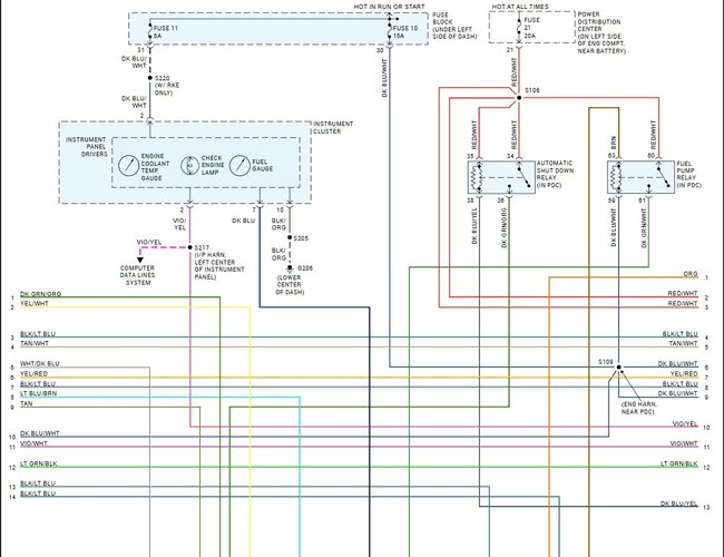

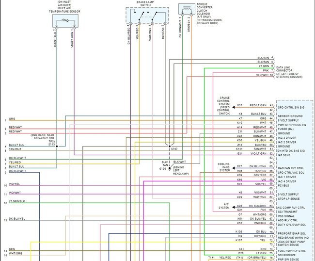

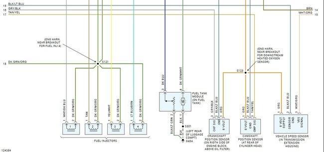

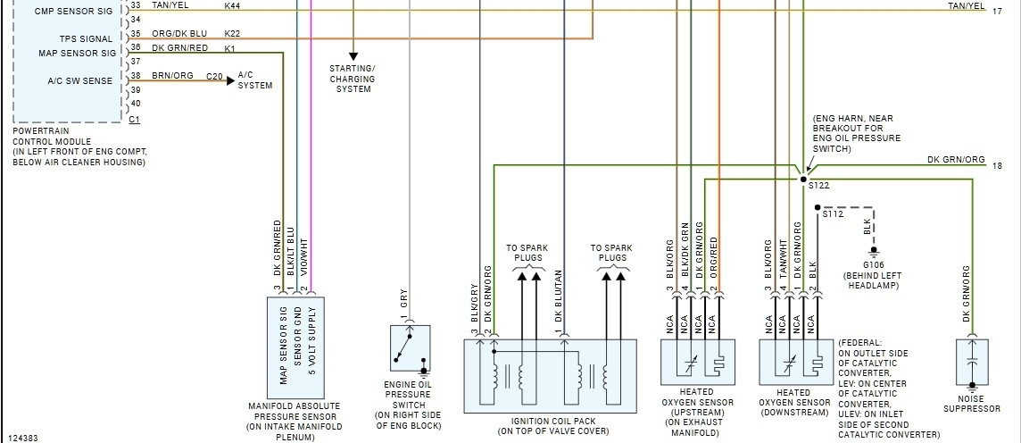

Here are the wiring diagrams for the engine computer (ECM) diagram 1,2 (top, bottom) etc. Check for spark, injector pulse, and fuel pressure. Also verify the spark plugs are not flooded out.
