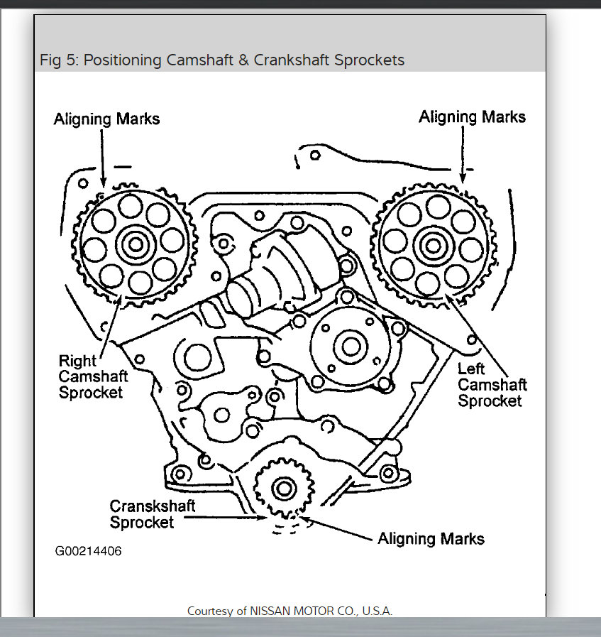

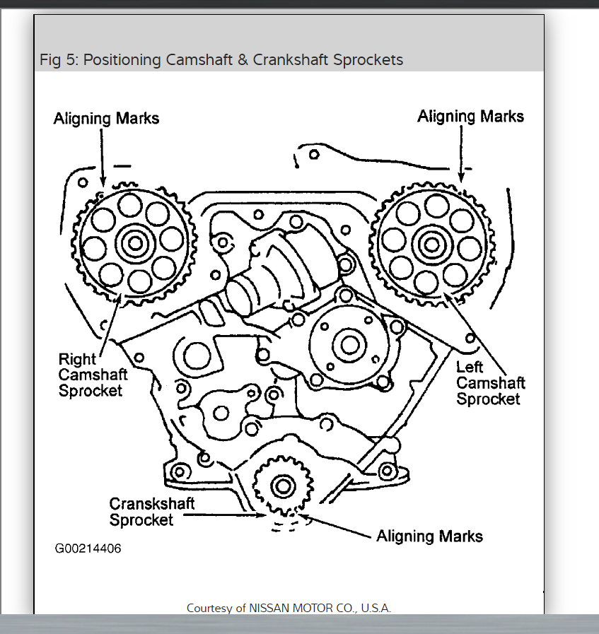

Replaced head gasket and timing belt put back together started right up but shut off. It will start back but no power, will not rev up. any ideas?
Jul 9, 2019 at 2:17 PM
SCGRANTURISMO
  • 4,897 POSTS

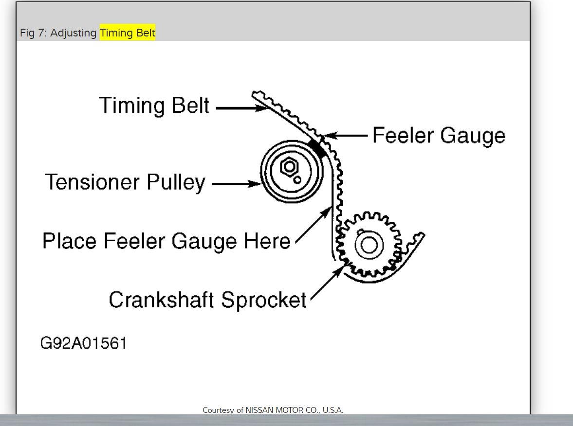

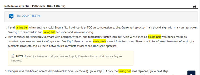

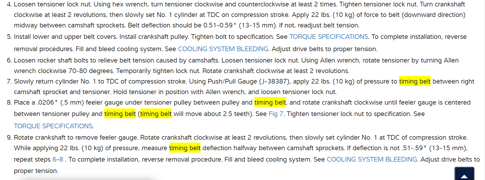

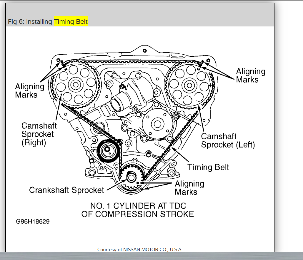

I would double check and make sure the timing marks are lined up. In the diagrams down below I have included the factory instruction for installing your vehicle's timing belt. Please go through this guide and get back to us with what you are able to find out.
