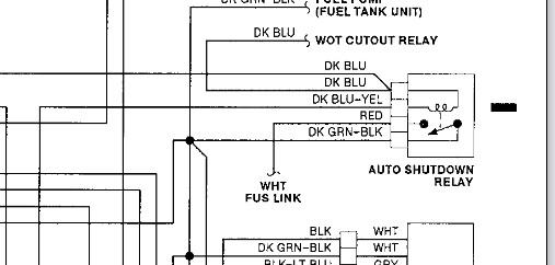

Next, the Engine Computer turns on the automatic shutdown (ASD) relay for one second when you turn on the ignition switch, then again during engine rotation, (cranking or running). The fuel pump will run for that initial one second. That is why you see fuel pressure at the rail. What is important is if that relay is turning on again during cranking. If it isn't, you won't have power to the fuel pump, AND you won't have spark. To check if the ASD relay is turning on, measure the voltage at the ignition coil, any injector, or either small terminal on the back of the alternator. A test light works better for this than a voltmeter because it's easy to see when working by yourself. You'll see it flash on for one second when you turn on the ignition switch, and you may hear the hum of the fuel pump. If it doesn't turn on again during cranking, recheck the wires and air gap for the crank sensor. If it does turn on solidly during cranking, you have a spark OR a fuel supply problem.
On newer cars that wire to check the voltage on is usually dark green / orange. I can't remember the color on a '93 truck, but it will be the same color and stripe at every injector and the ignition coil. The same color wire feeds the 12 volts to the alternator, but because of the black rubber terminal block, you can't tell which wire goes to which terminal. The wrong terminal is still a valid test point because while its voltage may be less than 12 volts, it still will only be there if the right terminal is getting voltage. Those are my favorite terminals to use because you don't have to back-probe a connector and wonder if the probe is making good contact with the terminal. Never, ever poke a hole in a wire to take a reading. Moisture WILL get in there and corrode it.

That voltage comes from the asd relay. Must be a problem with wiring circuit from asd relay to positive side of coil. Can't be the relay in my opinion, that relay supplies voltage to several system, those system wouldn't work either, if the relay was faulty.

The coil gets B+ from the asd relay, as do several other systems. When you add the jumper wire you could be back feeding voltage to the other systems.
