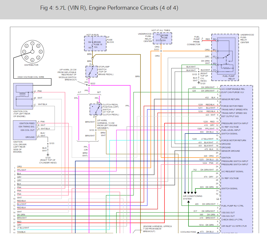

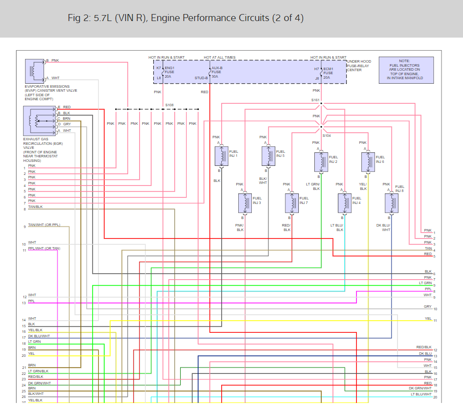

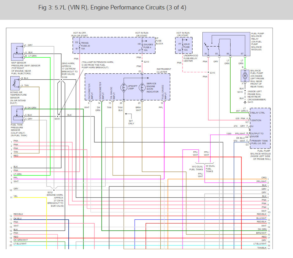

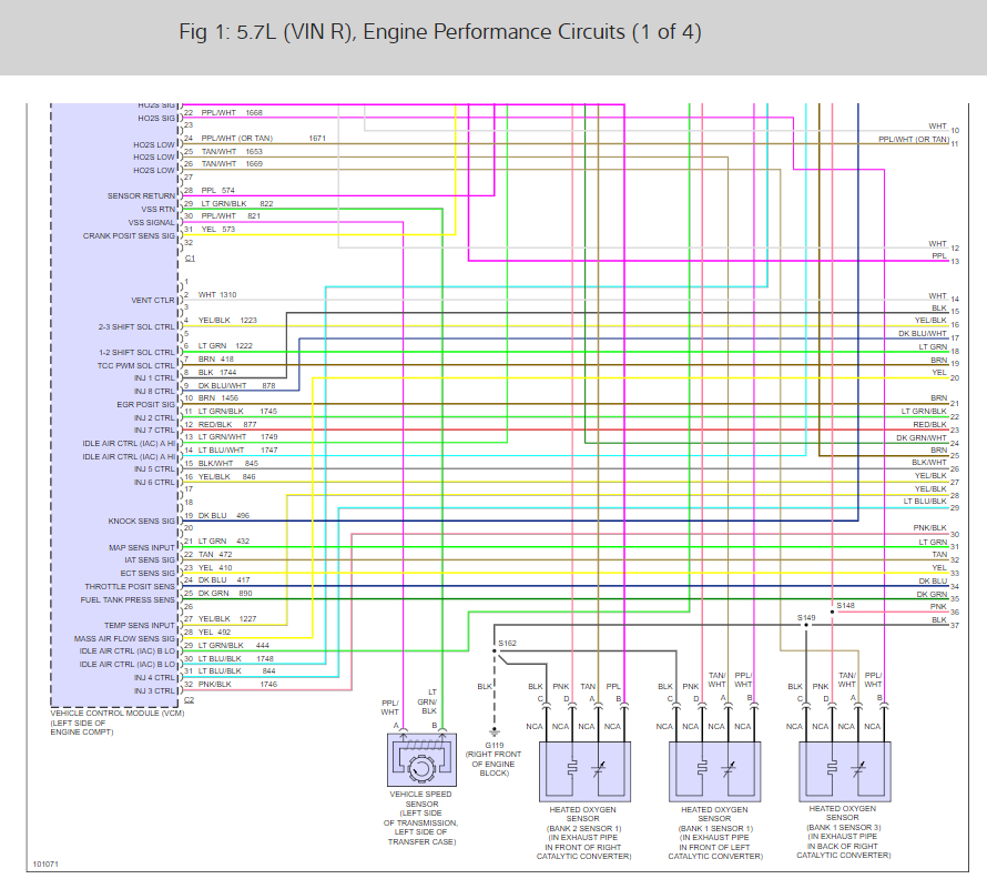

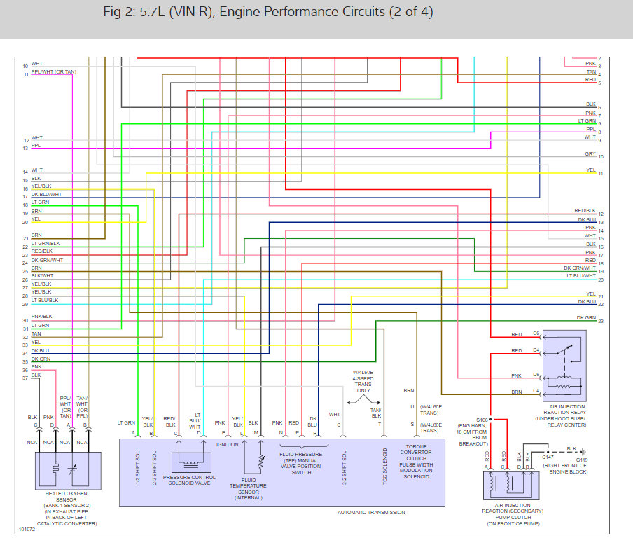

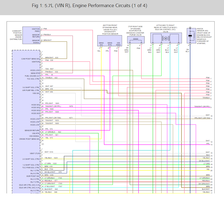

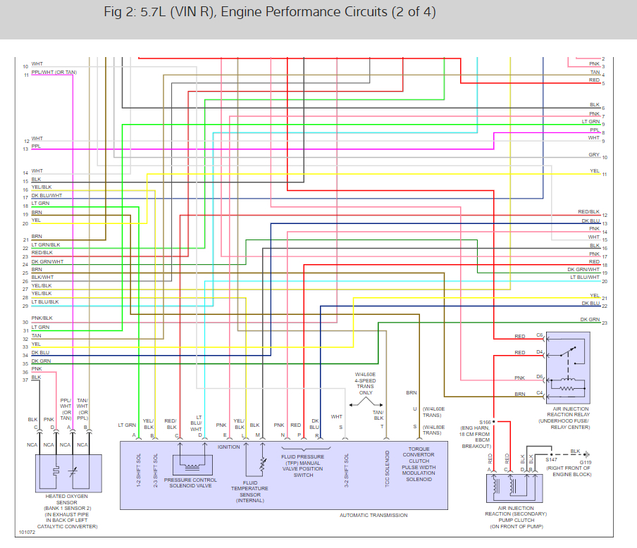

You check for spark coming out of the coil right not the plug wire? It sounds like you have a wiring issue. but to be sure here is a guide and the engine wiring diagrams to help us get started:
Make sure you have power at the ENG1 and ECM1 fuses.
