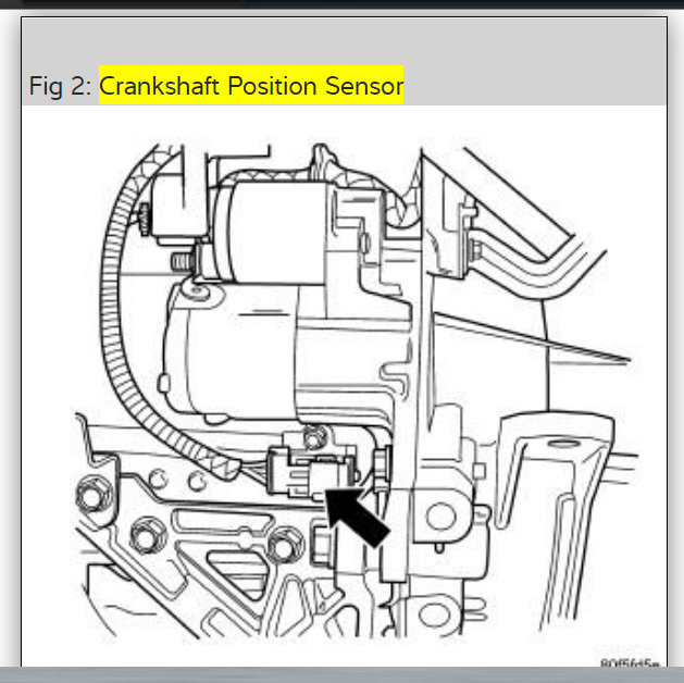

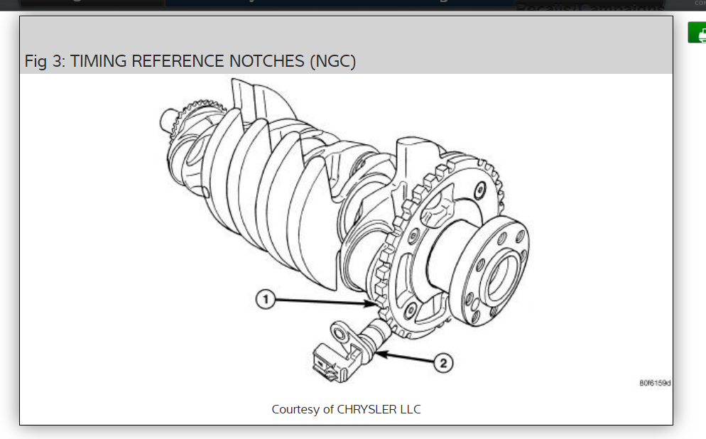

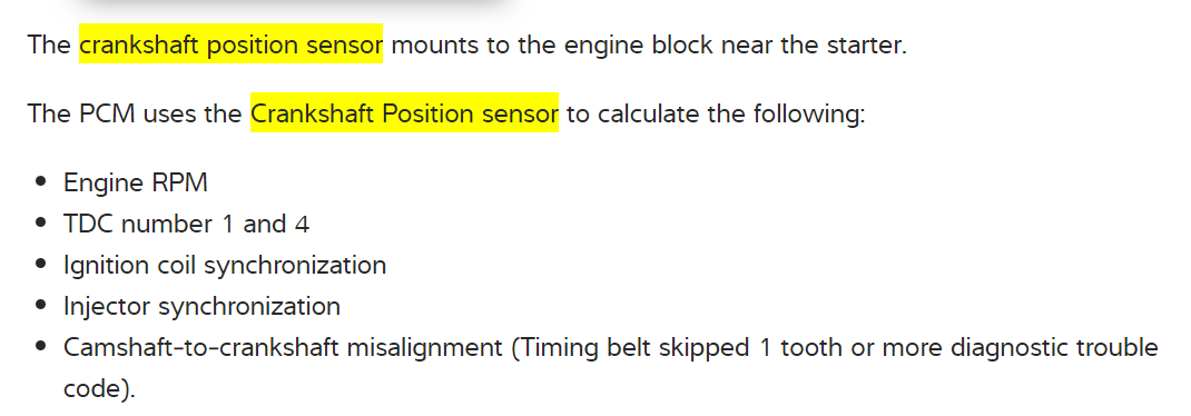

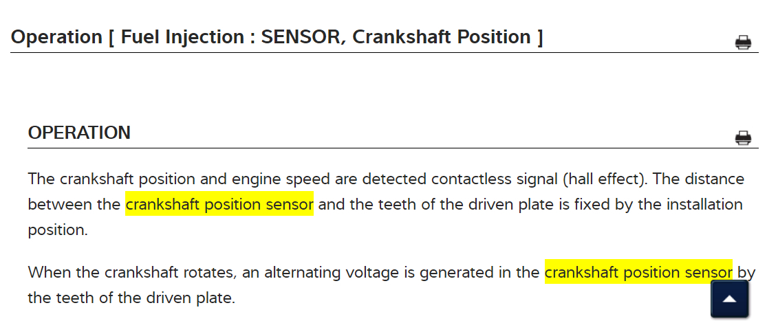

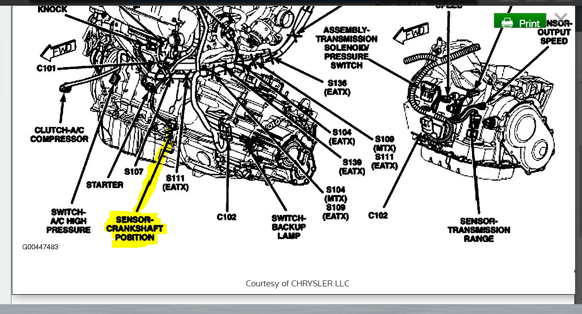

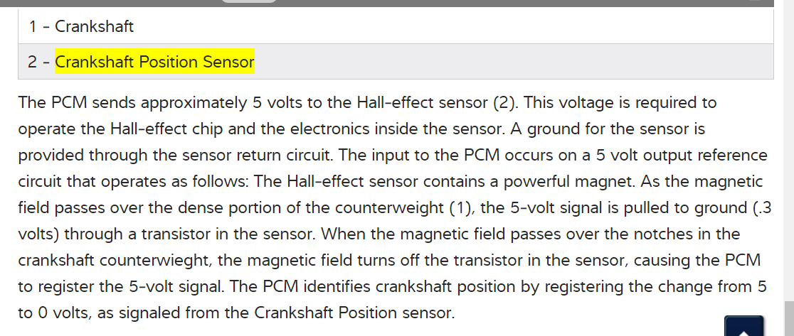

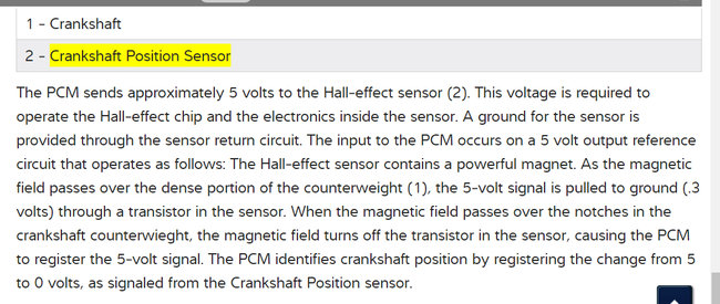

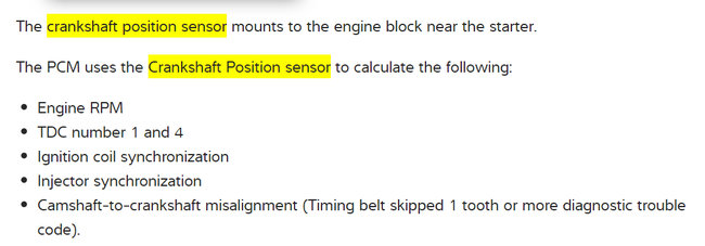

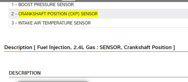

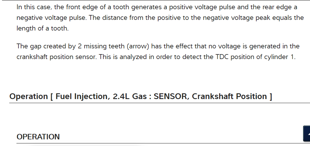

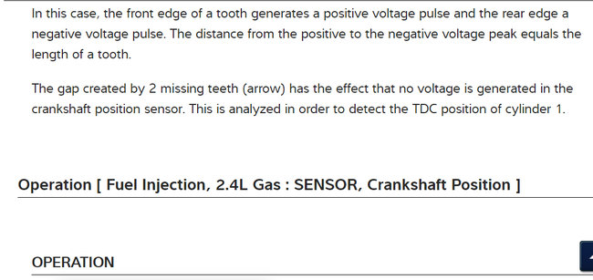

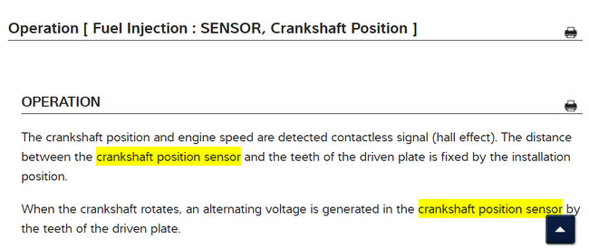

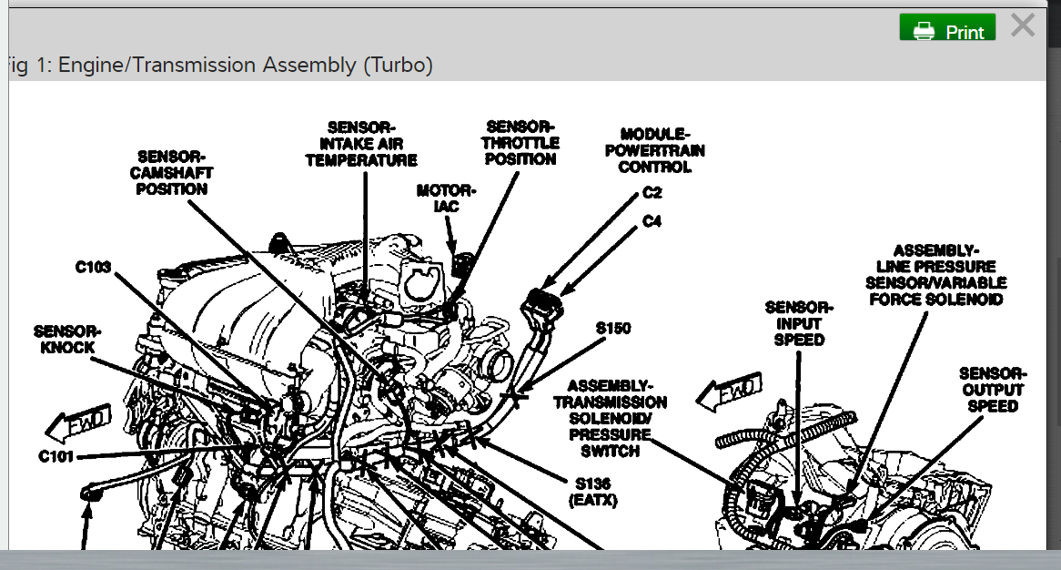

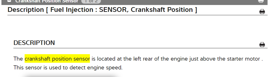

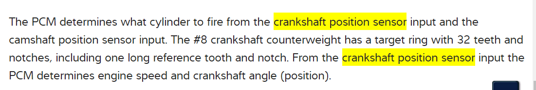

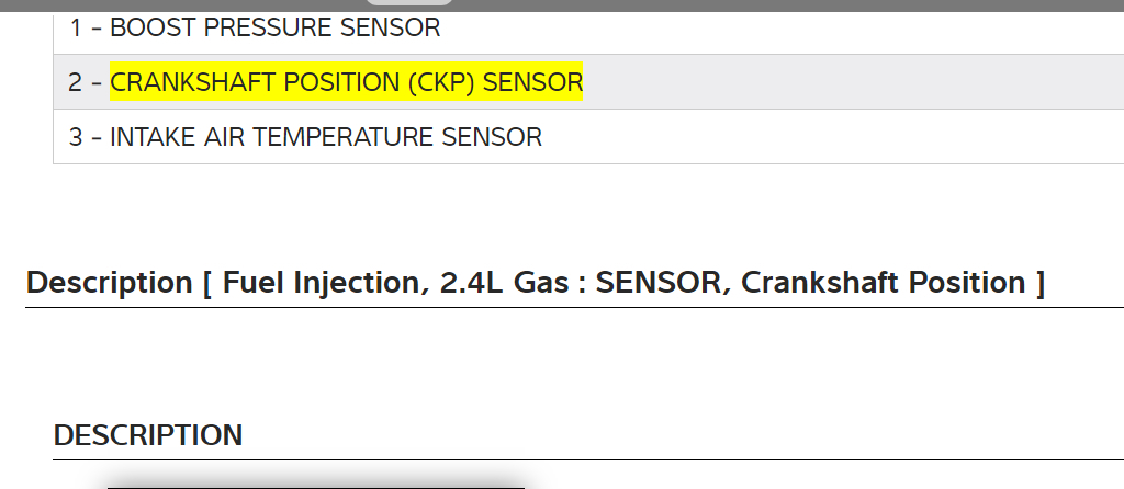

This could be a problem with your vehicle's Crankshaft Position Sensor (CKP). Your vehicle's Power-train Control Module (PCM) uses the signal from both the Camshaft Position Sensor (CMP) as well as the CKP to determine when to fire not only the spark plugs, but the furl injectors. Without the CKP signal your vehicle's PCM might fire these components, but it won't know the proper time, therefore your engine will not start. I have included a couple of links below for you to go to:

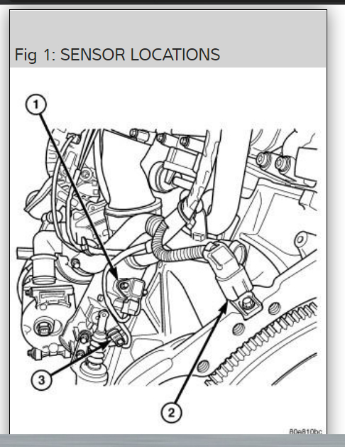

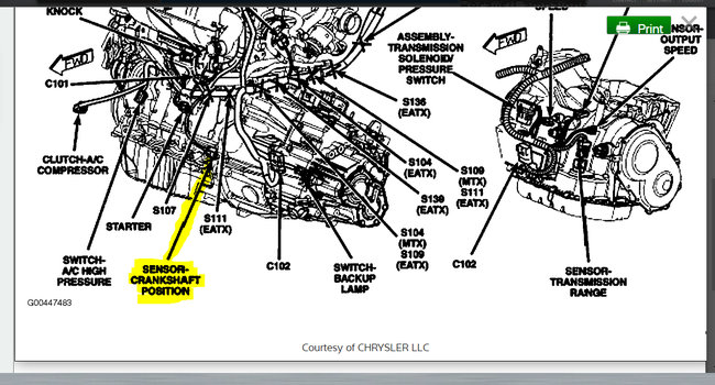

I have also included in the diagrams down below the description of your vehicle's CKP circuit as well as it's location in the diagrams down below. Please go through these guides and get back to us with what you are able to find out.
Thanks,
Alex
