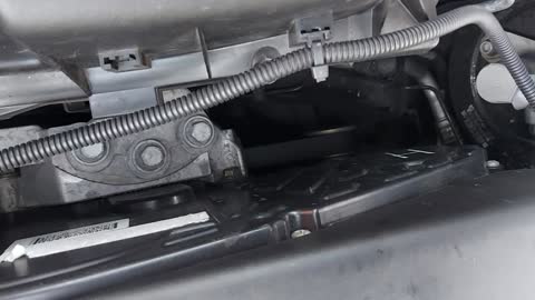

Hi, please find attached sound probably around engine. What it can be? Or is it easy to fix?
