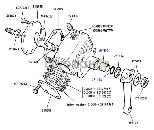

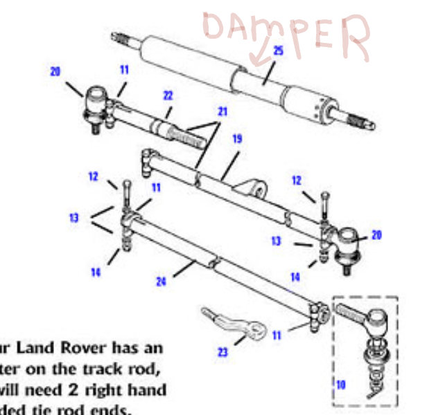

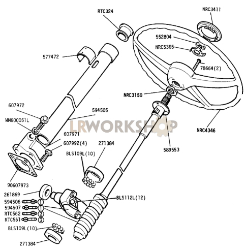

It could be your steering shock grabbing when you turn right or the universals and column bearings in the steering column they can rusted and dry remove the column make sure there free and not worn out. It could also be the steering gear ball bearings remove it make sure it also turns freely. I'm attaching a steering noise guide and schematics to help you locate your noise and rough steer to the right. Let us know if this information was helpful and what fix it and if you need more info.
