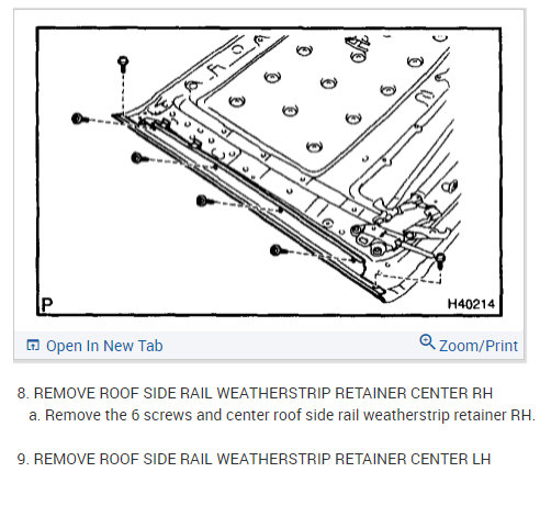

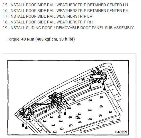

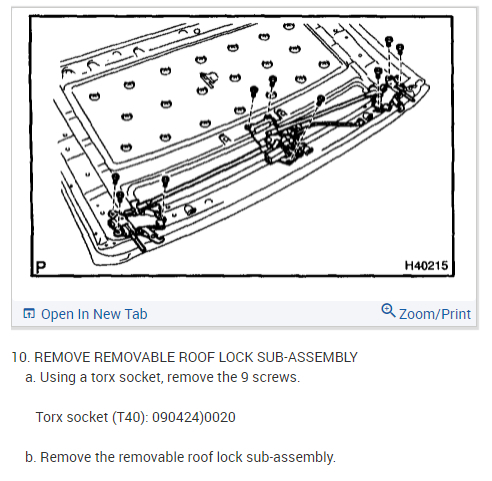

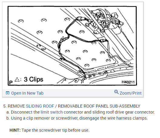

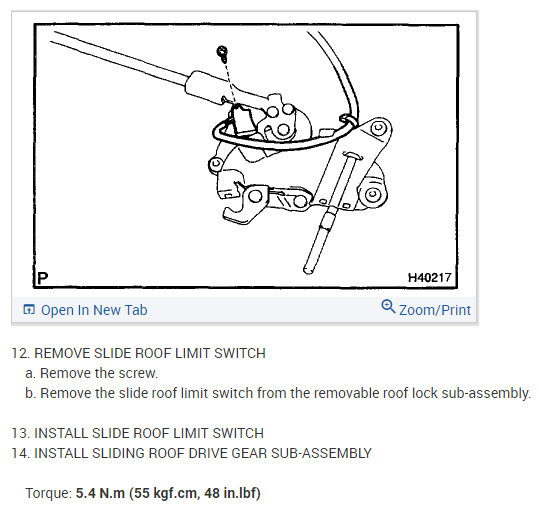

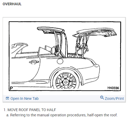

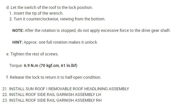

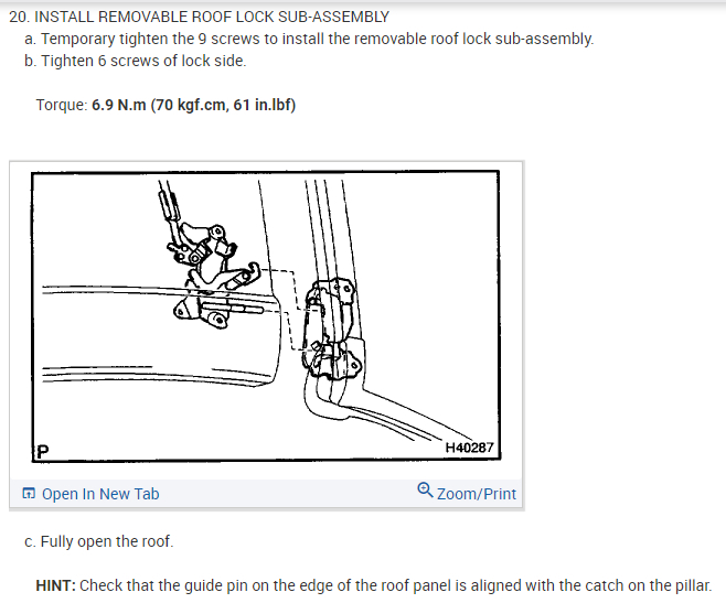

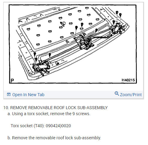

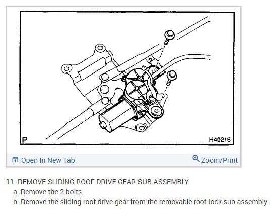

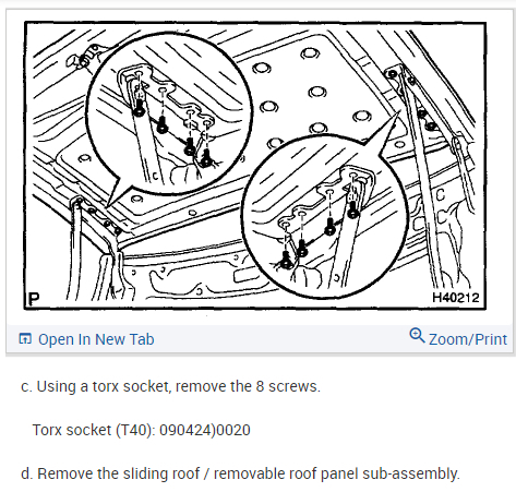

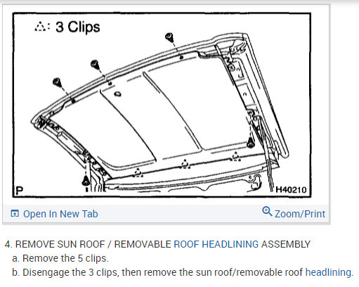

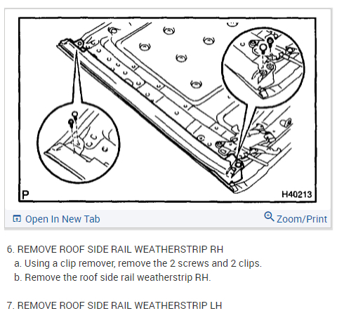

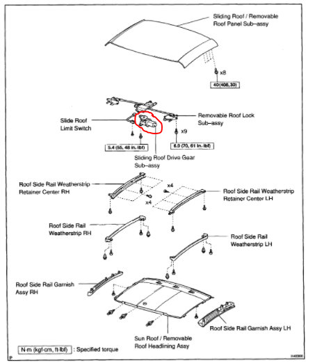

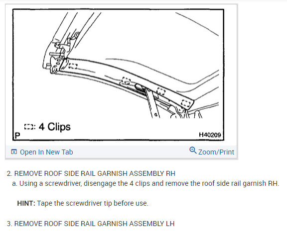

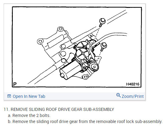

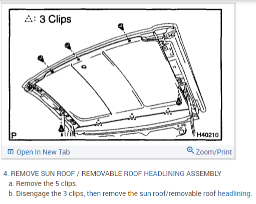

Unfortunately, We cannot provide referrals for auto repair shops. what we can do is provide you with guides to help you repair your car yourself. I've attached picture steps below on how to take apart your convertible top to remove and replace the drive gear assembly on your Lexus. Hope this helps and thanks for using 2CarPros.
