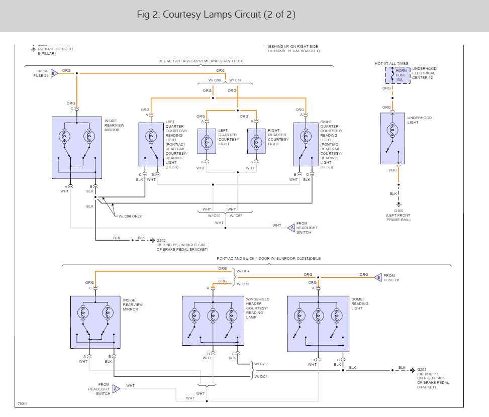

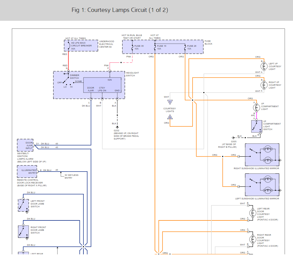

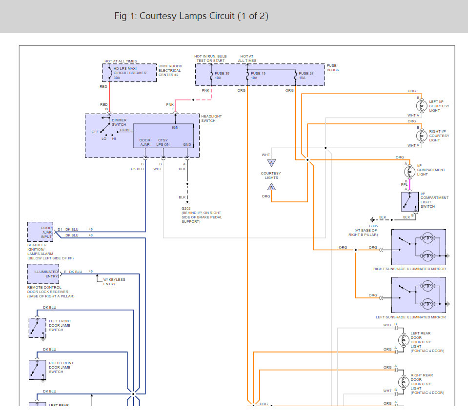

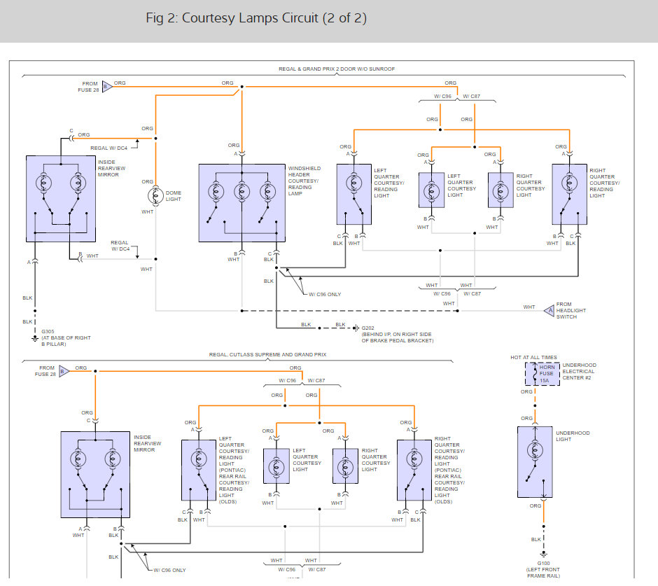

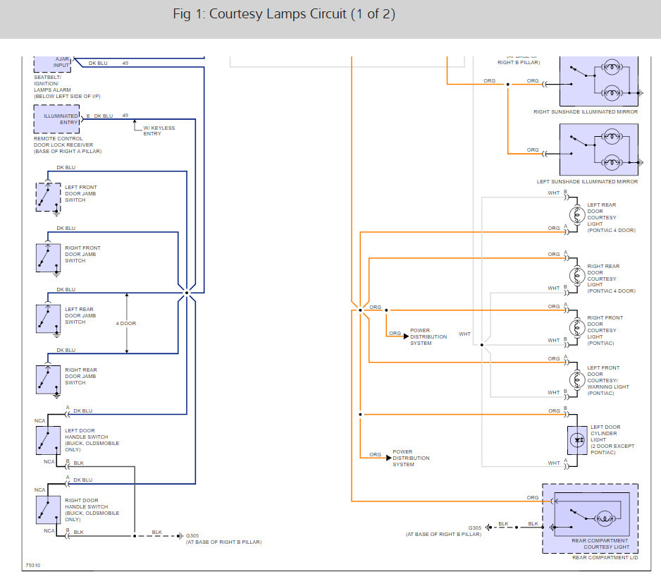

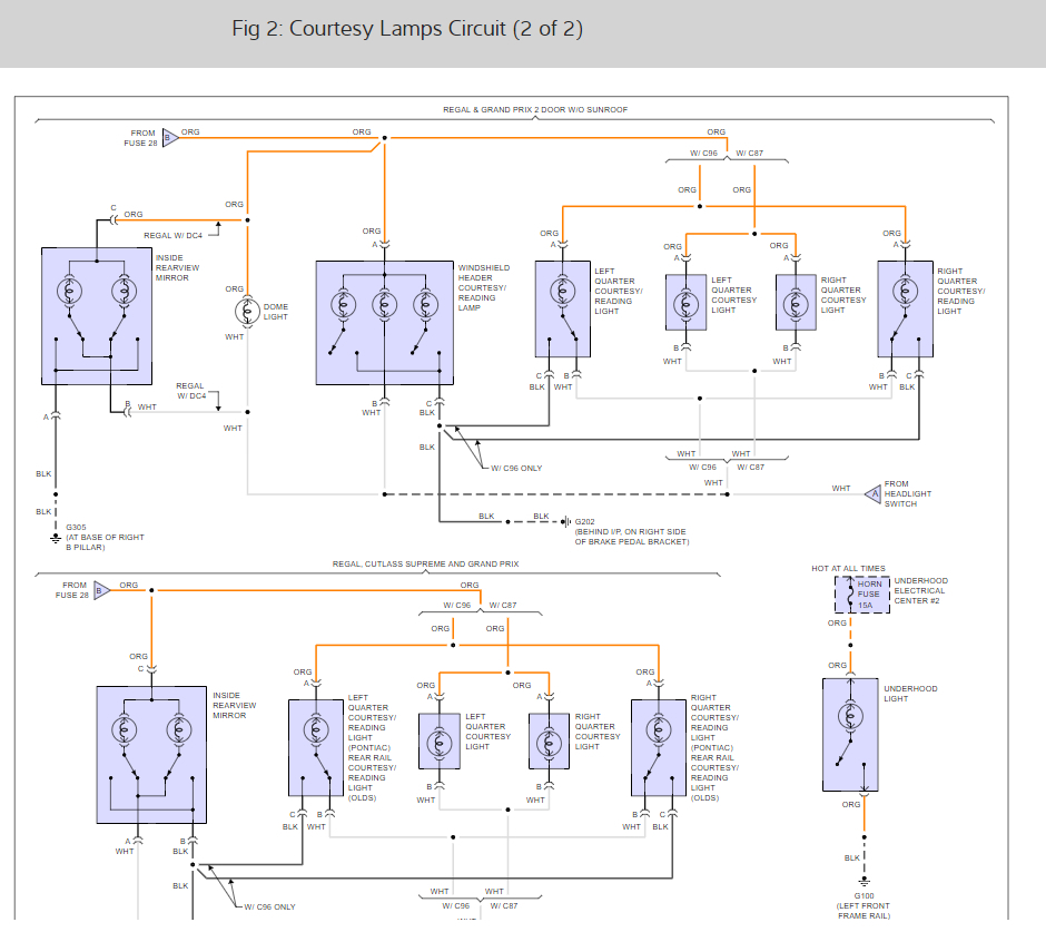

This sounds like a bad door light switch which I would test using this guide and the interior light wiring diagrams below. Test for ground.
Check out the diagrams (below).
