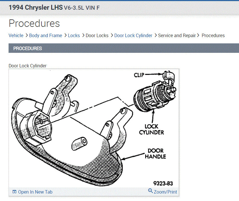

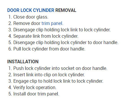

I read through the manual and it only provides one part number for the door lock cylinders. Also, I attached the directions below for removal and replacement. It has been a long time since I was in one of these, but the only thing I think could cause you trouble is the clip location that holds the linkage onto the lock cylinder.
Take a look at the directions below. You may need to open the door panels to see if the clip is on the opposite side. However, I think it should work.
See pics below.
