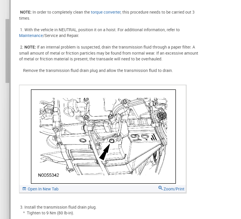

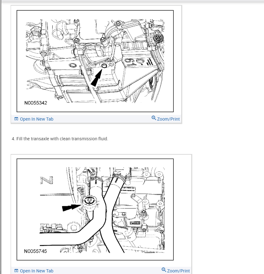

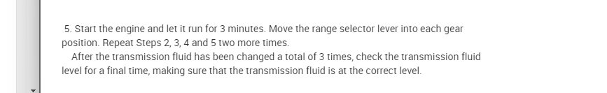

I am attaching the info below from the manual on how to change the fluid. Clearly this is recommended if the fluid is not in good condition.
I would suggest we start with this and go from there.
