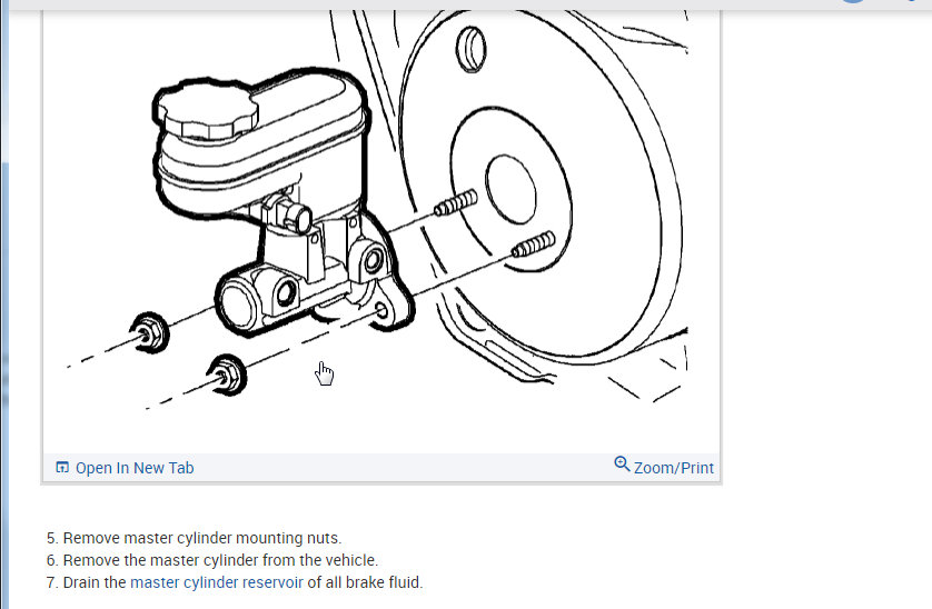

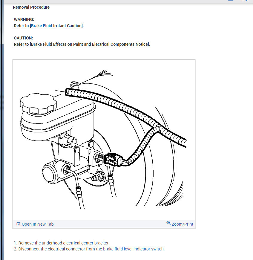

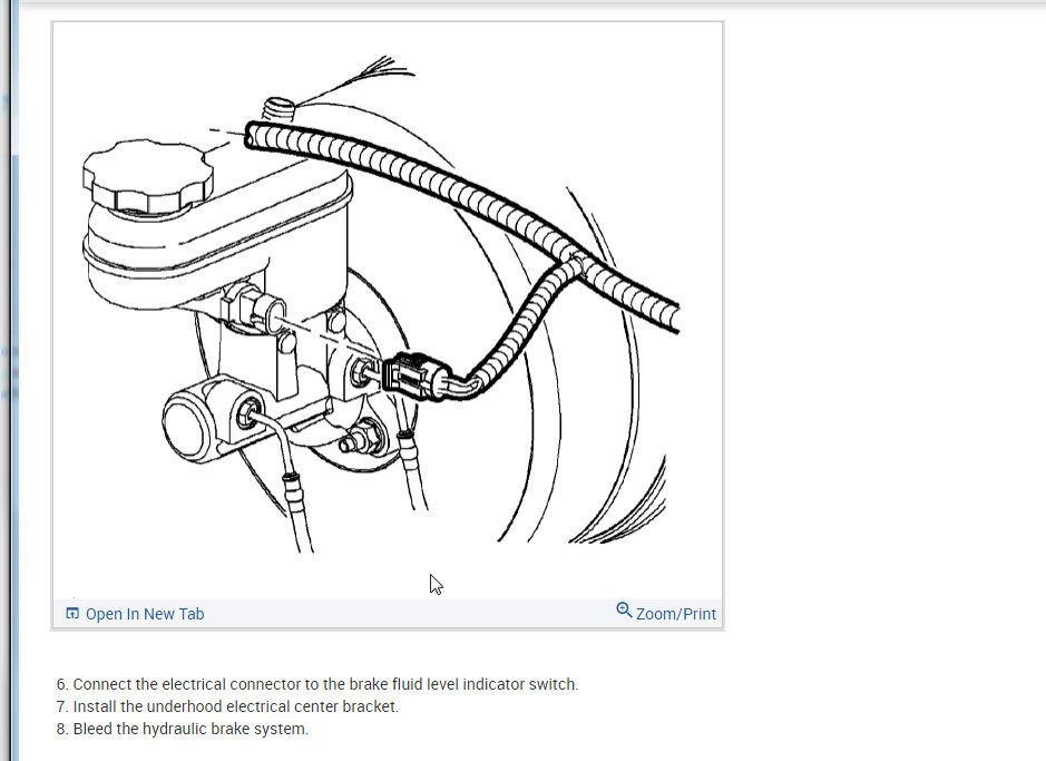

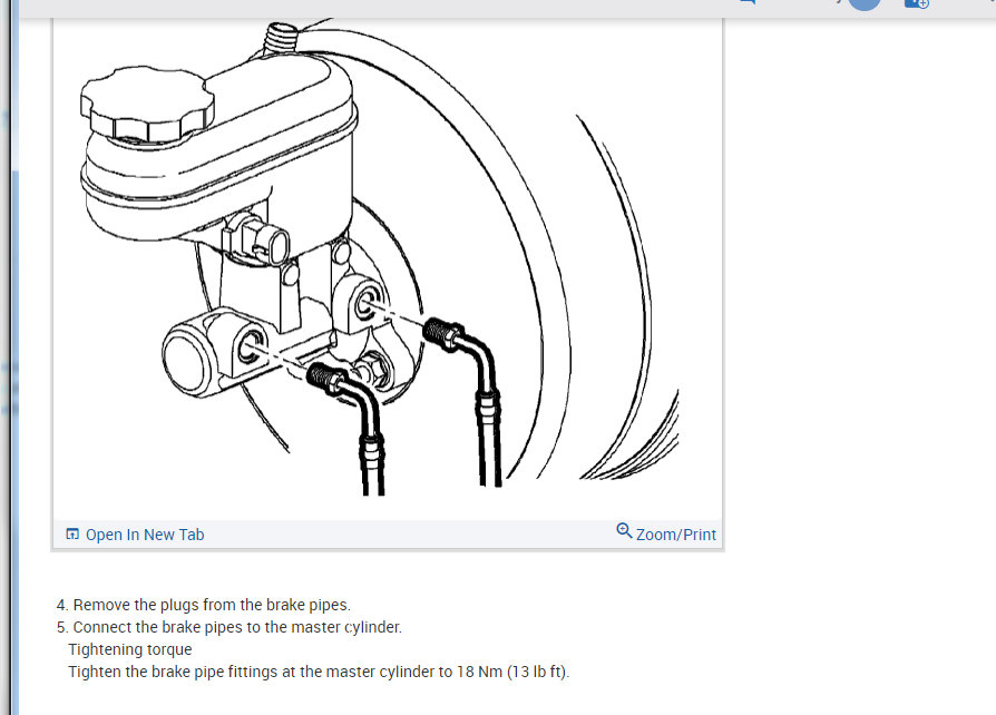

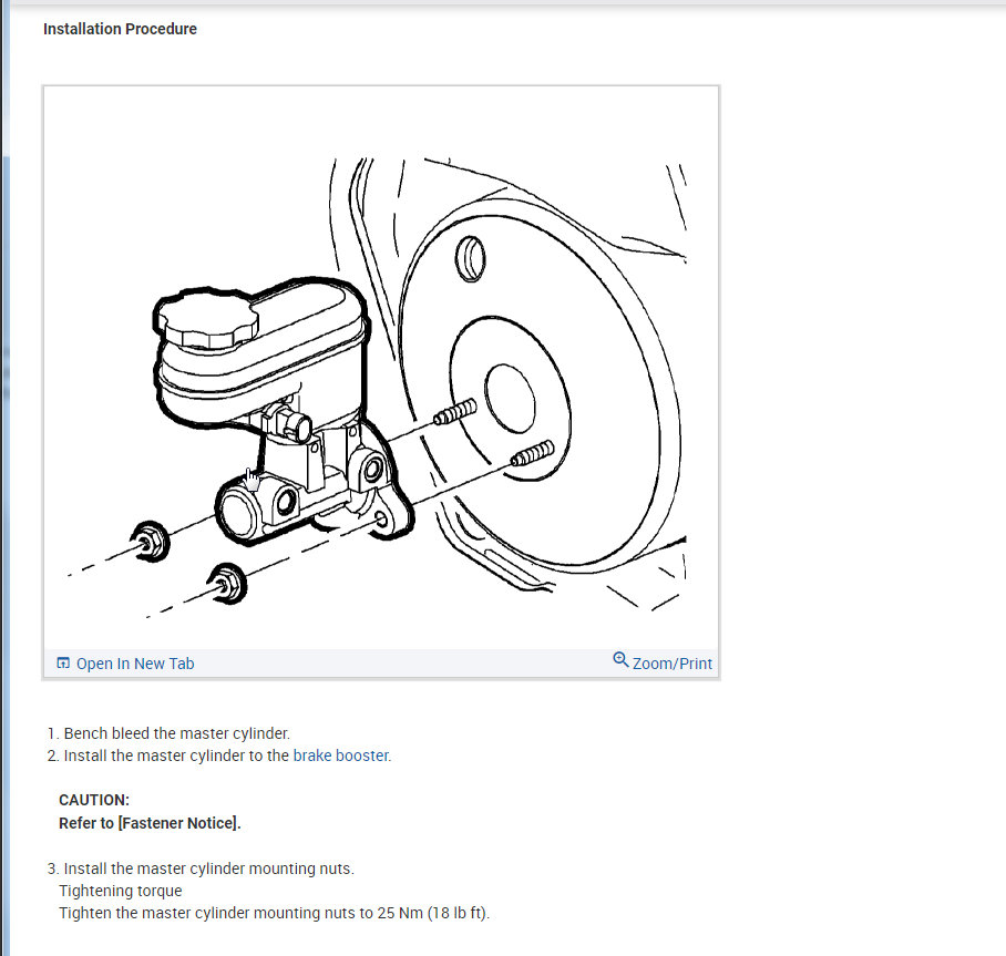

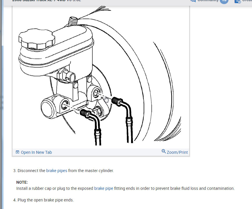

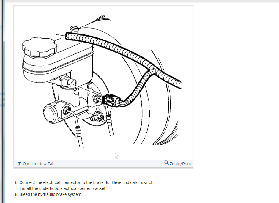

Here is a guide that will help with this:
https://www.2carpros.com/articles/how-to-replace-a-brake-master-cylinder
Below you will find the process from the manual on how to replace this so let us know what questions you have. Thanks for using 2CarPros.
