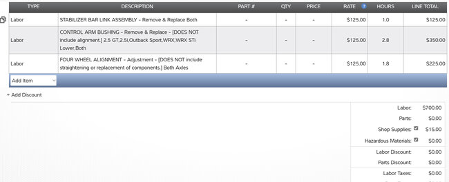

You didn't say whether it was the front arms you were doing or the rear, so I priced the front for you. You can expect closer to $900 if you do the rears. Book time on rear arms is 3.8 hrs. and front are 2.8hrs.
A good way to save money is to buy your own parts so they can't mark them up. Then you will just have to worry about labor.
I made a quote for you from my software to give you an idea of the labor times which will help negotiate with service advisors or mechanics.
At the end of the day, you have the power. They want and need the work. So, try to negotiate.
