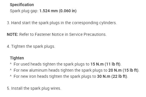

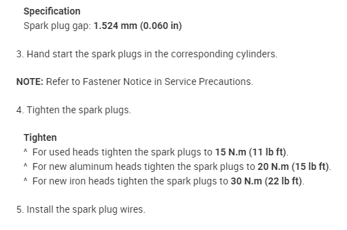

No, both are the same. Below is the spec for you. Please let us know if you need anything else to get the problem fixed.......................................
1.52 mm (0.060 in)

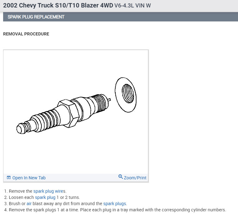

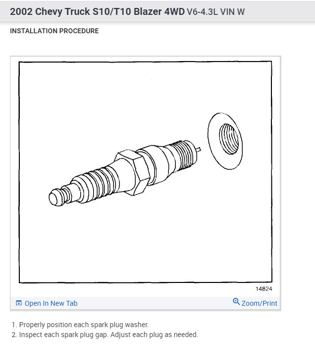

Regardless of the engine code the spark plug gap is 0.060 inch.
Just so you know the eight digit (from the left) of the VIN is the engine code.
https://www.2carpros.com/articles/how-to-change-spark-plugs
I have attached the spark plug replacement steps with the torque specifications below.
Thank you.
