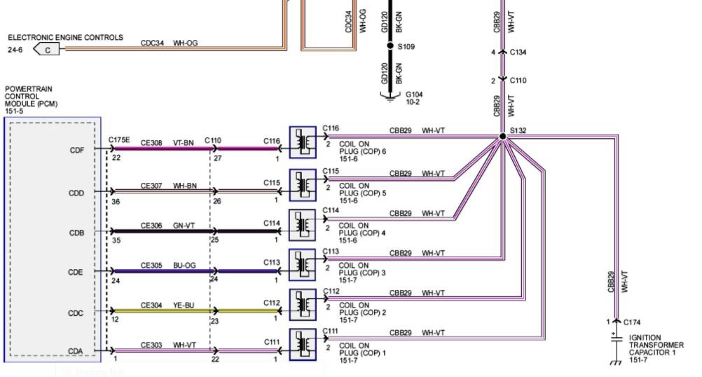

Hi, I had A P0302 code so i have been trying to check it. i have replaced the COP and that did not fix the issue. so then i went into it deeper it seem to have plus twelve volts at the plug and coming from the center plug on the PCM, but i cannot find the ground. i put a test light between the ground at the COP and plus twelve volts battery it when it is supposed to fire it is extremely dim compared to the other working COP. can you please tell me where to locate the ground so i can check for a bad wire?
