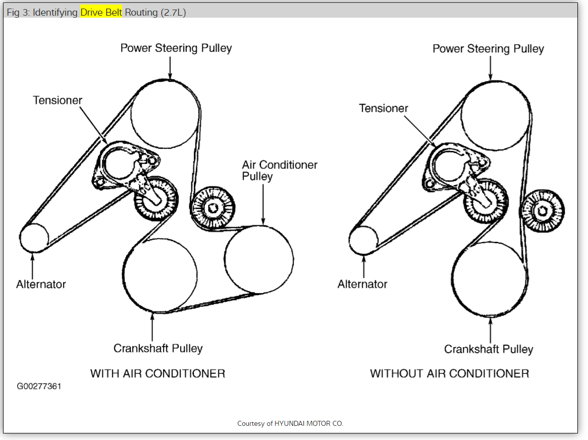

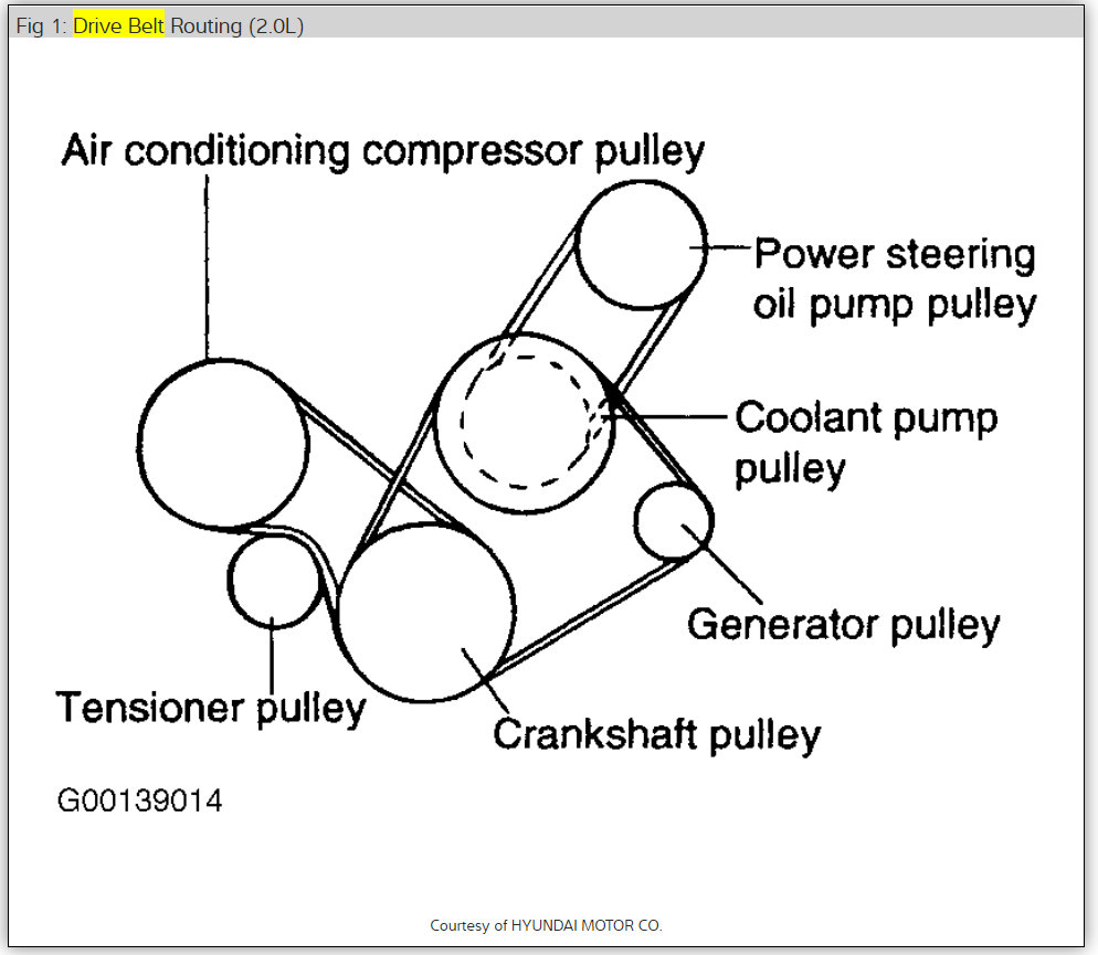

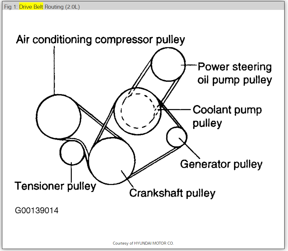

Yep, we are confused because your car does not show a super charger. Here are the belt diagrams for both engine. but I do not see a super charger. Can you get a picture of the engine of us?
Check out the diagrams (below).
Mar 28, 2018 at 7:42 PM
