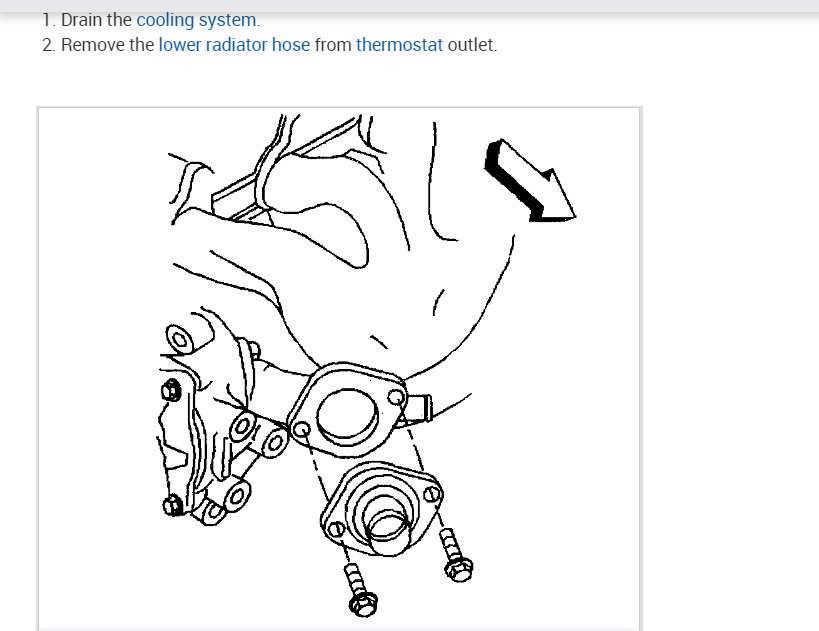

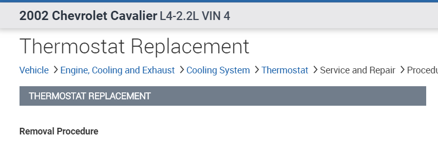

I would like to know if you can help me with my cooling system? when I'm driving my car and my car warms up it still blows out cold air from the heater. When the car starts running hot the heat will blow, but it goes into the red before it starts working. my car heats up pretty quick to 195 and I just got in it and drove it a block away. it should not heat up that fast. I'm getting ready to change the thermostat in it and hopefully that's what it is. If you could please help me narrow it down I greatly appreciate it. But when I turn on the heater and I know my car is warmed up all it does is blow out cold air. And then when my car overheats it blows out hot air. can you help me solve the problem? thank you
