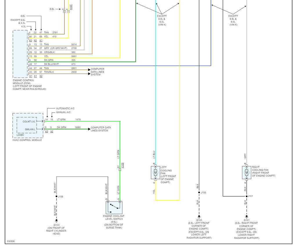

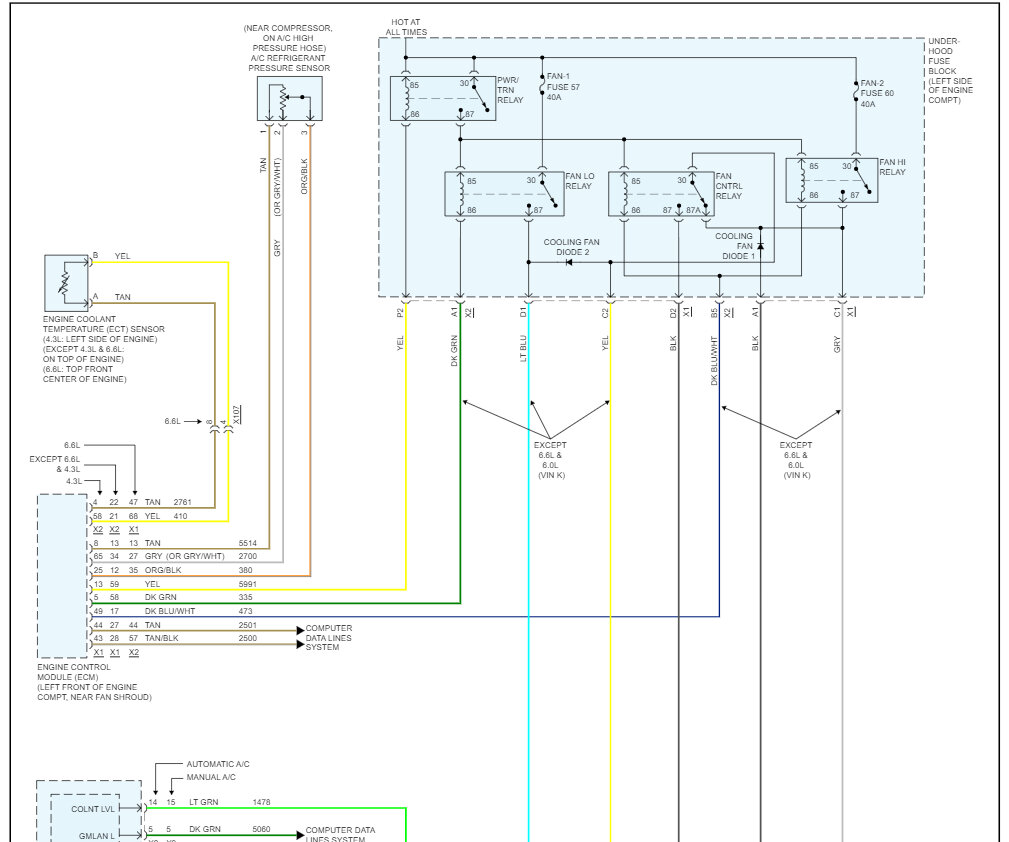

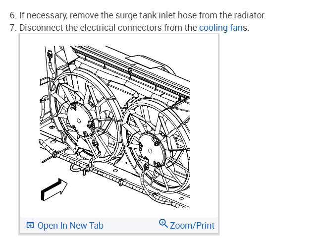

It does sound a little warm, I would make sure both fans are coming on and not just one, also I would use a garden hose to blow out the cooling fins from the front and rear of the radiator.
This guide can help:
https://www.2carpros.com/articles/engine-overheating-or-running-hot

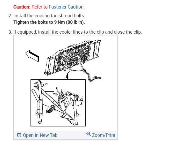

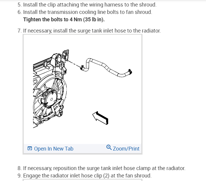

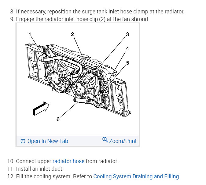

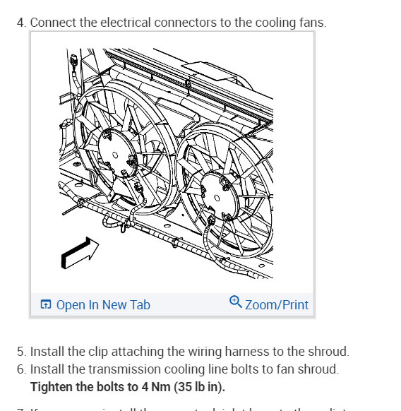

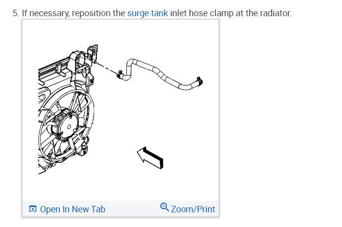

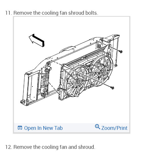

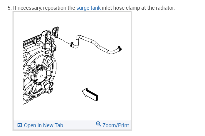

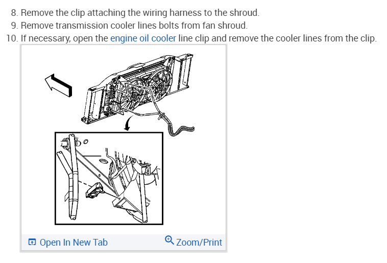

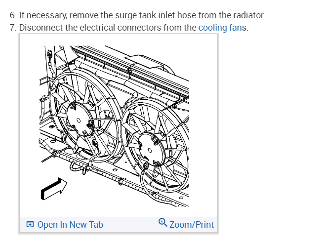

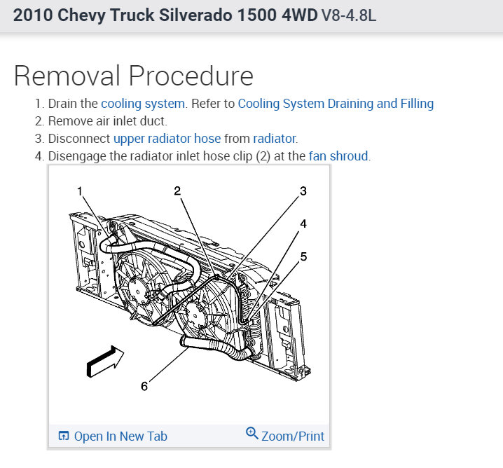

Here are the engine cooling fan wiring diagrams so you can see how the system works and I have included how to change out the cooling fan motors in case one is not working. Check out the images (below). Let us know what happens and please upload pictures or videos of the problem so we can see what's going on.
