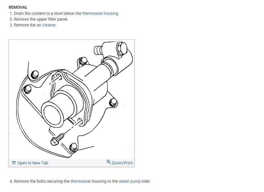

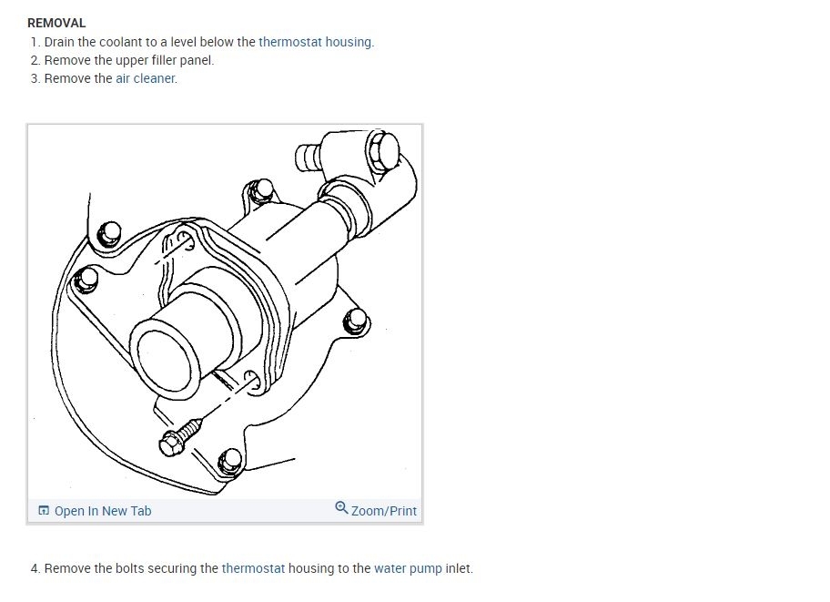

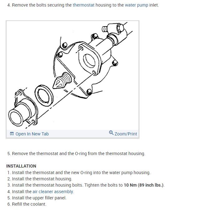

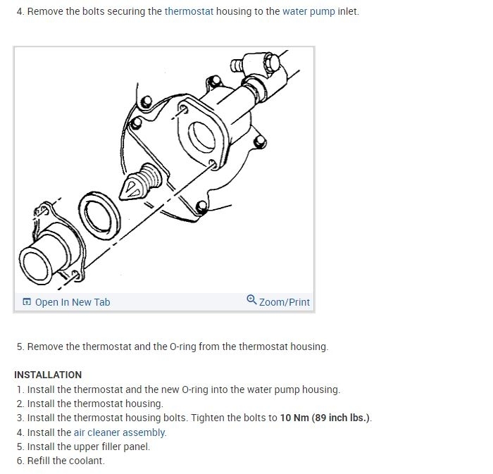

I attached the procedure for you for replacing the thermostat.
https://www.2carpros.com/articles/coolant-flush-and-refill-all-cars

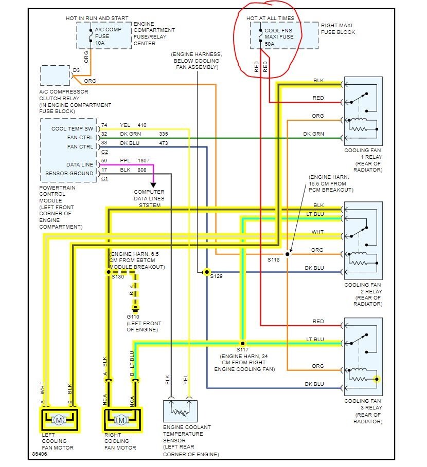

I also attached a wiring diagram for the fans for you if they still do not work.
