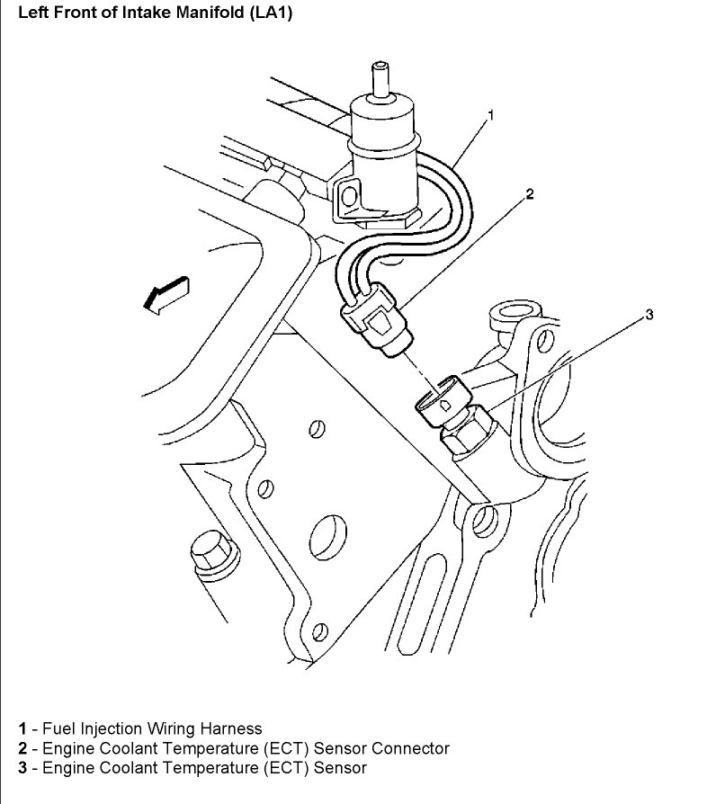

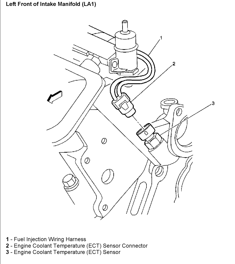

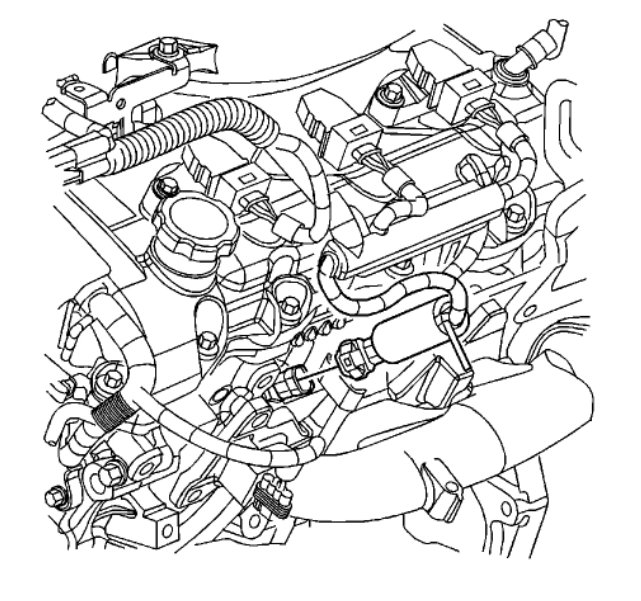

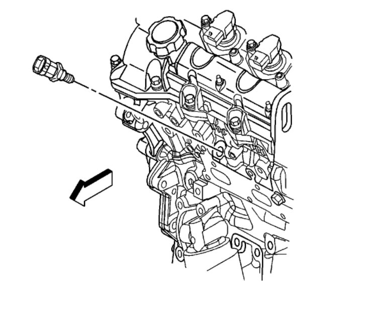

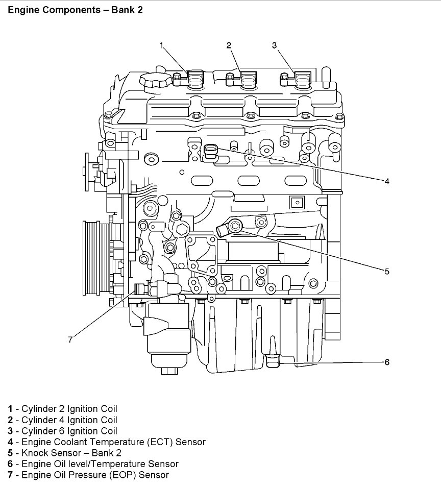

Yep. it sounds like the coolant temperature sender is going out. There is just one for the gauge and the computer. Here is a guide that will help you see what you are in for when doing the job.
https://www.2carpros.com/articles/coolant-temperature-sensor-cts-replacement
Here is what it will be like on your car with the location (below)
