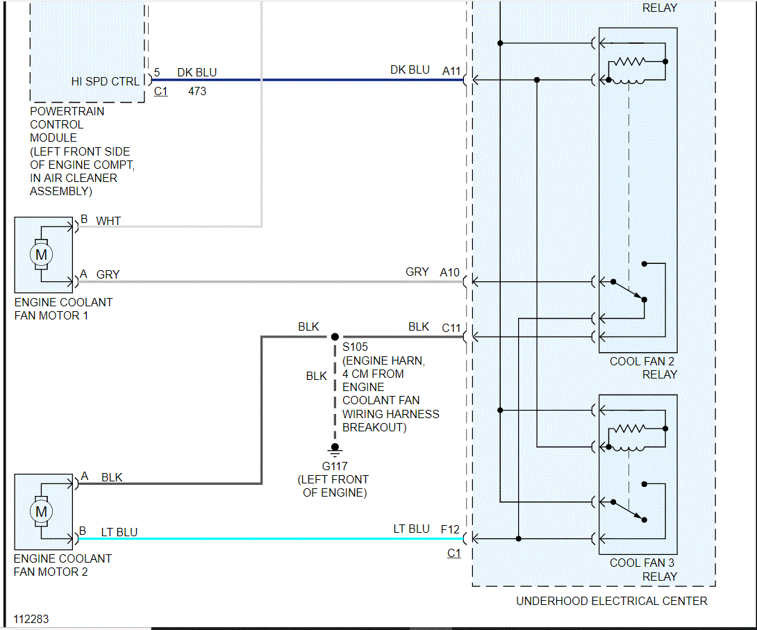

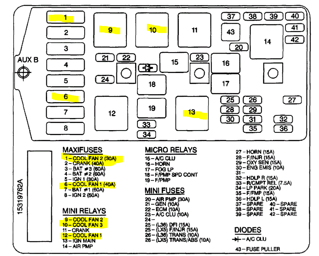

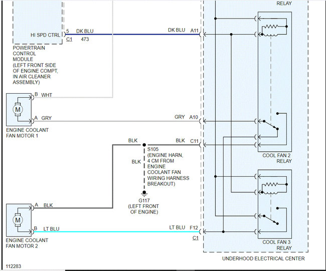

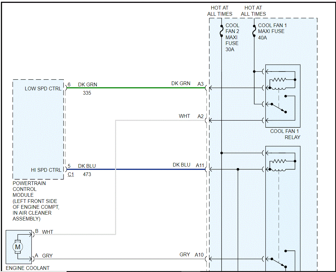

I have the vehicle listed above GL, I just inherited it from my late roommate. I put in a new water pump a new power steering pump new rack and pinion replace the thermostat in the thermostat housing and I'm having the issue with the fans still not coming on. Did a radiator flush. I troubleshooted by checking to make sure there's no shorts in the wires. The fans come on when the air conditioner is engaged, but not any other time. I believe that the temperature control unit is part of the fan which I cannot afford to replace at this time especially since I know that it does work. I realized today that the temperature indicator inside of the car, on the air conditioning unit control board, says that it's 52 degrees outside when it's actually 82° outside. I'm wondering what, if anything this has to do with why my fans don't come on. I'm a woman without anybody to help me with this and I've been using the repair manuals to get me through to this point, but I could really use some good advice from a good mechanic. Please let me know if anybody has any idea of ways I can troubleshoot and finally fix these problems. As I was just looking in the fuse relay area, I noticed that the fan relay is supposed to be 40-amp fuse, but it was a 30-amp fuse. so, I have replaced it and I'm wondering if this could fix it or if there could have been a reason why someone put a 30-amp and a 40-amp spot that I'm not thinking of? Could this cause a problem for me because I've now put a 40-amp fuse in?
