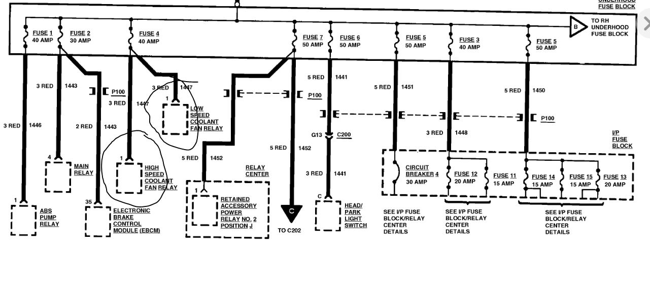

Fans are not engaging, speedometer doesn't register and A/C compressor won't kick on. however, if you drive it every now and then they will all try to engage, but won't stay on. Replaced the relays, thinking electrical but no tell tale signs.
Sep 11, 2019 at 7:44 AM
Okay, the one thing that is in common to all these issues is power. The power comes from the fuse block. The under hood fuse block feeds the cooling fans the one inside the car feeds the other 2 systems. The power for the Ac and the speedometer comes from the under hood fuse block to the inside fuse block.
Run the engine and open the hood. Hit on the fuse block under the hood and see if anything start to work. It may be a bad fuse block.
