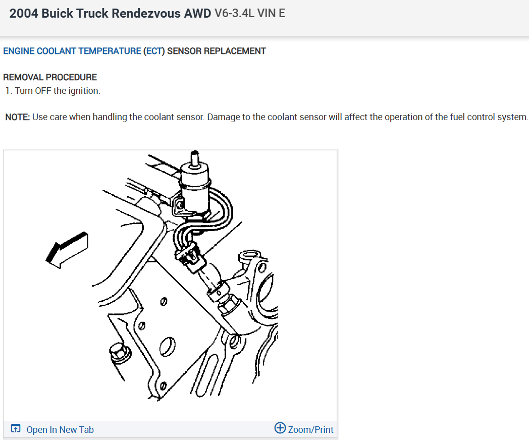

Usually this will be a bad engine coolant temperature sensor. Here is the location and how to change it out so we can be on the same page. Check out the images (below). Please let us know what happens.

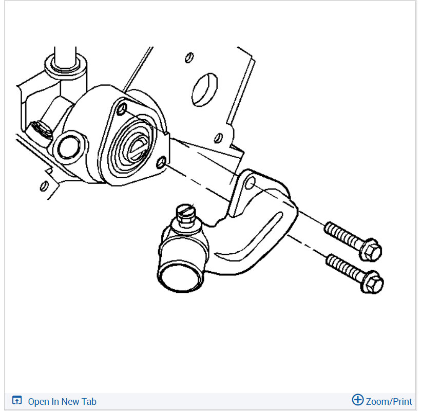

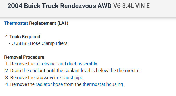

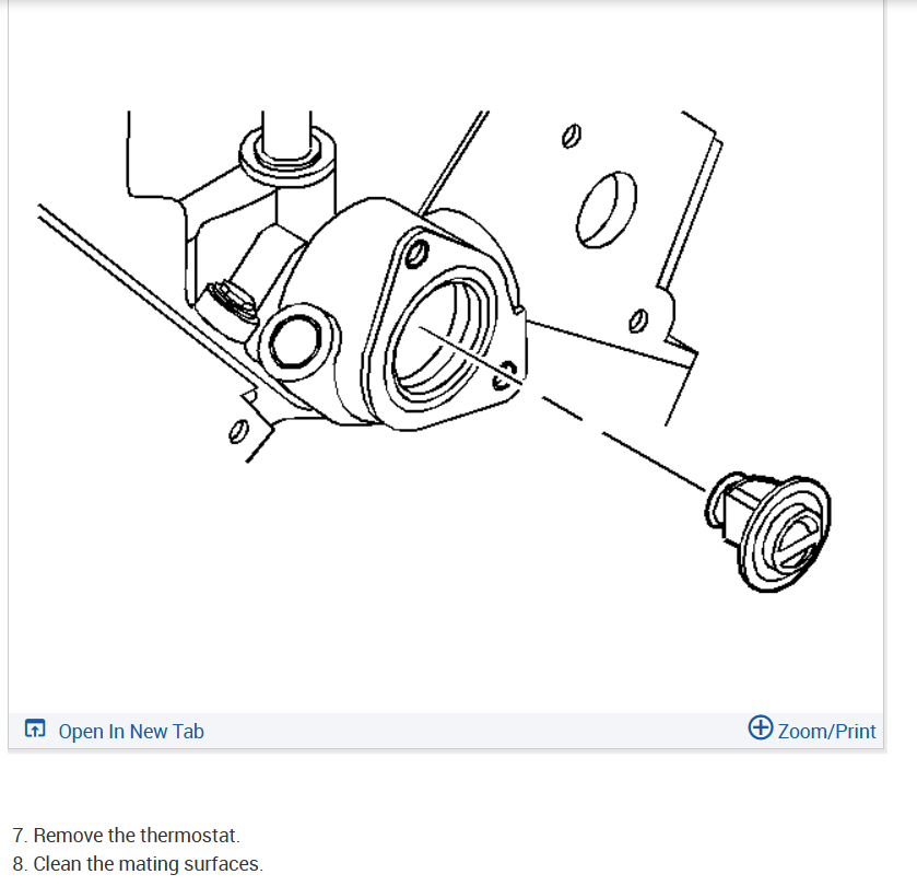

So, the engine overheats while the cooling fan are running? I have seen a stuck thermostat cause this issue. Here is a guide to go over to help understand what's going on and i have included how to change the thermostat out. Check out the images (below). Please upload pictures or videos in your response of any problems so we can see what to help you with.
