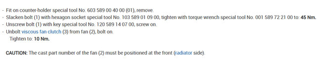

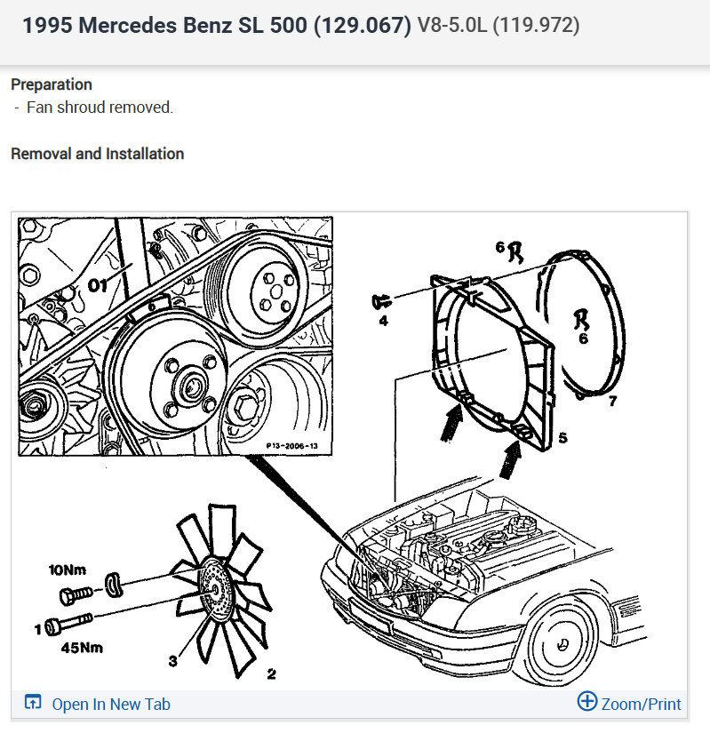

Is the 8mm Allen bolt reverse thread.
Feb 2, 2025 at 8:03 PM
CERTIFIED EXPERT
53,854 POSTS

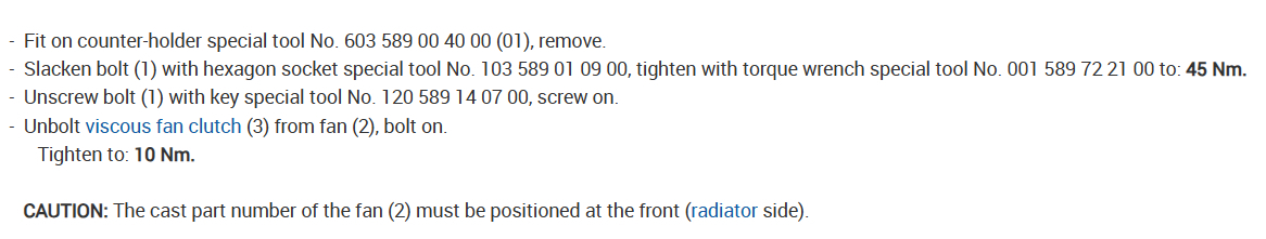

I dont think so and it does not say it is in the removal instructions below. Check out the images (below). Please upload pictures or videos in your response of any problems so we can see what to help you with.
