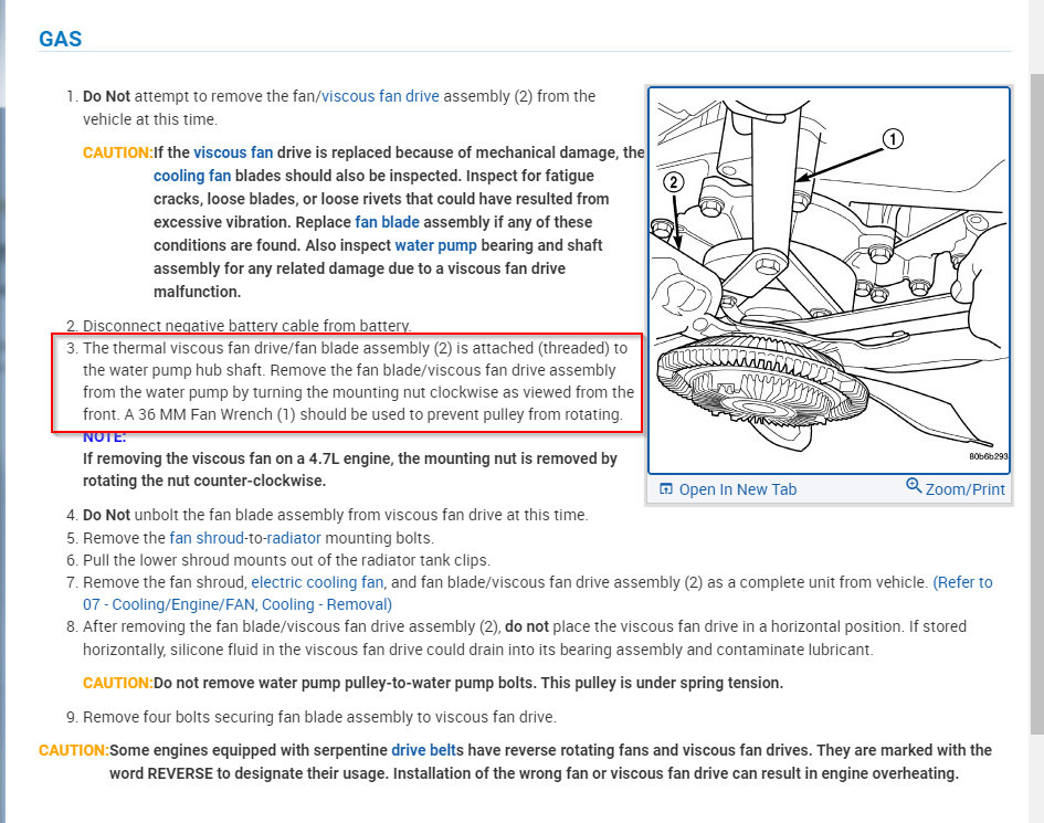

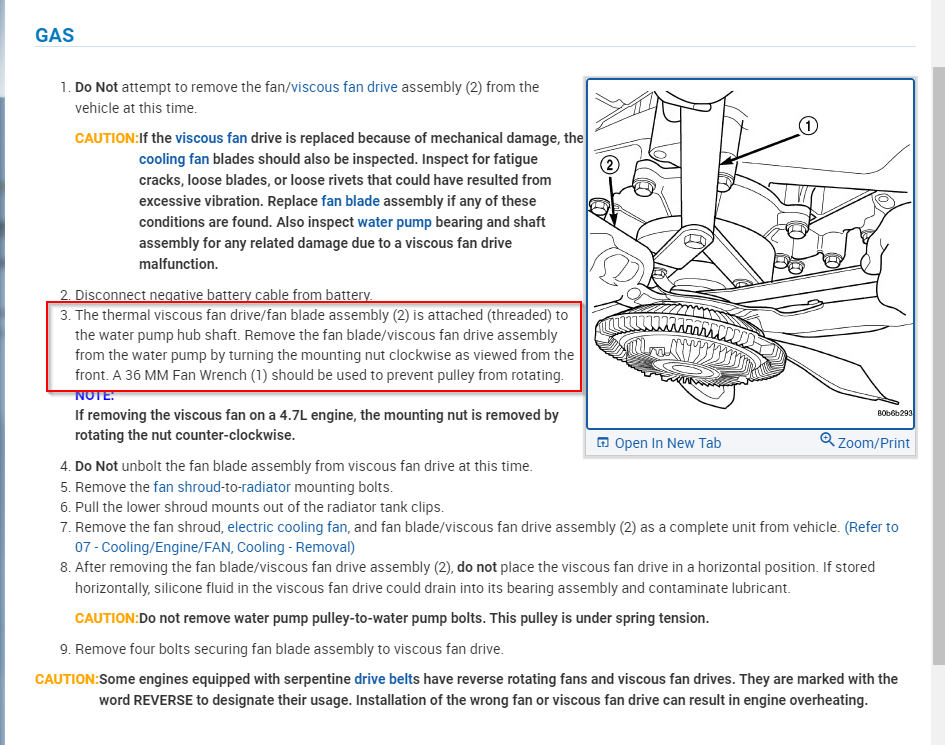

Then when you try to loosen it again you should be able to get it. I attached the instructions which you appear to have correct, just to make sure you are oriented correctly. Basically you turn it clockwise when looking from the front of it.
