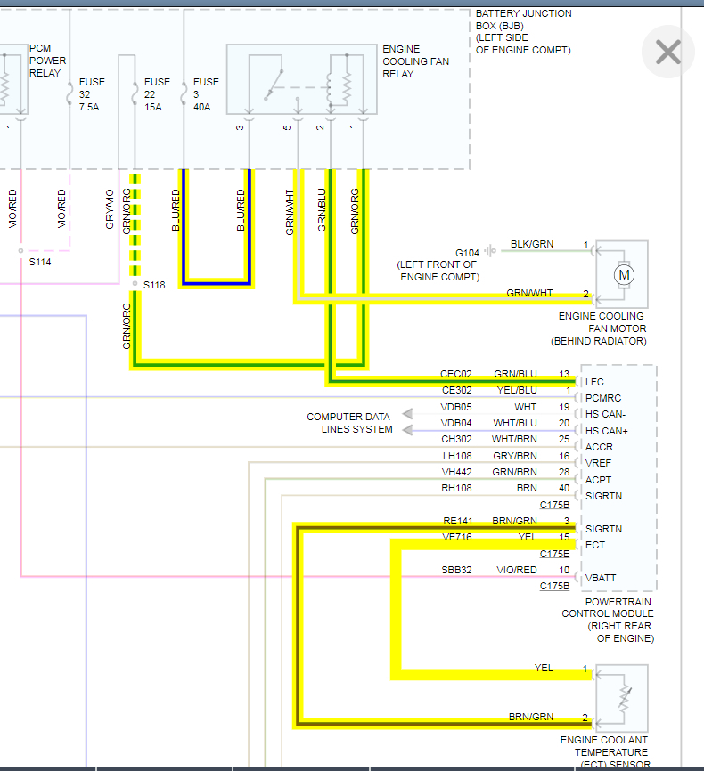

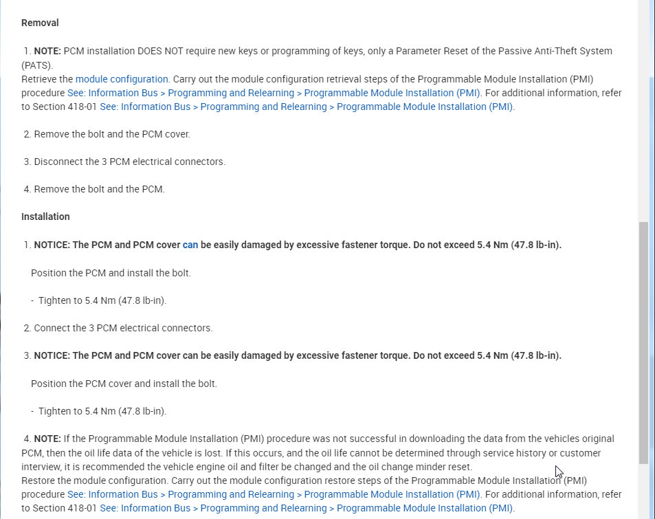

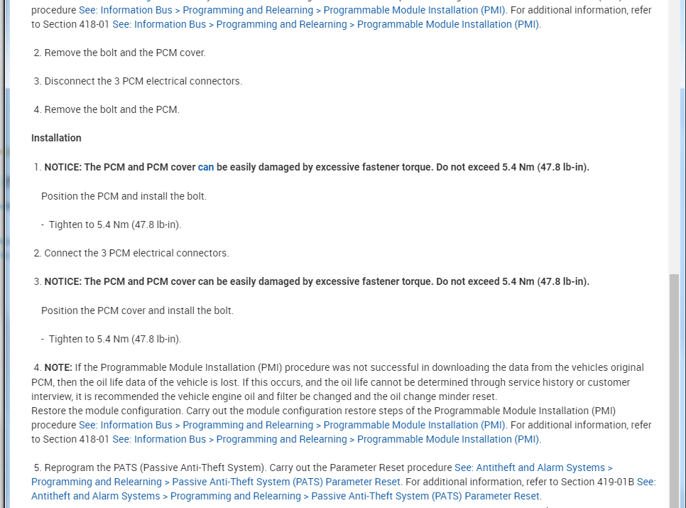

I've changed the thermostat and the temperature sensor. i have changed the relays and fuses related with the cooling system. i have checked the fan itself and that resistor attached to the fan direct at the battery and they both work.the fan does not start when the engine overheats or when i turn on the A/C but if i disconnect the temperature sensor from the thermostat the fan starts right away. If is the PCM module do i get away with an update or do i have to replace it? Everything else works fine, no engine management displayed, no increased fuel consumption. Or can be any wiring from the PCM to the fuse box?
