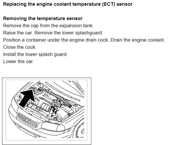

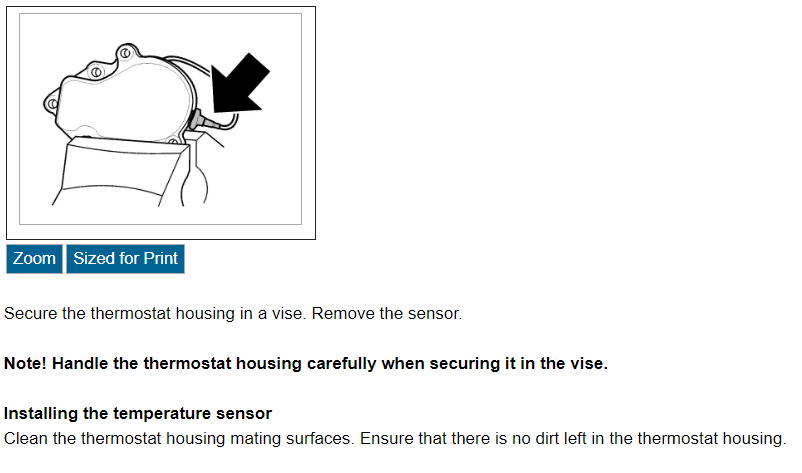

Here is a guide to show others that visit the post what you are in for when changing the sensor out:
https://www.2carpros.com/articles/coolant-temperature-sensor-cts-replacement

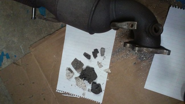

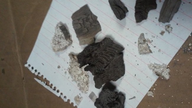

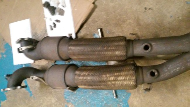

My daughter and I heard a noise nobody wants to hear when I started the car. The dreaded sound of an empty aluminum can with several pull tabs rattling under your car. No its was not a midget under the car rattling a can, It is the beloved sound of your honeycomb baffle in your catalytic converter disintegrating, separation, collapsed, bye, bye.

Ken, I'm a bit late on the reply, but it was the cooling fan that was the issue. it was from a S60 and not a S80-2.9T. Problem resolved with a new OEM Fan and Bosal OEM Compatible Cat Converter Assembly.
