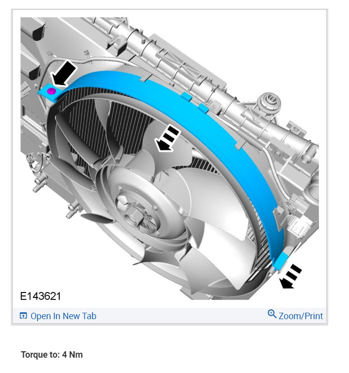

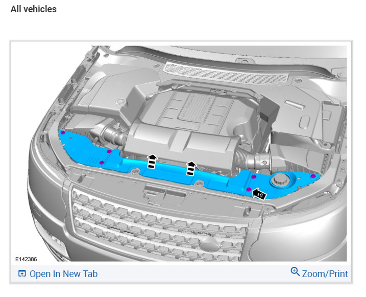

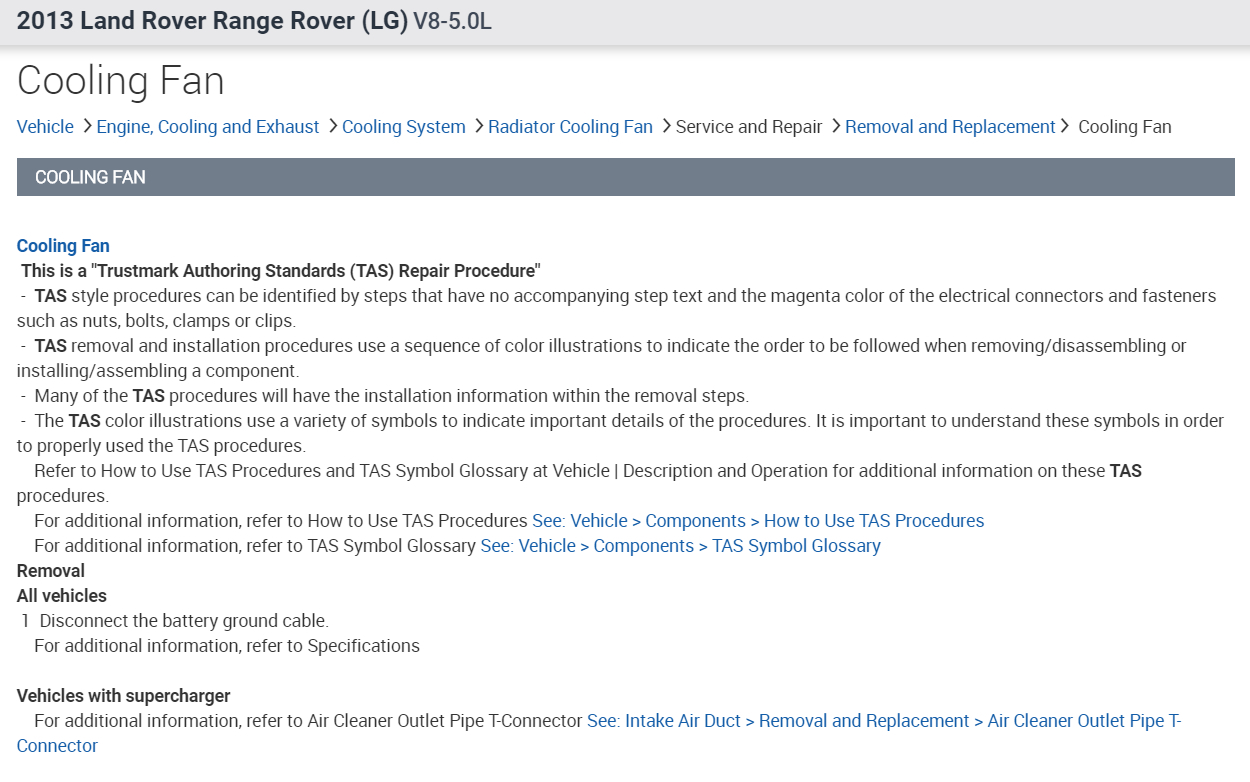

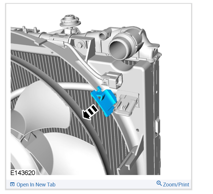

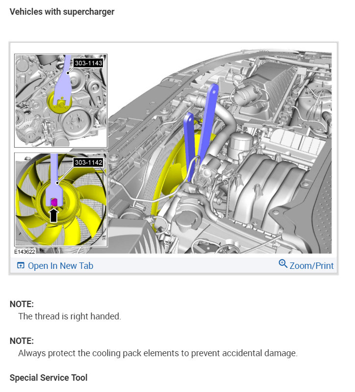

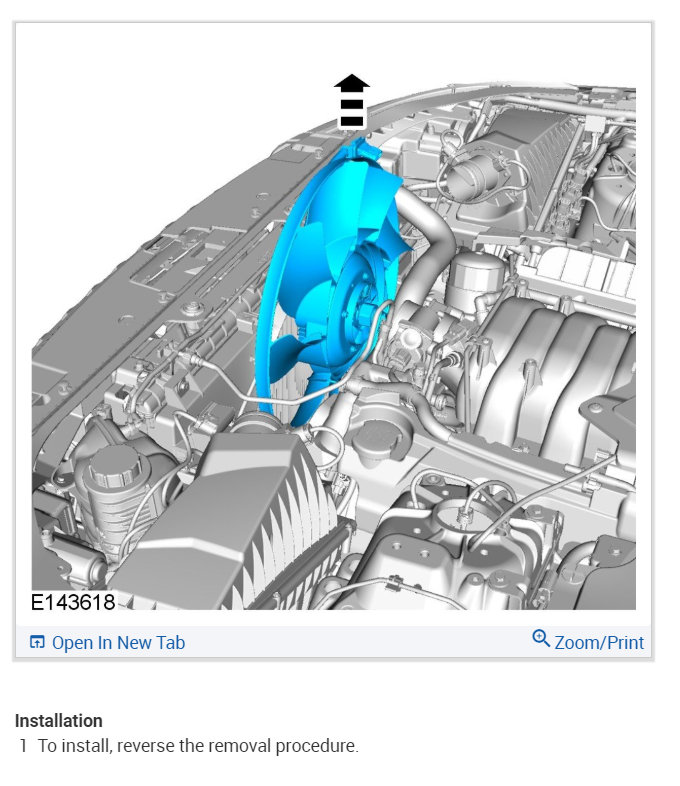

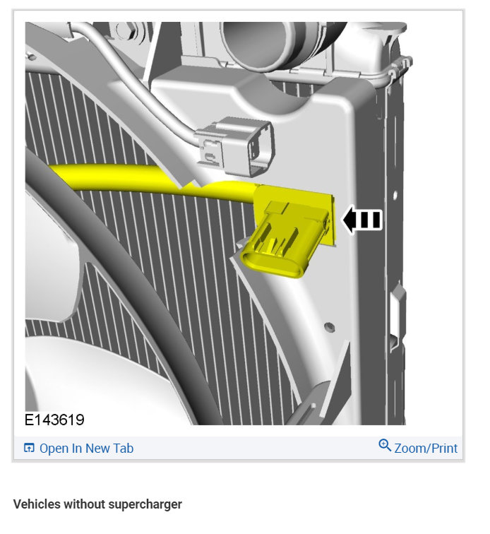

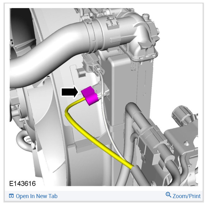

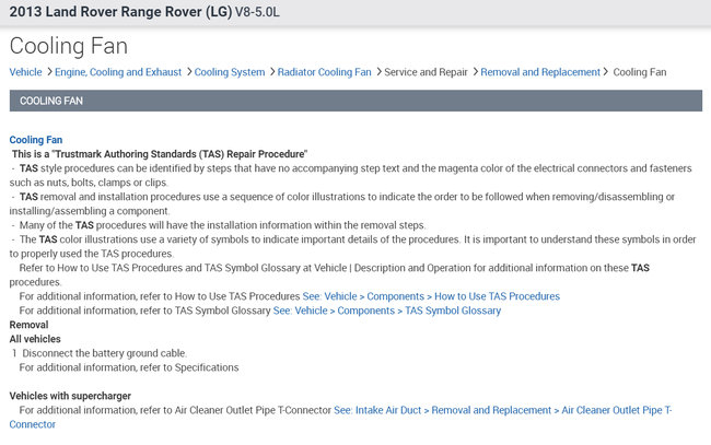

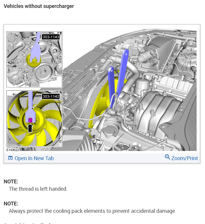

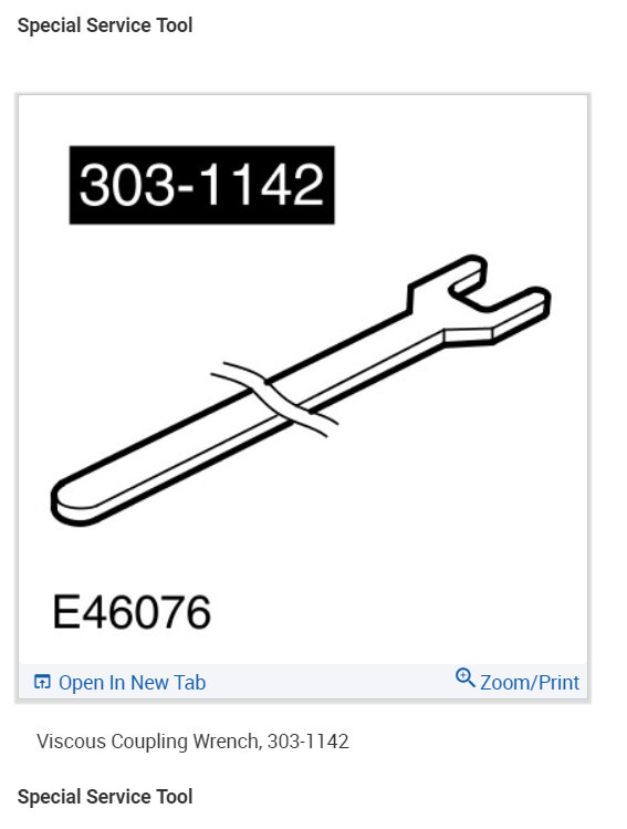

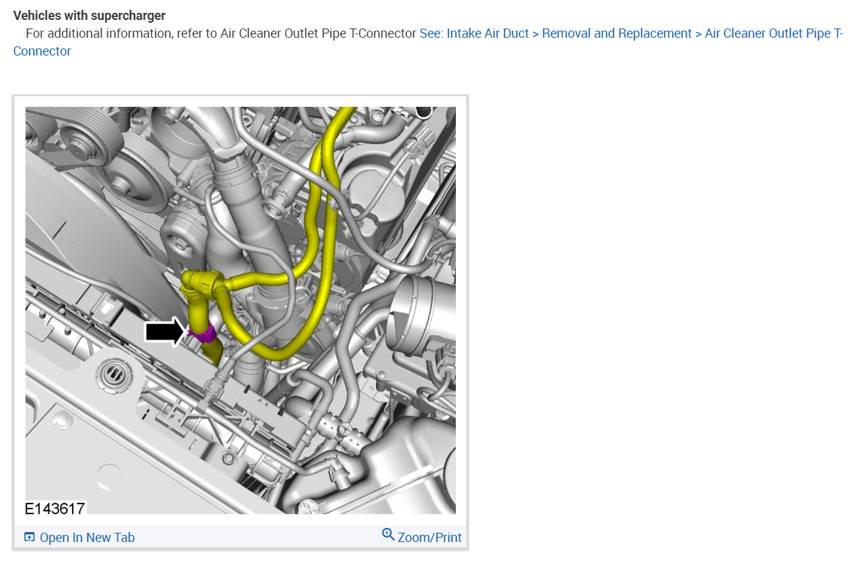

It sounds like the electric fan clutch has gone out which is common. here are instructions and diagrams to help you replace the part (below) and a video to help show you how to do the job on a different car.
https://youtu.be/N_-MLVlBHk8
