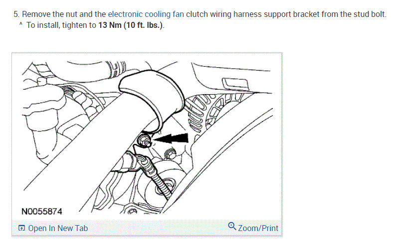

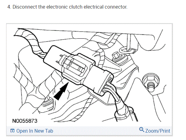

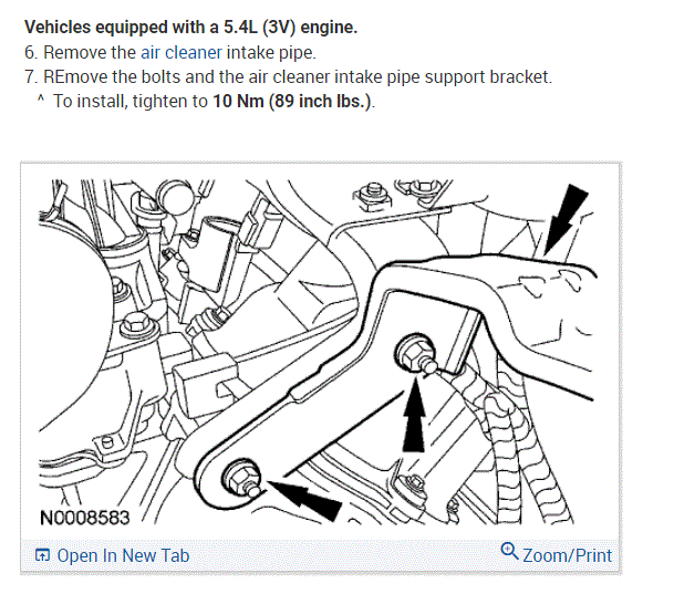

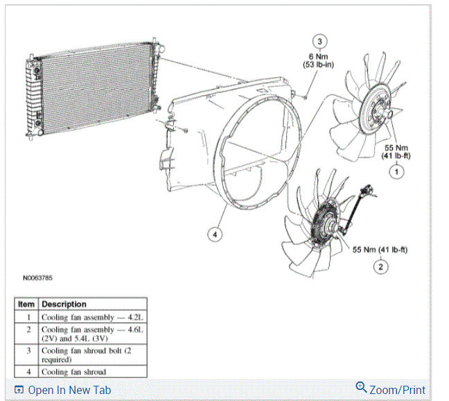

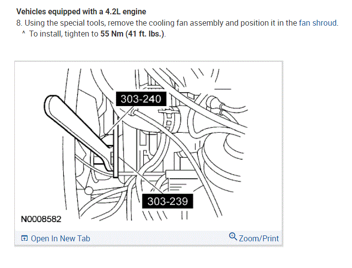

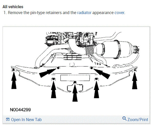

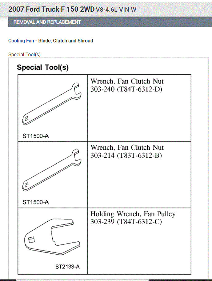

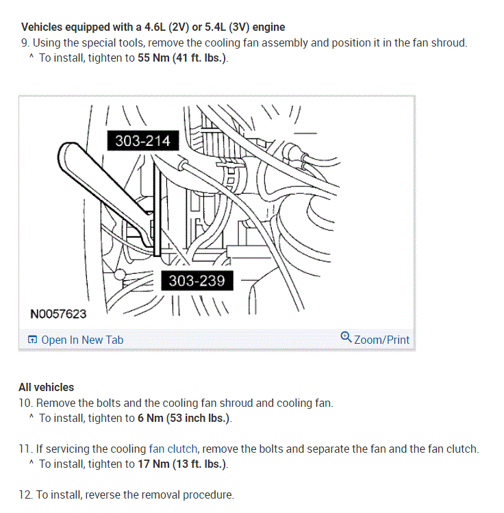

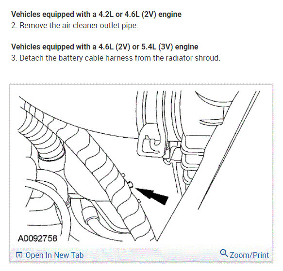

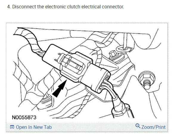

If you look at the pics below, they include directions specific to this vehicle.
Note: There are special tools required to perform the procedure. However, most parts stores will lend them to you.
I hope this helps. Let me know if you have other questions and how things turn out for you.
See pics below.
