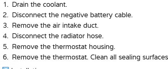

is the thermostat in the block where the top radiator hose connects?

instructions in picture shows how to replace it. It should be under top radiator hose.
Here is a guide on how to change it.
