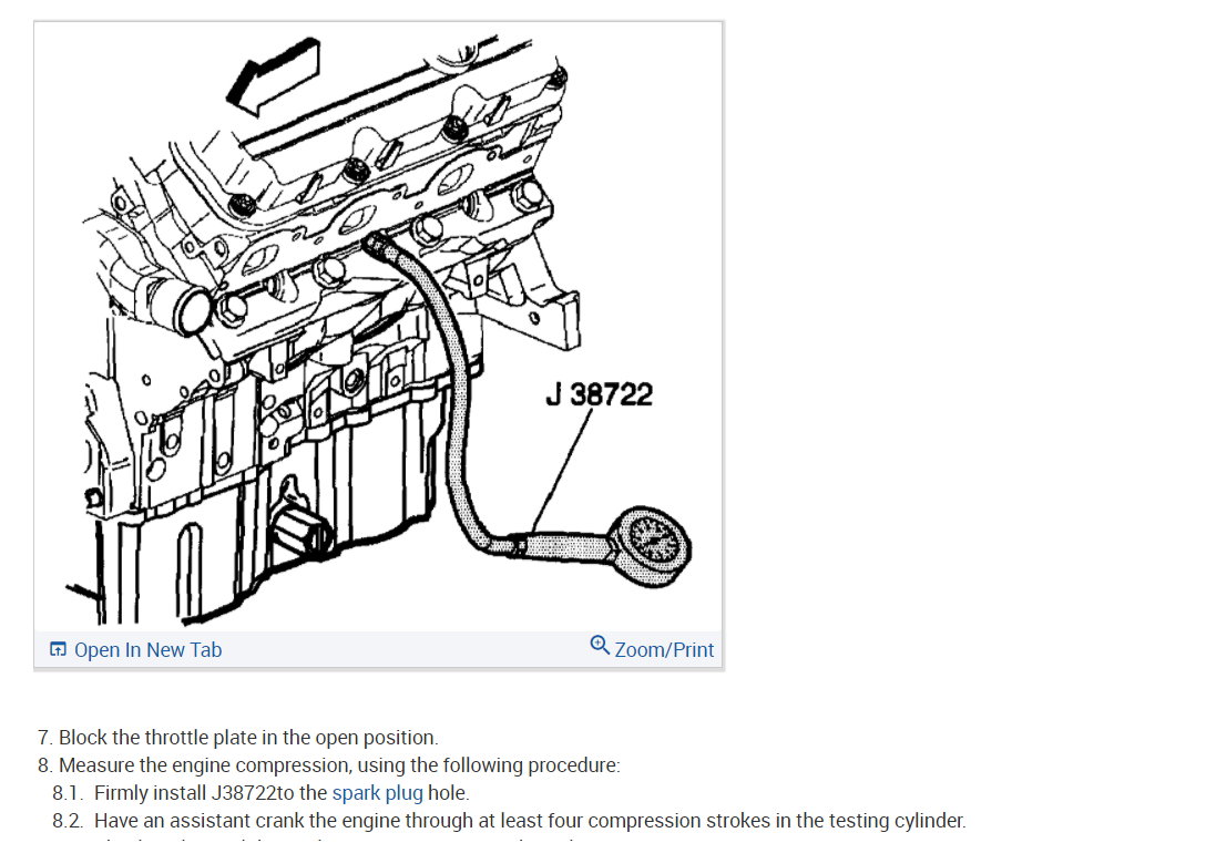

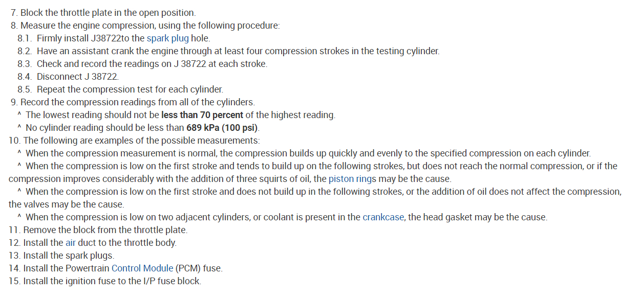

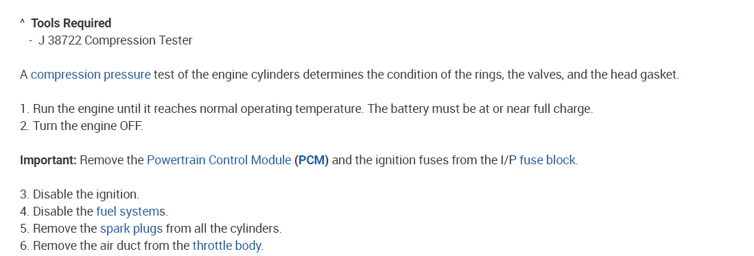

Good afternoon,
When you had the heads off, did you have them checked for being warped or cracks?
You may still have a head gasket issue. The fact it builds up pressure quickly tells me that. You need to have a leak down test done to verify. You also should have replaced all the head bolts during the repair.
