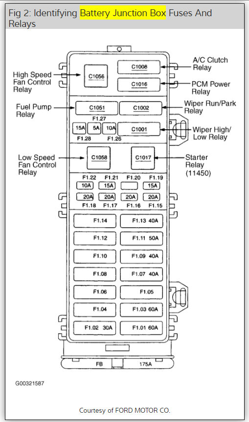

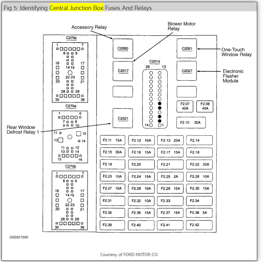

The location cooling fan relay
Jan 16, 2016 at 3:26 PM
CJ MEDEVAC
  • 11,004 POSTS

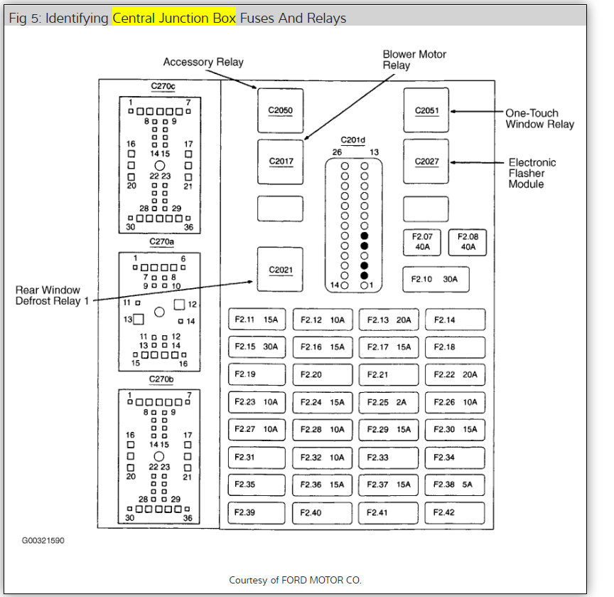

There are two relays one high one low speed. Here is a guide to help you test the replay once you find it from the diagrams below.
