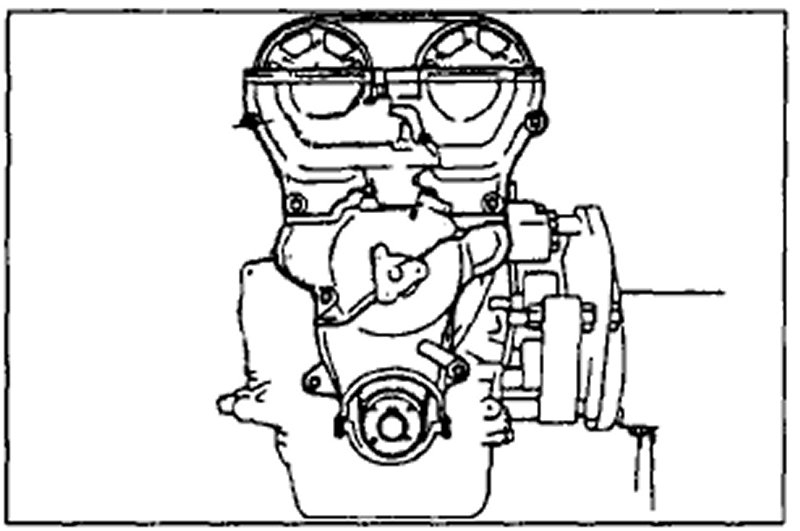

Timing Belt Removal

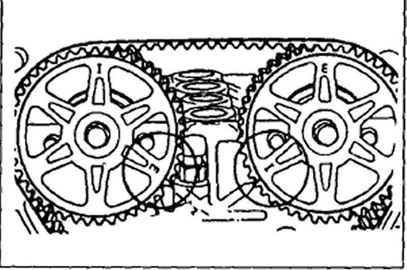

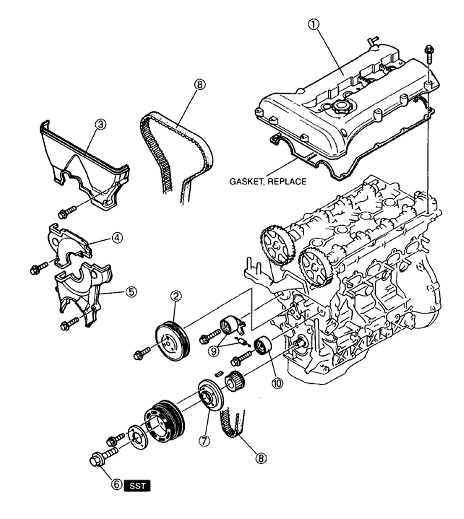

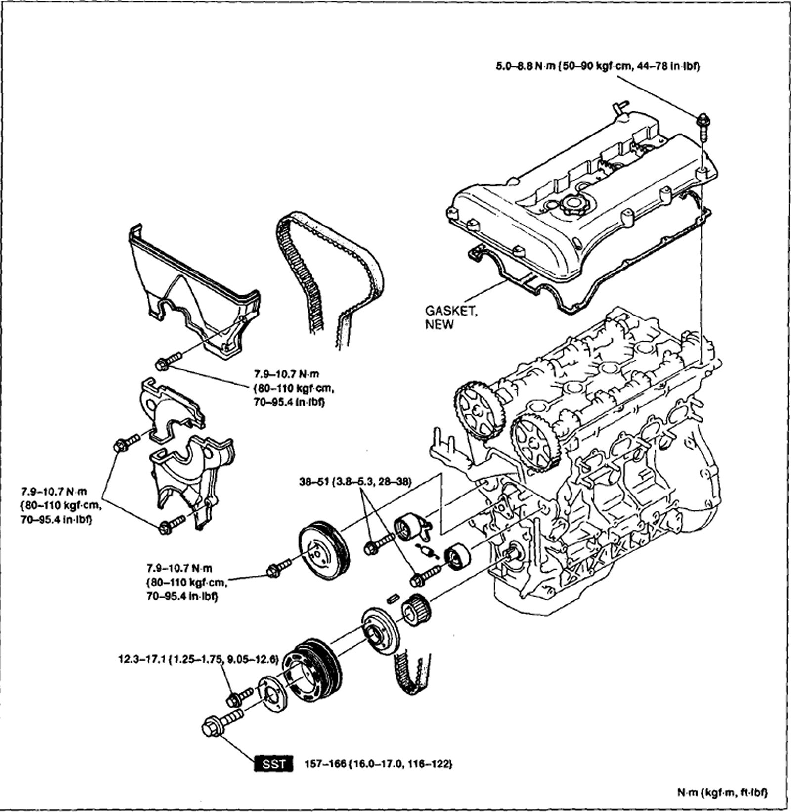

Disassemble in the order shown in the figure, referring to Disassembly Note.
pic 1
1. Cylinder head cover
2. Water pump pulley
3. Timing belt cover, upper
4. Timing belt cover, middle
5. Timing belt cover, lower
6. Pulley lock bolt (disassembly note)
7. Pulley boss
8. Timing belt (disassembly note)

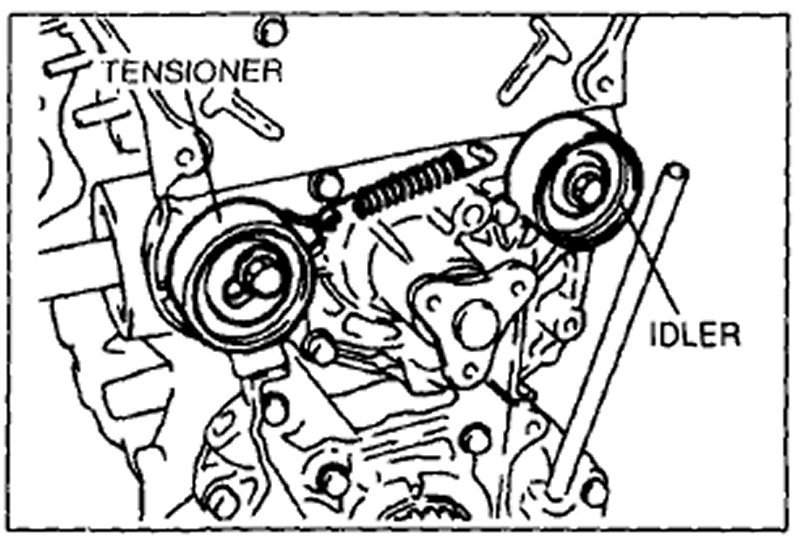

9. Tensioner and tensioner spring
10. Idler

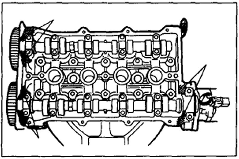

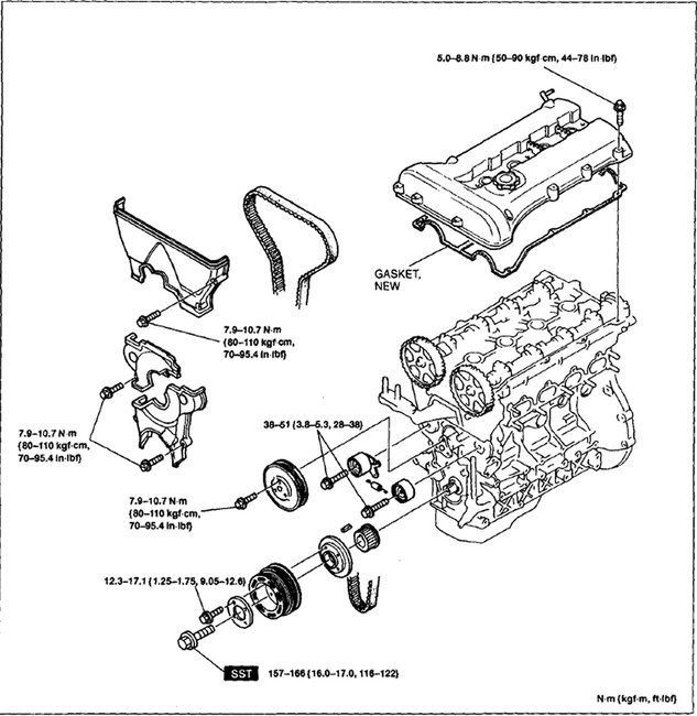

pic 2
Disassembly Note:

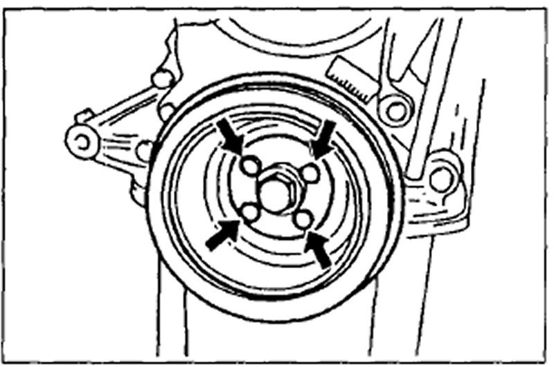

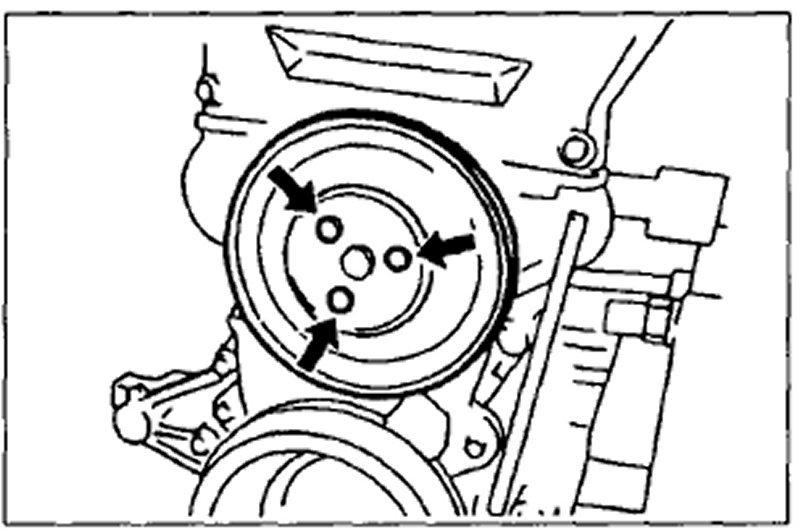

Pulley lock bolt

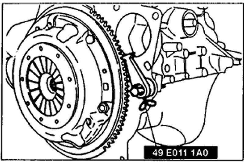

1. Hold the flywheel (MTX) or drive plate (ATX) by using the SST.
2. Loosen the pulley lock bolt.
3. Remove the pulley lock bolt.

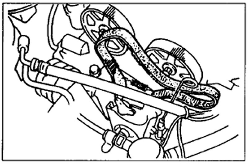

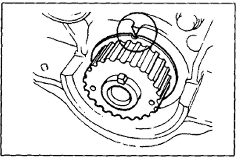

Timing belt

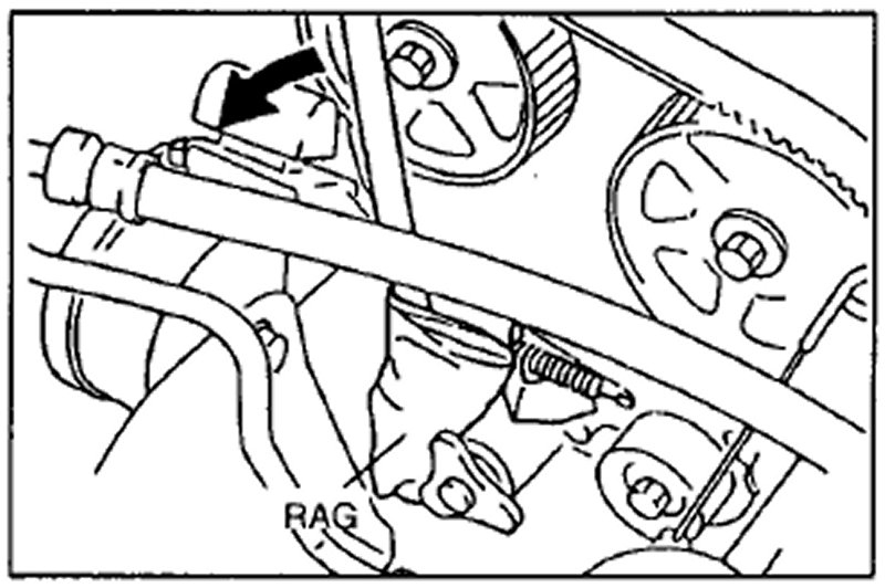

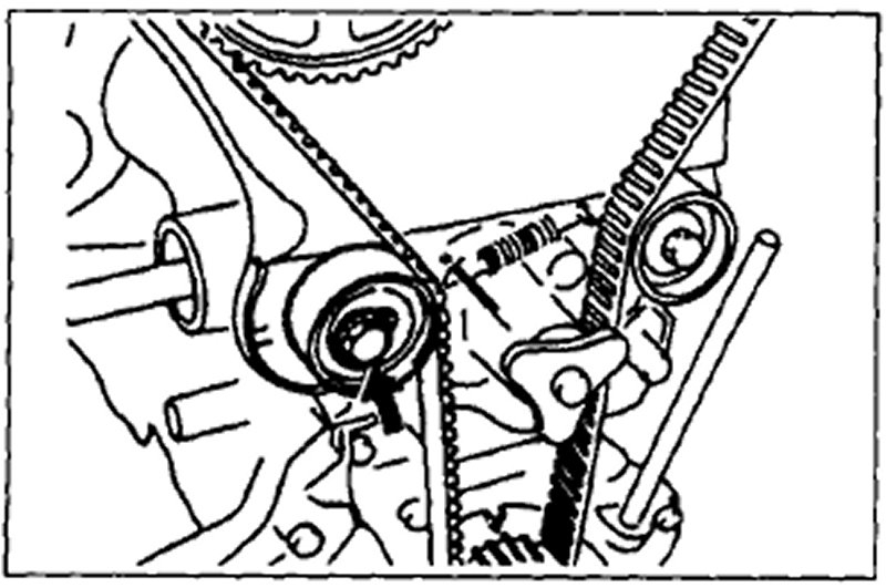

1. Protect the tensioner with a rag.
2. Loosen the tensioner lock bolt. Pry the tensioner outward with a bar.
3. Tighten the lock bolt with the tensioner spring fully extended.
pic 4

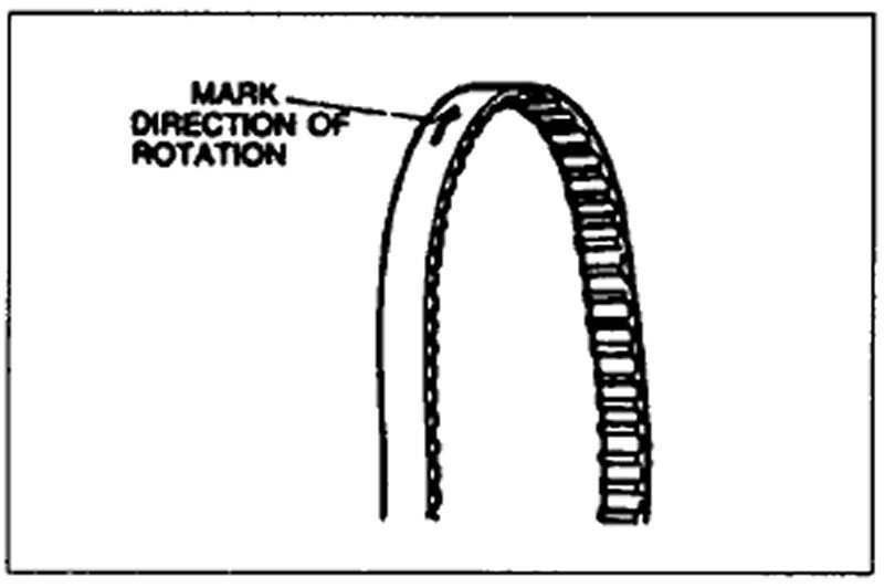

4. Mark the timing belt rotation for proper installation.
pic 5
5. Remove the timing belt.

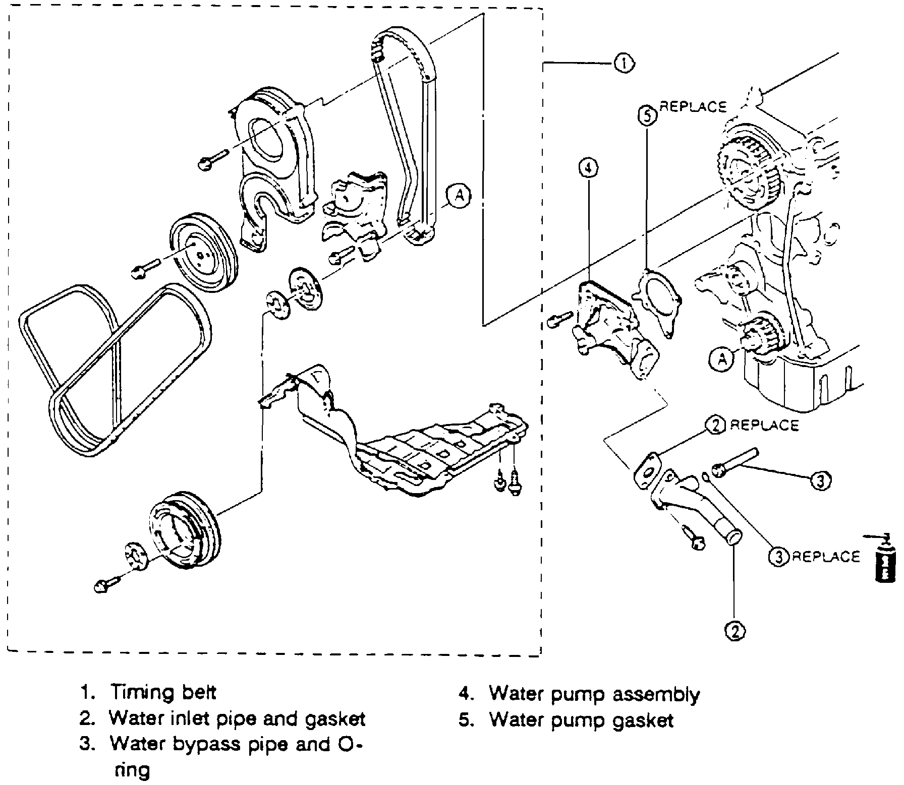

Water Pump Replacement
1995 Mazda MX-3 L4-1598cc 1.6L DOHC
Procedures
Vehicle Engine, Cooling and Exhaust Engine Water Pump Service and Repair Procedures
PROCEDURES

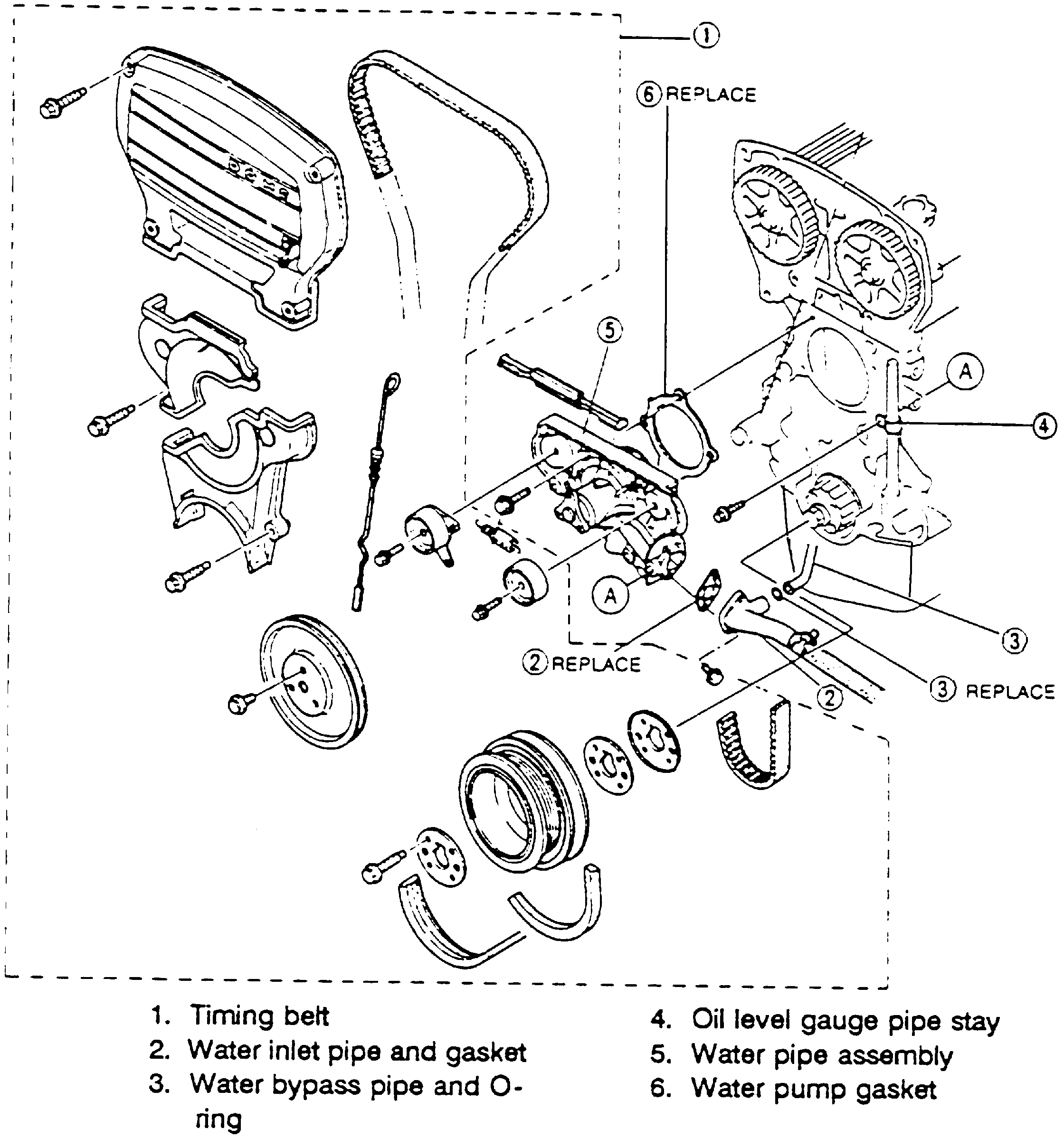

1. Remove timing belt as outlined under Timing Belt, Replace.
2. Remove water inlet and bypass pipes.
Fig. 84 Water Pump Replacement
pic 6
Fig. 85 Water Pump Replacement
pic 7
3. Remove water pump mounting bolts, then water pump, Figs. 84 and 85.
4. Reverse procedure to install. Tighten mounting bolts to specifications.

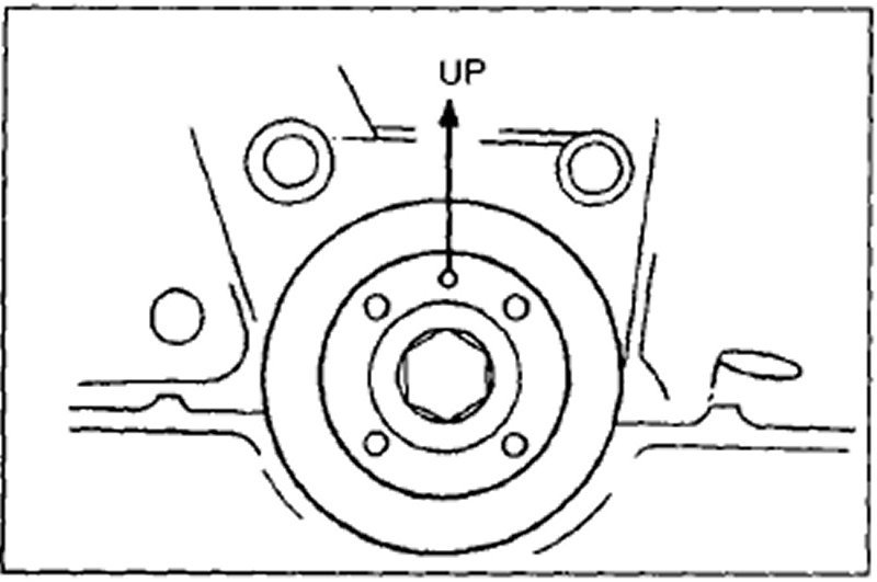

5. Turn the crankshaft two turns clockwise and face the pin on the pulley boss upright. Do not turn the crankshaft counterclockwise.
6. Verify that the camshaft pulley marks are aligned with the seal plate marks. If not, remove the timing belt and repeat from tensioner installation.

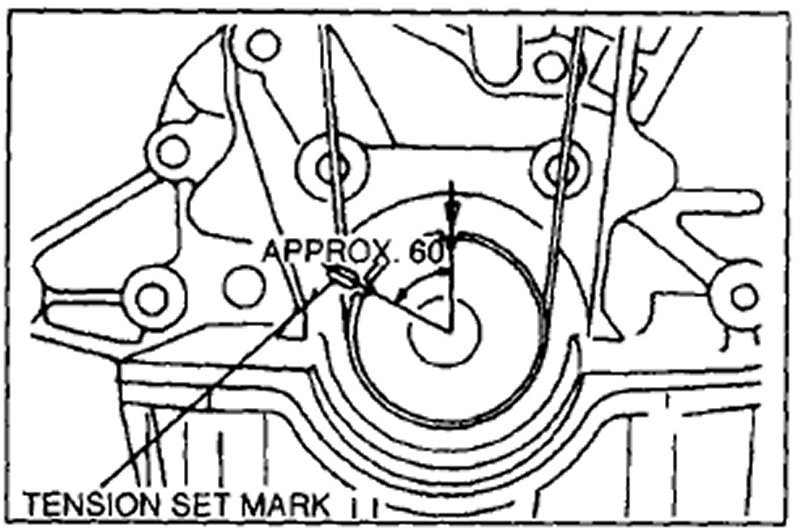

7. Turn the camshaft 1 and 5/6 turns and align the timing belt pulley mark with the tension set mark for proper timing belt tension adjustment.
pic 14

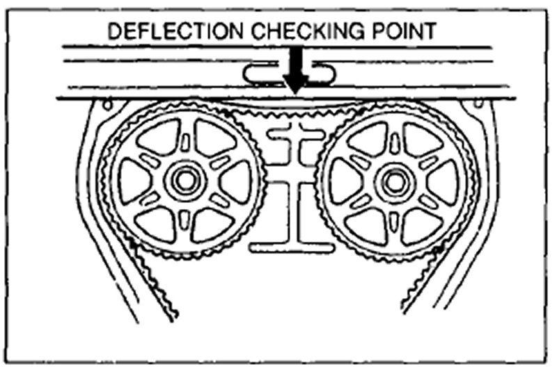

11. Measure the timing belt deflection by applying moderate pressure 98 N [1 0 kgf, 22 Ibf] midway between the camshaft pulleys. If the deflection is not correct, repeat from step 8 above.
Deflection: 9.5-11.5mm [0.37-O.45 in]

Timing Belt Cover
Install the lower, middle, and upper timing belt covers.
Tightening torque:
7.9-10.7 Nm [80-110 kgf-cm, 70-95.4 in-lbf]
pic 17
Crankshaft Pulley
1. Install the crankshaft pulley.
2. Install the plate and tighten the bolts.
Tightening torque:
12.3-17.1 Nm [1.25-1.75 kgf m, 9.05-12.6 ft-lbf]
pic 18
Water Pump Pulley
Install the water pump pulley and tighten the bolts.
Tightening torque:
pic 19
Cylinder Head Cover
1. Apply silicone sealant to the shaded areas as shown.
2. Install the cylinder head cover.
Tightening torque:
5.0-8.8 Nm [50-90 kgf-cm, 44-78 in-lbf]
