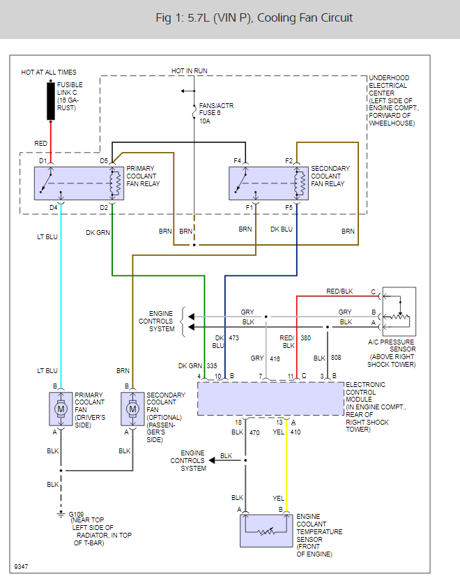

It looks like you have a power issue, Here are some guides that will help you do some testing and a wiring diagram (below) to help you.
and
Please run some tests and get back to us we are interested to see what it is.
Aug 3, 2017 at 12:24 PM

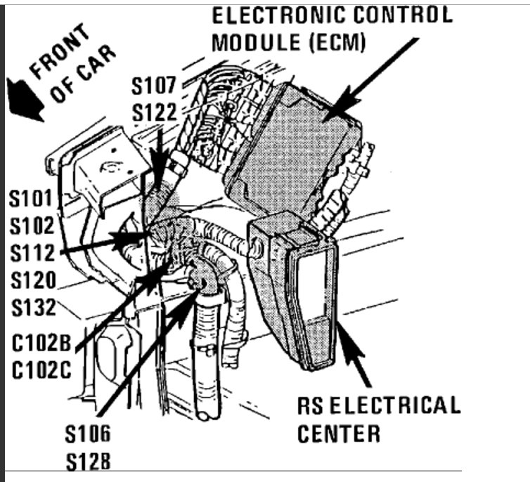

It sounds like the ECM has gone bad which controls the fan. Here is its location (below)
Please let us know what you find.
Aug 5, 2017 at 7:05 PM
