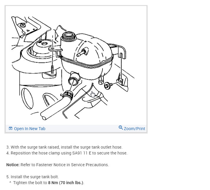

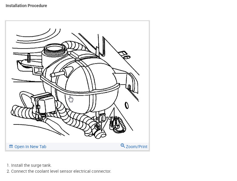

After driving for about 20 to 30 minutes, the dashboard coolant light come on. The fluid in the surge tank is full. The light will go off, by then after 10 minutes come back on. The temperature gauge hand does not indicate that my car is running hot. Am I doing any damage by continuing to drive?
