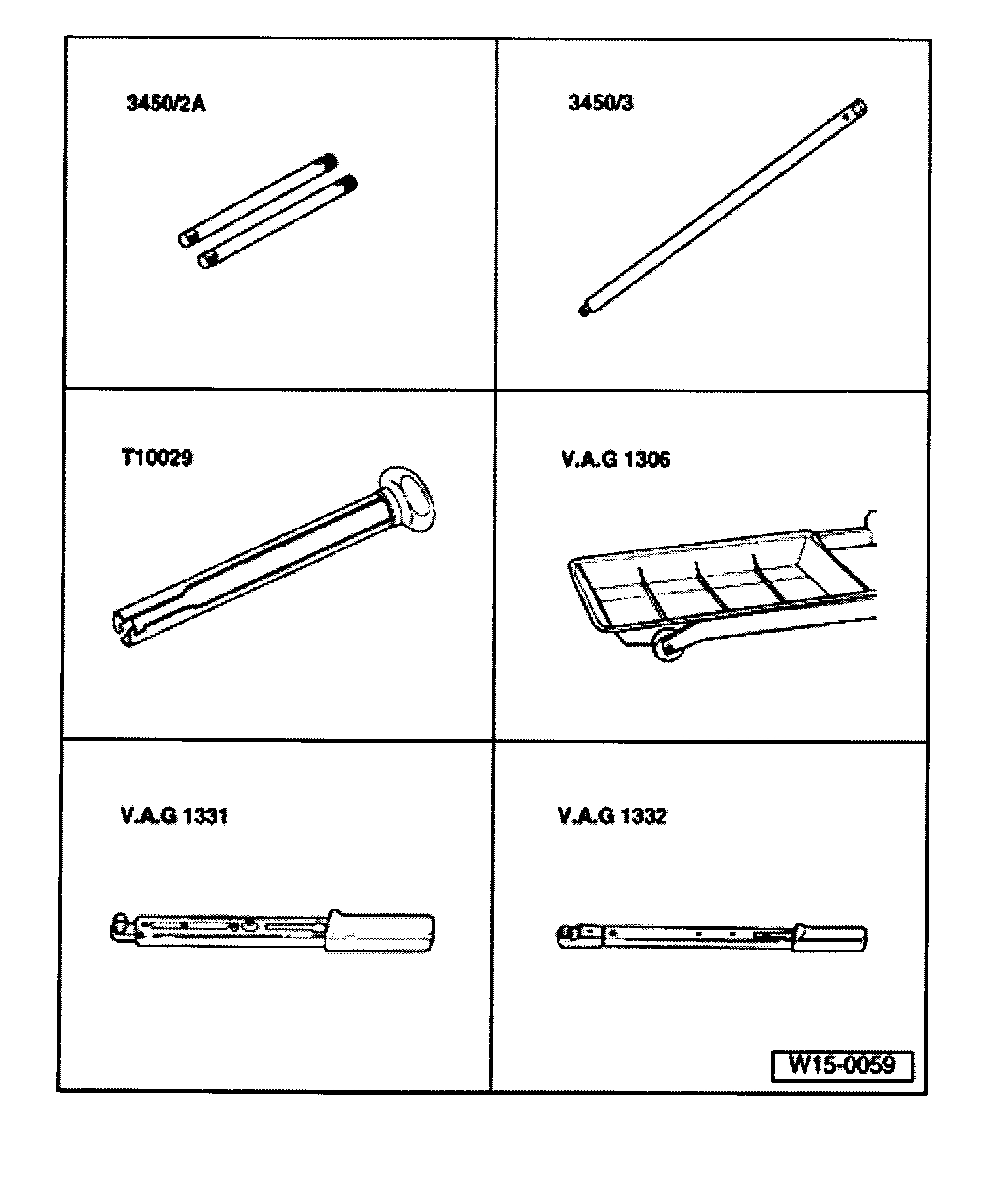

Special tools
Picture 1
^ 3450/2A Guide bolt
^ 3450/3 Extractor
^ T10029 Installation tool
^ V.A.G 1306 Drip tray
^ V.A.G 1331 Torque wrench 5 to 50 Nm (3.7 to 37 ft. lbs.)
^ V.A.G 1332 Torque wrench 40 to 200 Nm (30 to 148 ft. lbs.)

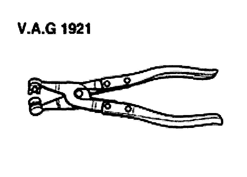

Picture 2
^ V.A.G 1921 or VAS 5024 Spring clip pliers or VAS 5024

- Remove hoses from cylinder head using pliers V.A.G 1921 or VAS 5024.

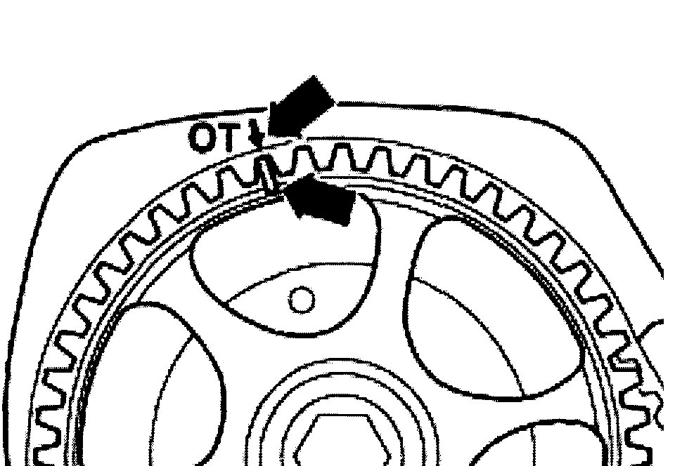

Picture 3
- Turn engine to cyl. 1 TDC (mark on camshaft gear comes into line with mark on toothed belt guard -arrows-).
- Release tensioning roller and take toothed belt off camshaft sprocket.

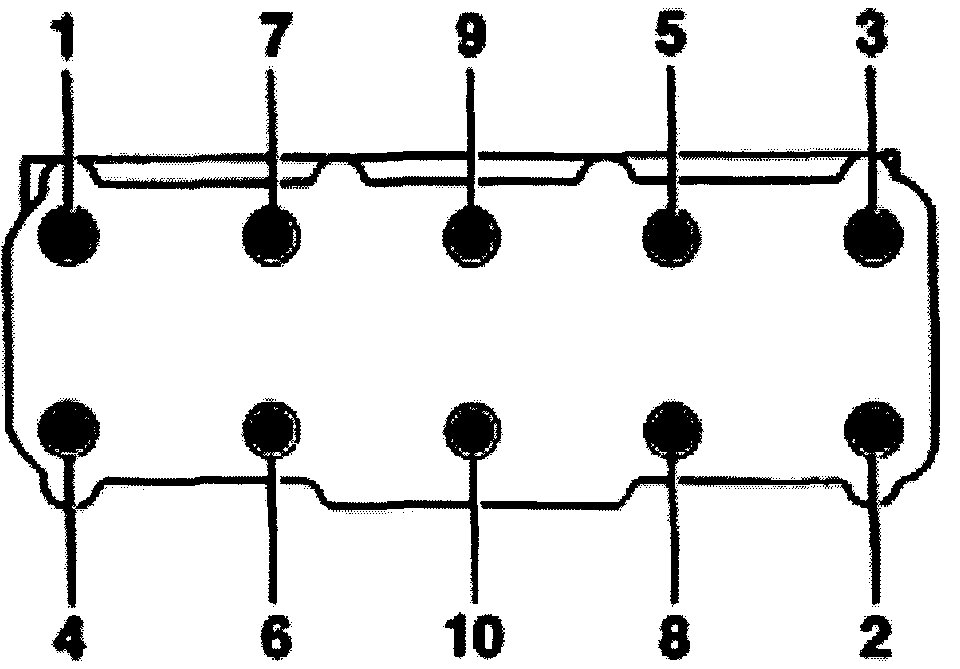

Picture 4
- Loosen socket head bolts in the sequence given and then remove completely.

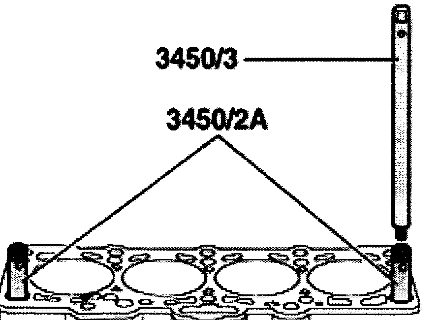

Picture 5
- Center 3450/2A guide pins into head bolt holes as shown.
Note:
- The tolerance of centering bores was restricted in upper section. Check if locating pins can be pulled up before reinstalling cylinder head. Grind knurl of location pins if necessary.
- Install new cylinder head gasket.
^ Lettering (part number) must be readable.
- Install cylinder head, screw in 8 remaining head bolts and tighten by hand.
- Unscrew 3450/2A guide pins through bolt holes using 3450/3 pin driver by turning it counter-clockwise until pins are free.

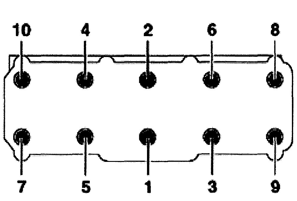

- Tighten cylinder head in sequence as follows:
- Pretighten all bolts to 40 Nm (30 ft. lbs.).
- Tighten all bolts 1/4 turn (90°) further using a box wrench.
- Tighten all bolts a 1/4 turn (90°) further.
