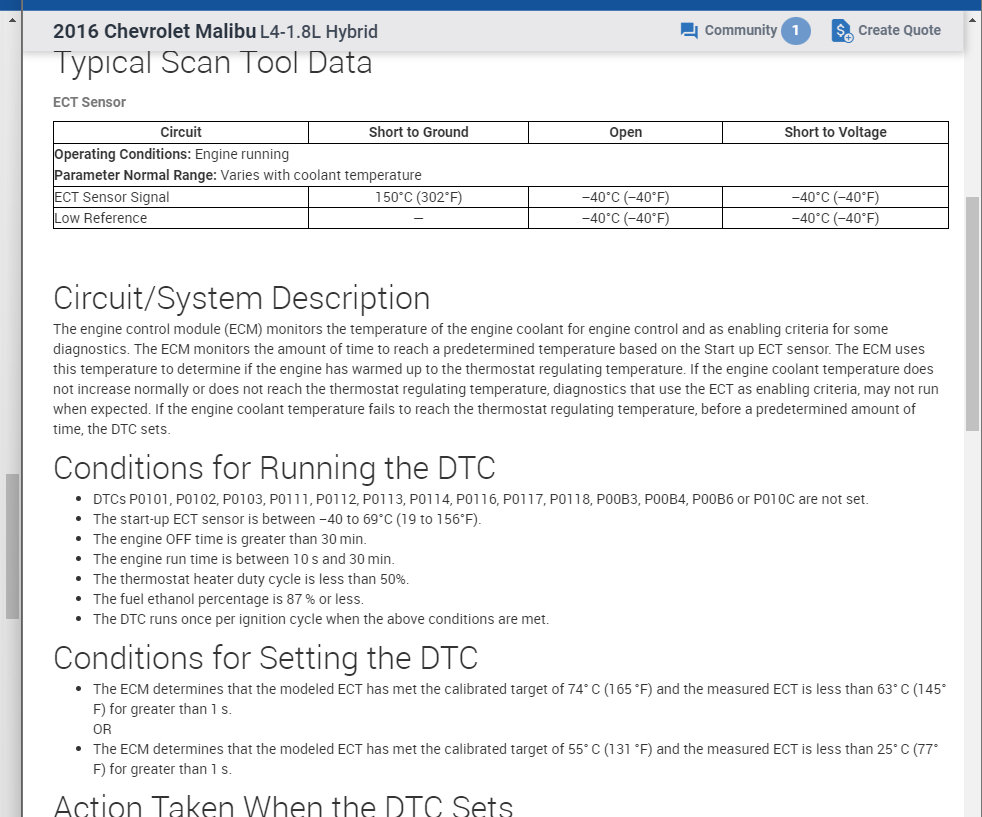

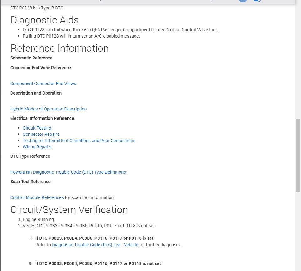

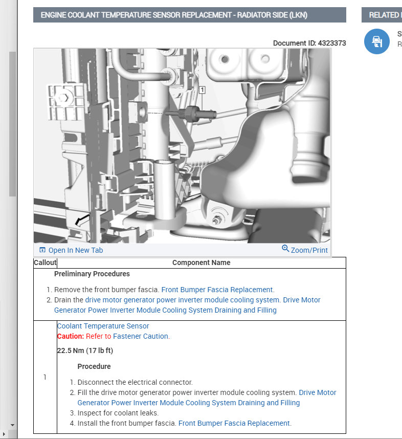

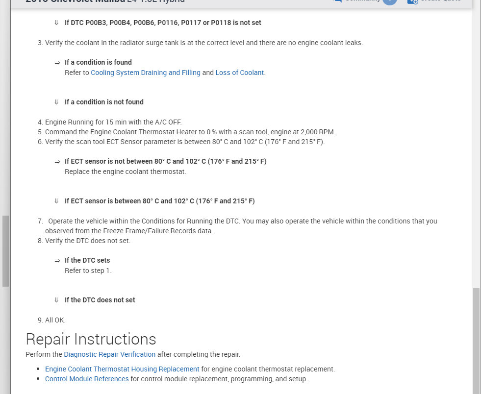

Hybrid gen 9 (car listed above) never gets to hybrid mode. The engine and radiator fan run constantly. On the info system, there is no indication of coolant temperature, but analog temperature gauge works fine.
Where is the temperature sensor?
How do I test it?
How do I test the wiring?
How do I test it?
