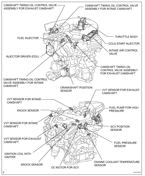

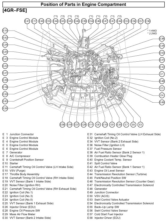

Where is the coolant temperature sensor location?
Dec 4, 2017 at 12:34 AM
HARRY P
  • 2,292 POSTS
Here are a couple of diagrams I found. They are not the best diagrams ever, but if you look at them long enough they start to make some sense. Let us know if you need anything else.
