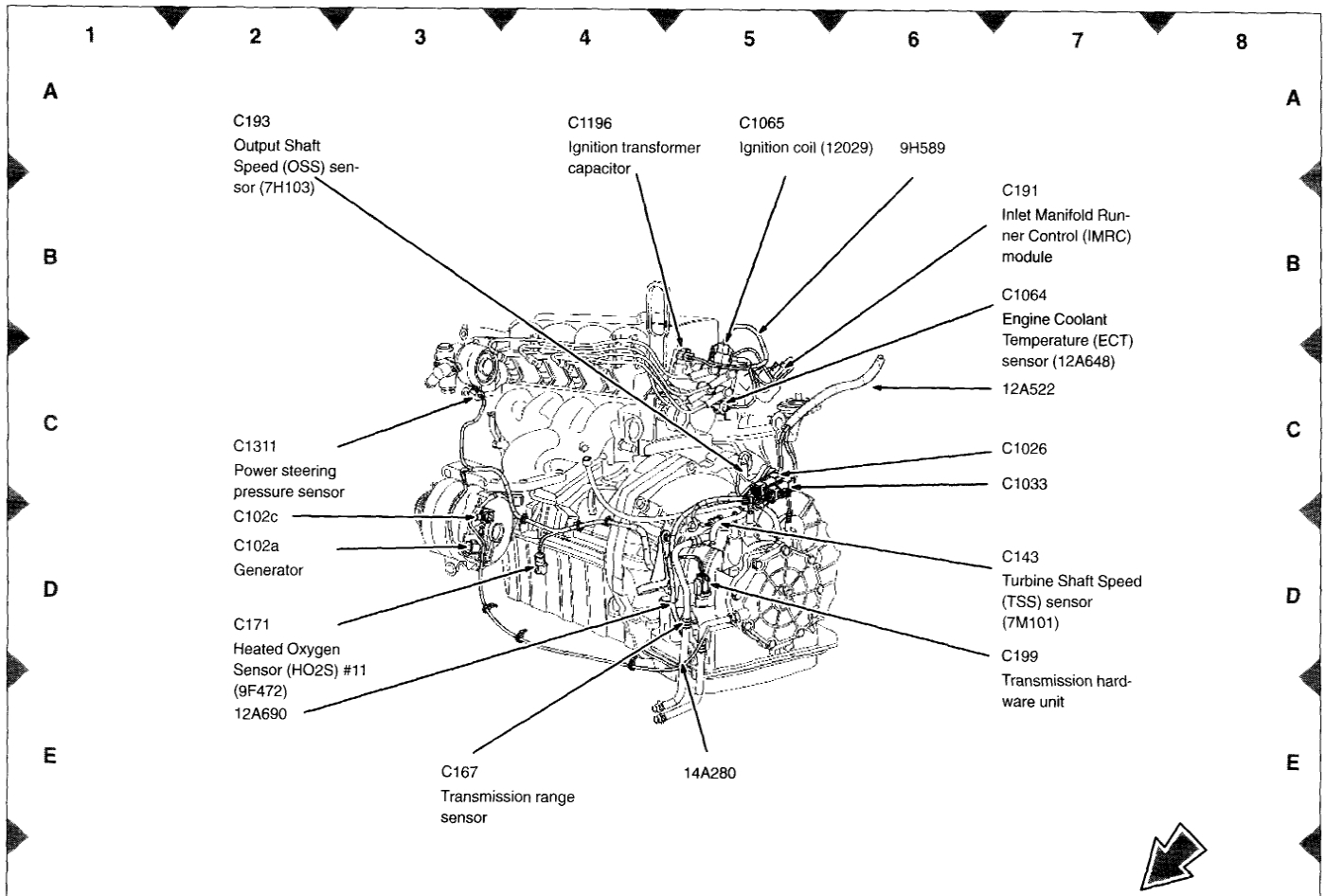

Hello, I have the MK2 model. I have an overheating problem. The cooling fan does not always start which leads to overheating.
I was told to check the coolant temperature sensor first. Please help me locate it and/or advice me furhter.
Dec 25, 2017 at 4:01 AM

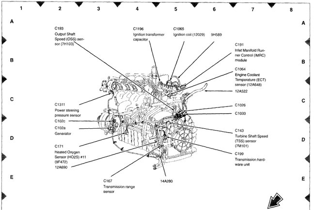

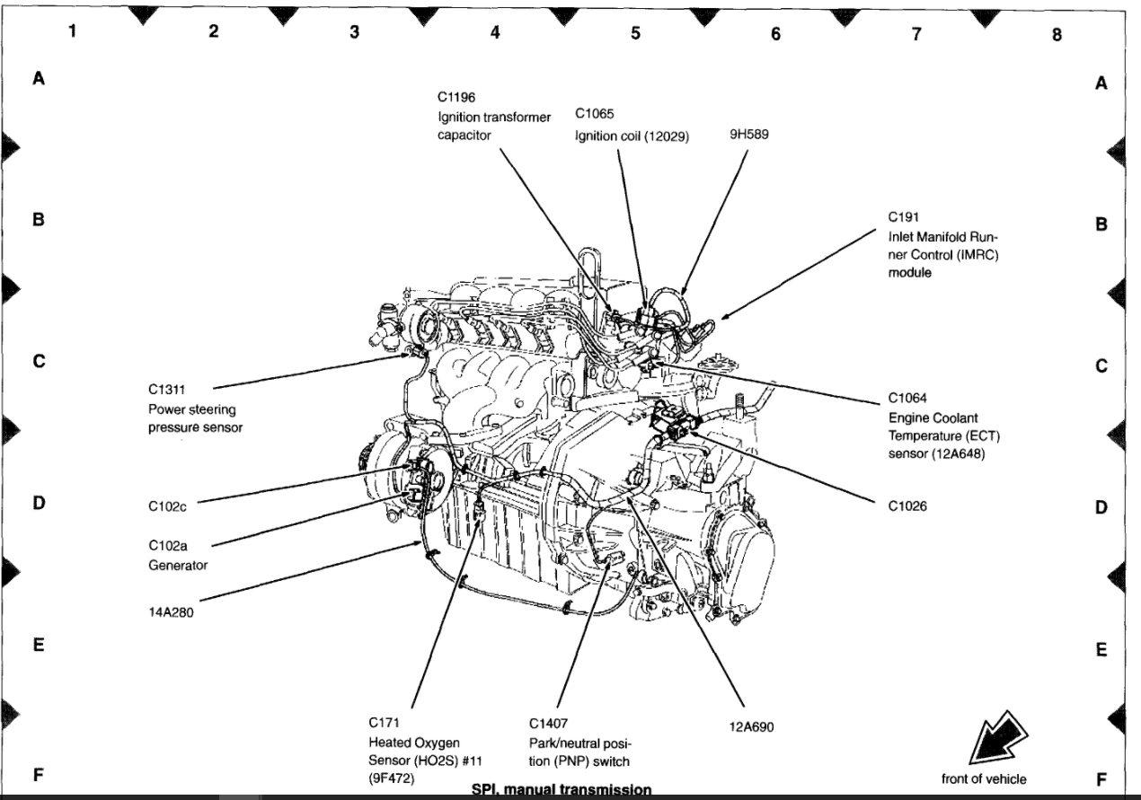

the engine coolant temperature sensor is located toward the rear of the engine, Here is a guide to help you see what you are in for when doing the job.
https://www.2carpros.com/articles/coolant-temperature-sensor-cts-replacement
Here is the location for your car. Check out the diagrams (Below)
